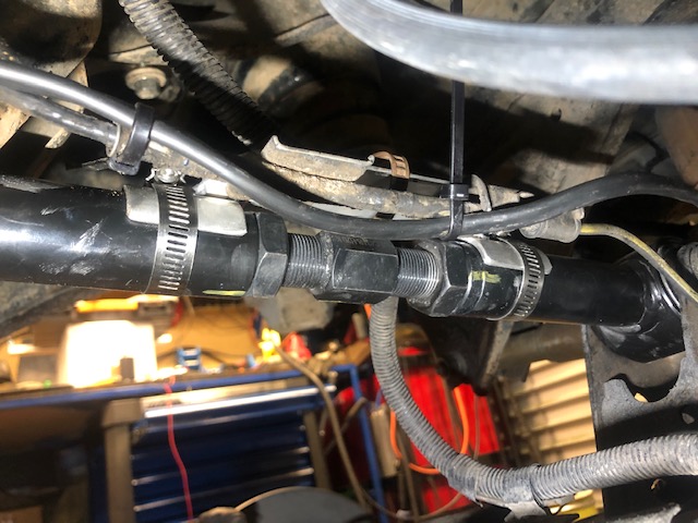

I was hoping it was going to be a straight forward job but didn’t realise the stock upper arms had the brackets for the locker wiring…
Had to make this bracket which was easy enough
