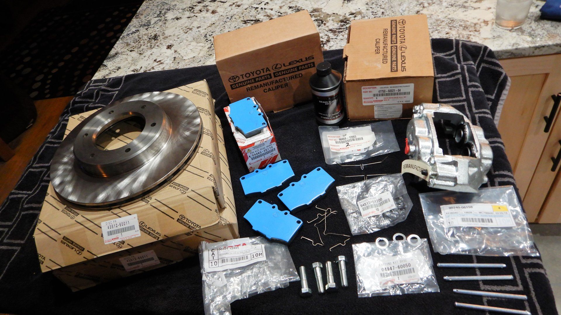

Why not go OEM? I replaced the front calipers with OEM rebuilt ones. Order them from your local Toyota dealer’s on line website for the best price. As opposed to the “ brick and mortar “ over the counter price. Then pick them up at the dealer instead of paying shipping. The calipers I exchanged ( 60.00 ea core charge ) were 52.00ea
This. I had this romantic idea of rebuilding my original calipers with an OEM seal kit, OEM this n that, etc...to keep it "all original".
F that. Got Toyo remans from dealer with online pricing, looked perfect out of the box, been great for a few years.
