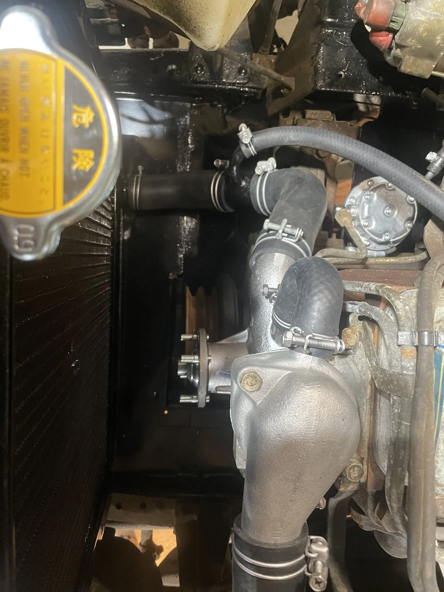

Hi all--I have been fighting coolant leaks on my 1979 FJ40 this past month and am fed up.
Worm gear clamps back off, crack and rust(!?), what are you all using instead? OE style? Non-worm band clamps?
Interested in opinions, I don't care if it's OE or not, looking for good value for my dollar and long-term reliability. Sources for parts appreciated, if someone is selling kits that would be of potential interest too.

Prep work is as important as the clamps themselves. If you're fighting leaks, be sure that your mating surfaces are nice and round, and not overly pitted or rusted. You might need to replace a thermostat housing or heater coupling if that's the case. Hoses should be in new or nearly-new shape. OEM hoses are significantly thicker than common Gates/Napa aftermarket. The extra thickness is really good at forming to any irregularities in the mating surfaces. I also am a big fan of Sil Glyde as it helps to make a durable seal but is non-drying. Some folks have good results from a drying-type glue like Indian Head, but my personal preference is Sil Glyde. I'm running all City Racer clamps presently. They are really good and I've never had a joint leak when a City Racer clamp is on. They seem to work best with thicker OEM hoses. I was afraid that the stainless threads would gall easily, but after 5 years of daily driving on them, they have held up really well. On the flip side, for an inexpensive solution, I've honestly had decent service life and longevity over the years from the stainless Napa hose clamps. Folks like to poo poo them, but i've never had one catastrophically fail or even break. They are not OEM, and they don't look awesome in your engine bay, but they are a lot better than being stranded with leaking coolant and are super easy to have in your tool bag.

I like the look of the OEM 2 wire clamp. They just look right under the hood. @GA Architect did a great job of researching and posting stainless constant tension alternative. I followed his lead: and went with ½" Solid Band Scandvik SS Hose Clamps (www.fisheriessupply.com)(# 382003, 382005, 382001, and 382009 (I ordered 8 size 10's, 4 size 20's, 4 size 24 and 10 size 28's
▸ Size 10; 3/4" - 1-1/8" (x8)
▸ Size 20; 1-1/4" - 1-3/4" (x4)
▸ Size 24; 1-1/2" - 2" (x4)
▸ Size 28; 1-1/4" - 2-1/4" (x10)
