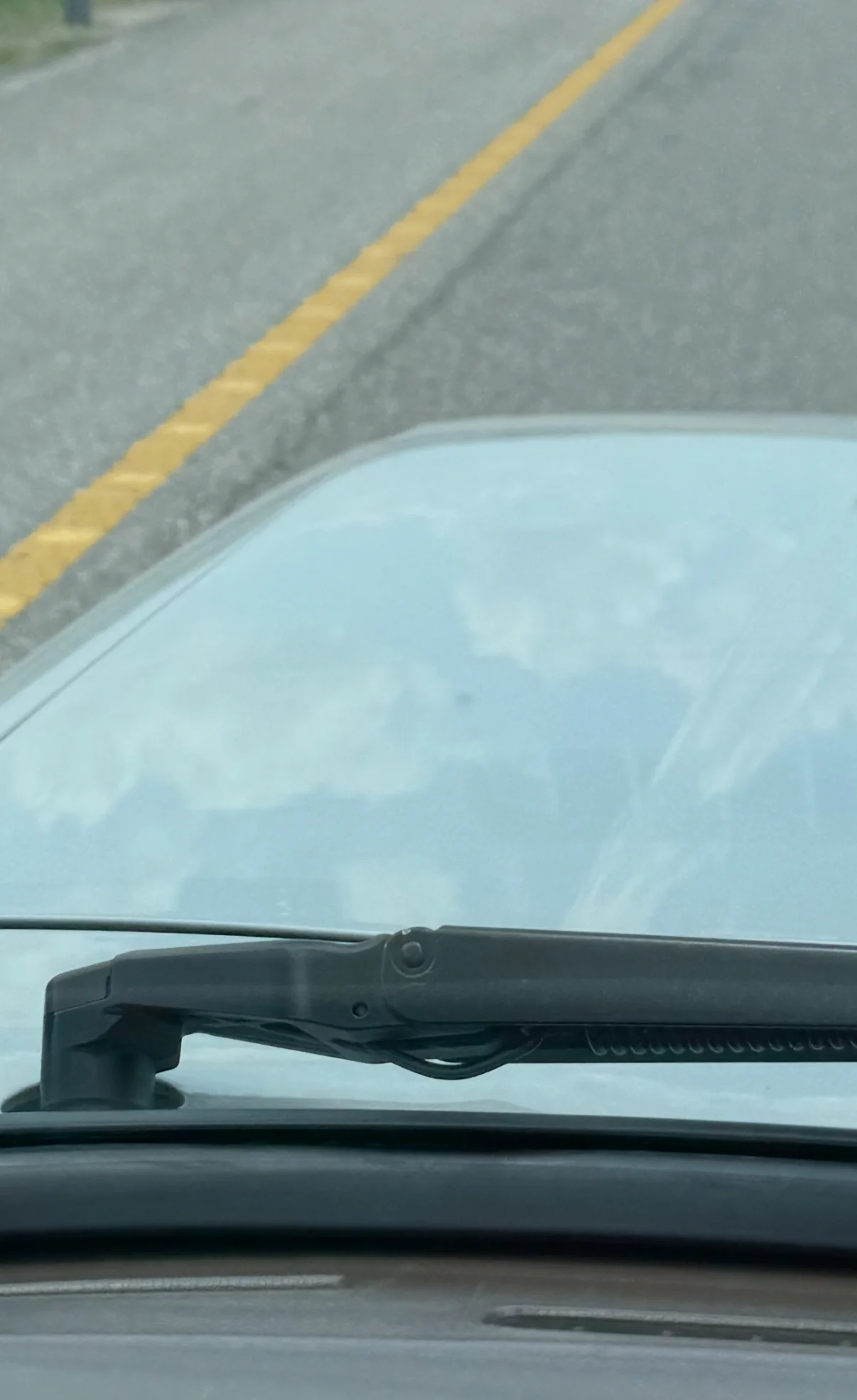

I’m getting about 1/4” to 1/2” rise in my hood as I drive. The hood is securely closed but I’ve never had this any any other vehicles. Is this just an old FJ80 thing or is it possible when they reassembled after paint they didn’t set it correctly. The gaps are prefect when parked.
Best pic I could get while driving:

I finally got home at a decent hour tonight. Several things I’ve noticed.
1. We know the front end had previous body work when I had it painted. And the hood did come off. There is a slight bow in the hood about a foot from the leading edge when parked. This is what I see as I drive.
2. Had a coworker pull along side me as we drove to a project. Front of hood is low and secure. No movement
3. My rubber bumpers are toast. I’ve ordered a new pair just to have a little more rubber making contact.
4. I don’t believe I’m having any actual movement. Depending on my seat position the bow in the hood is more pronounced based on my line of sight
