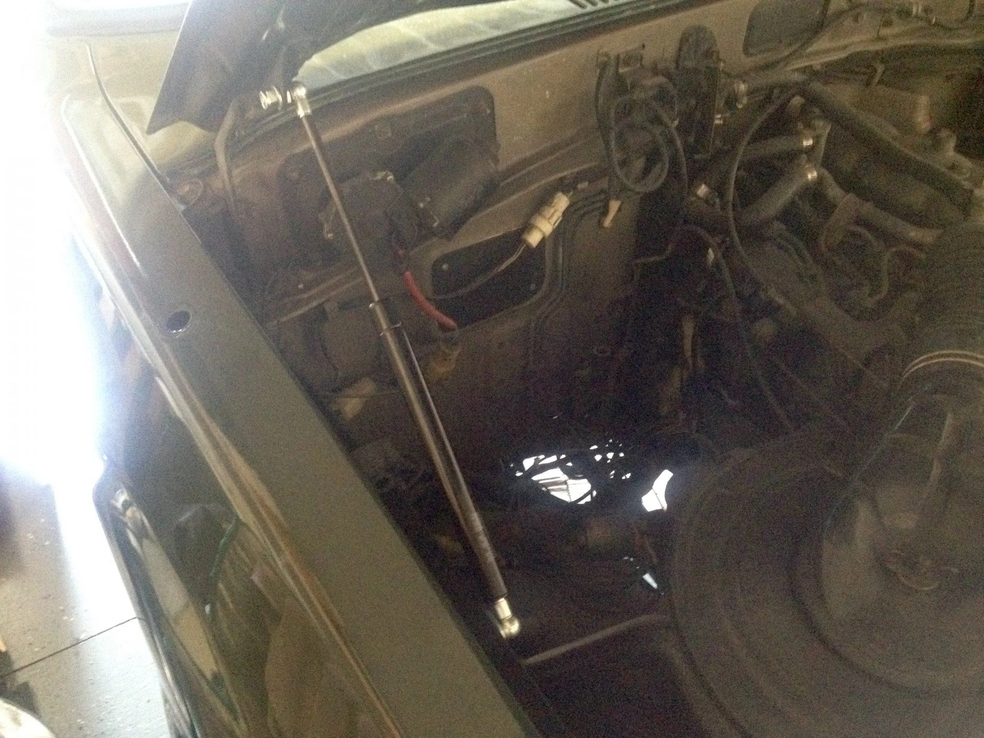

Has anyone upgraded their hood springs for a support similarly on the 80s series? so its like your rear hatch stays that are now on the hood so when you open the hood it is assisted by the actuator itself. I mean its a lazy thing but after I saw them in my buddies 80 series I wanted to check for my 60. Maybe this has been discussed before but for some reason when I search the forum now it times out before I get results.
I did mine on my 60. It’s a great upgrade. Just followed the directions and materials list from a few threads on here.

I LOVE my hood struts. LOVE THEM. I highly recommend and it doesn't take too much work to get them in.

Probably doesn't deserve them but it certainly is a cool option to add the cruiser. Plus I like to spoil mine a bit. :rofl:

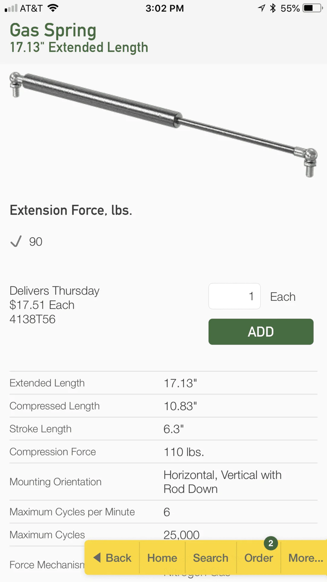

I did it almost 10 years ago so I have no idea. Trail Tailor posted this in another thread:
Tundra/Sequoia shocks (53440-0C012) 55-60$ each ball stud ends 1.80 each (M8 x 1.25mm IIRC)
This thread has McMaster P/N's which is where I may have ordered them.
Hood/tailgate strut replacement FJ62
For video of how to install see this youtube video from a couple of years back. (warning has ad for product from vendor) Struts below if you want to roll your own but for visual folks this is a decent install video.
link to struts alone - no drill or tap for those who already have such. Found on page 6 of the FAQ link above.

After 10 years mine need replacement...i used the 120lbs from McMC...
