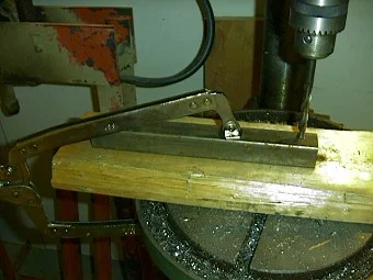

This is how I made the tabs to attach the Toyota squeaker's to the radiator cradle-will come in handy for the duffasses that might cross the Cruiser's path. Kind've primative, but one way to skin the cat.

I did not cut the part to the finished size until final cutting step, because it is easier to clamp with the longer material.

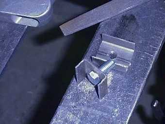

Here are the finished goods:
