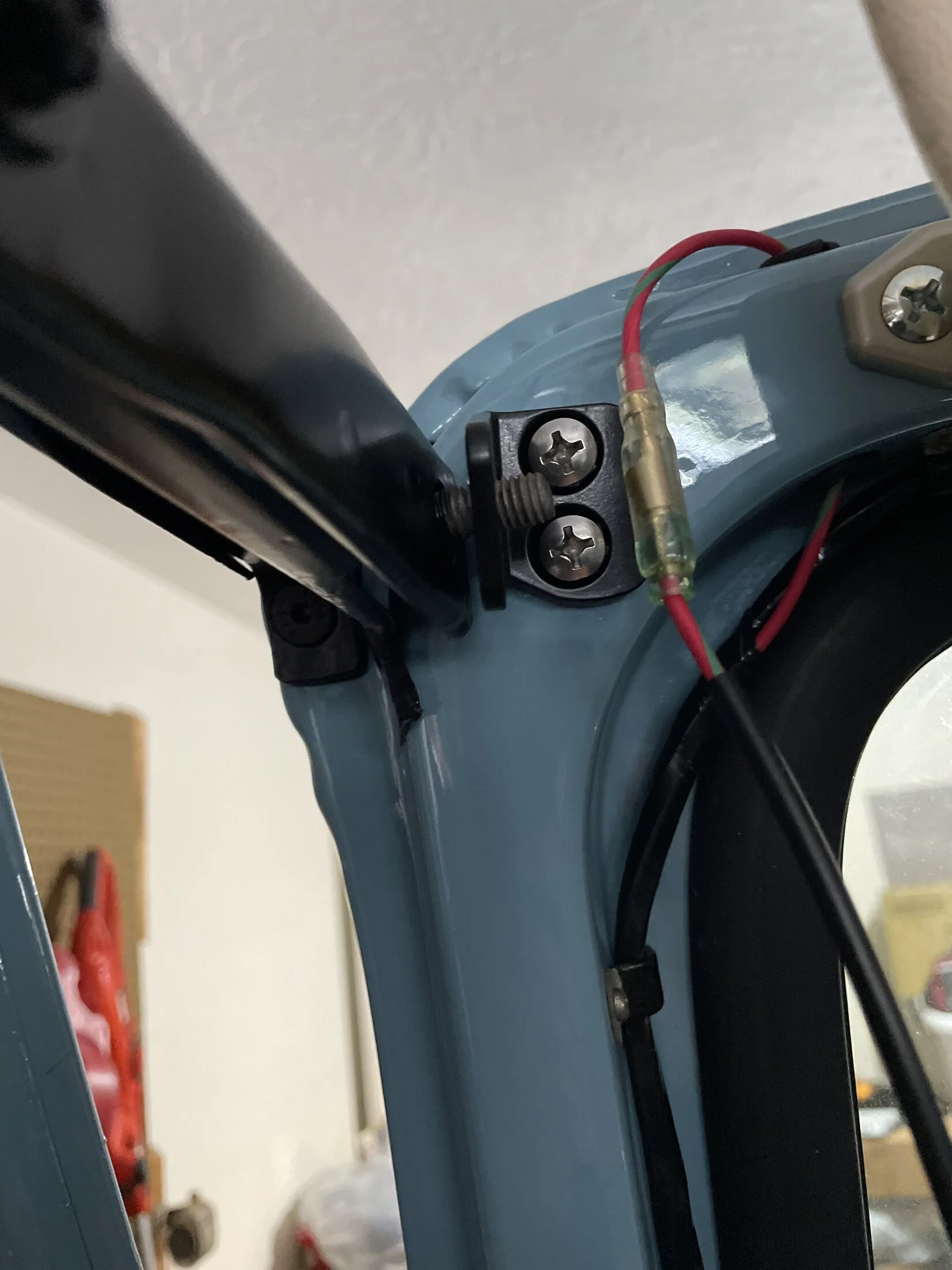

I’m working on my soft top front door header and noticed that there is a decent size gap between the header and the corner windshield L bracket. Is that typical? Also does anyone have the part number for the screws that hold the L bracket to the windshield? I need two more for my passenger side. The hanks

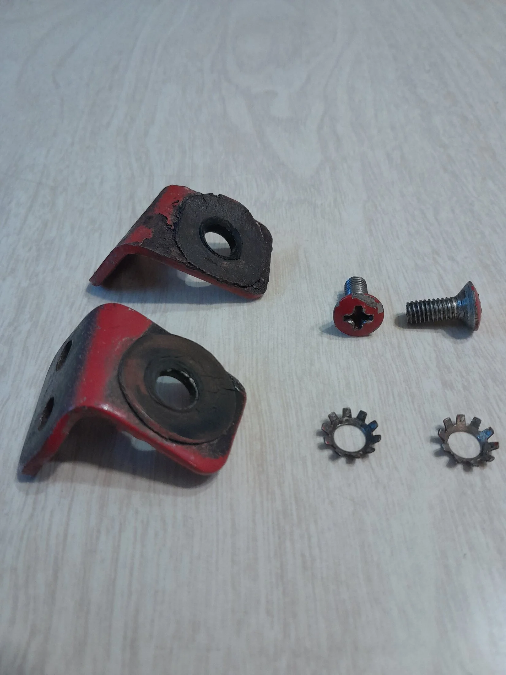

Screw one out and go to Home Despot, they have a metric screw checker and a good assortment of screws, even counter sunk ones. The striker plate on my 76 ambi lost a screw, took the other one to HD and got the correct screw pair in stainless steel (did have to trim the length like 1/4" for like $2. They didn't have the cone star lock washer, but I "made one from a flat star" and used some lock tight too when installing the new stainless screws and threw the old one in my metric bolt bin.

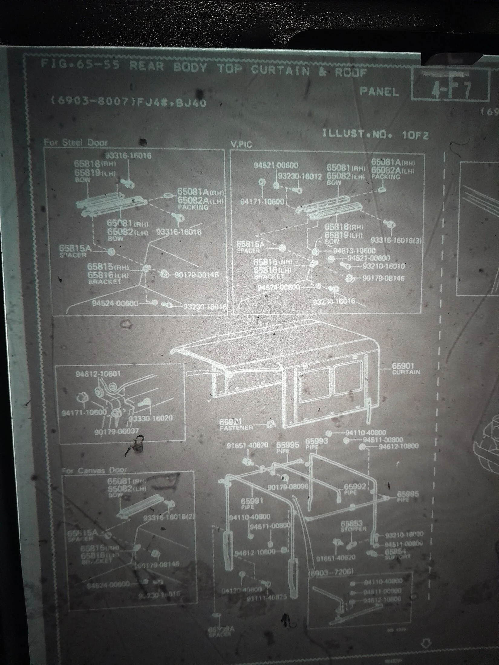

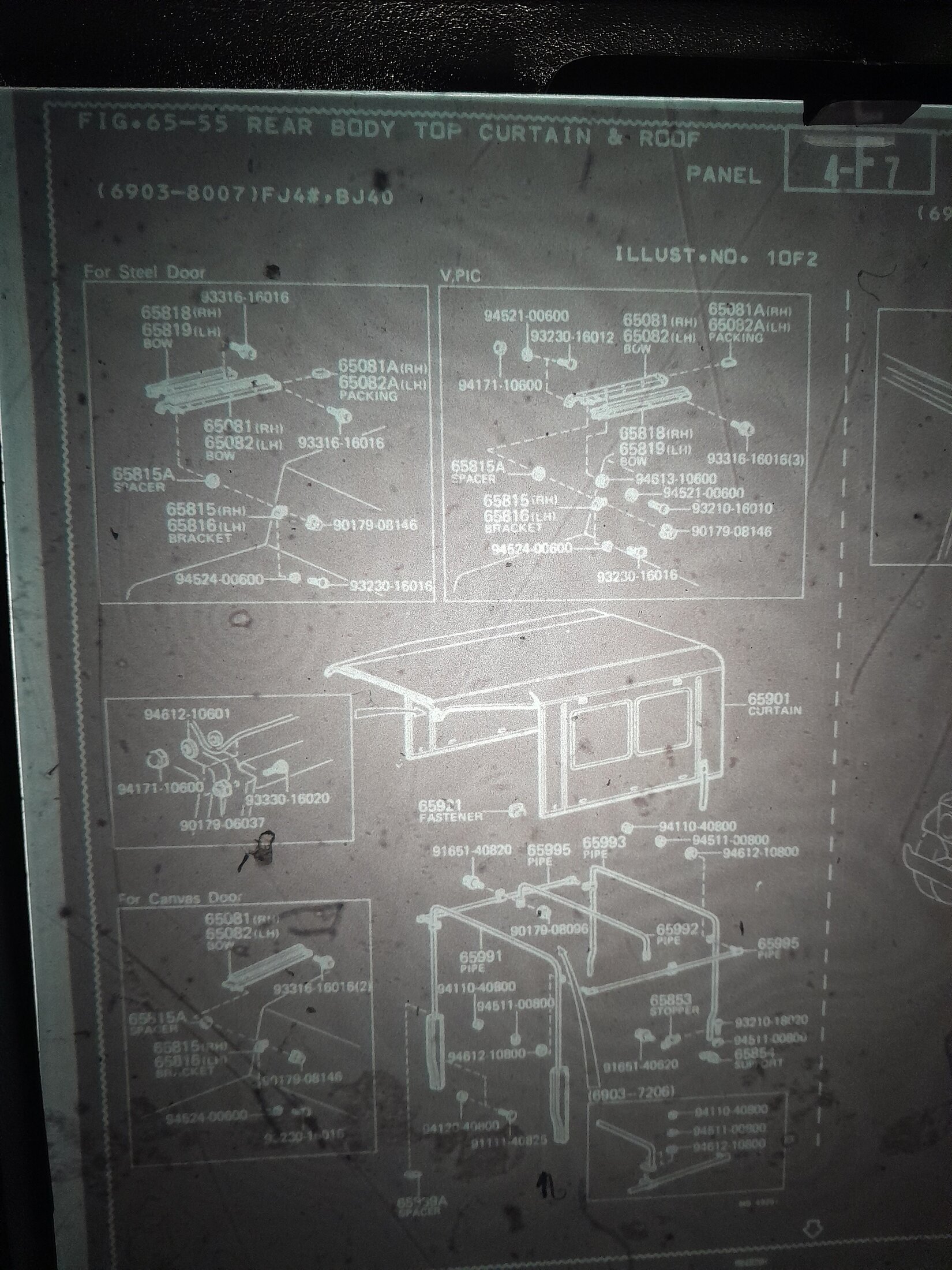

Concerning the gap, my microfiche shows a spacer, identified as 65815a, in that area. My personal original appears to be what once was a thick rubber washer. The screw part number is 93230-16016. The cone star washer p/n is 94524-00600.

Spacer 65815a is 90560-09025 that goes in that space. But as I remember it is just a piece of rubber and not as thick as the gap shown. I see see four different soft top headers used depending on style of door (steel or canvas) and date. Are this all original parts that went together or OEM you making a soft top?

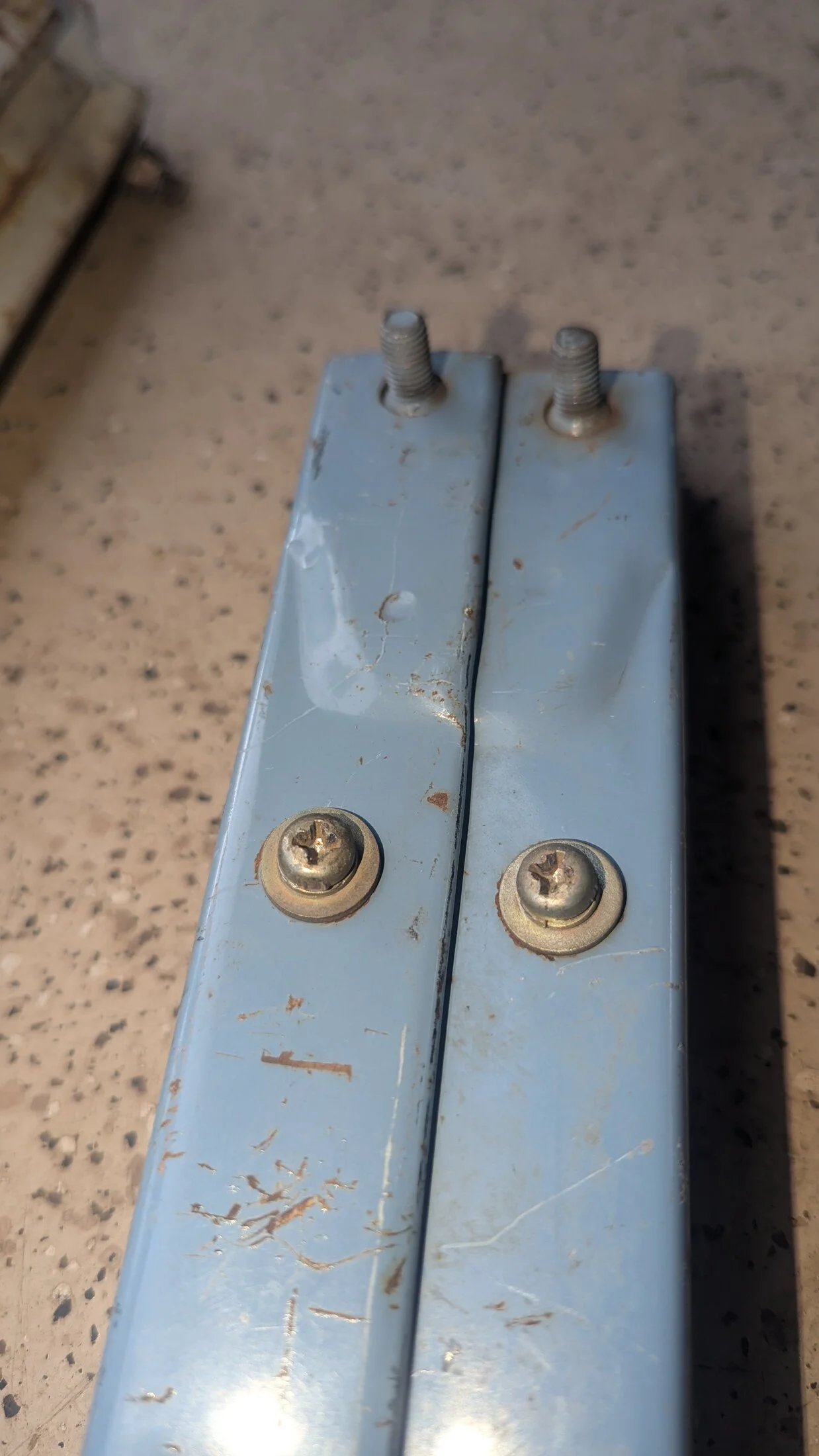

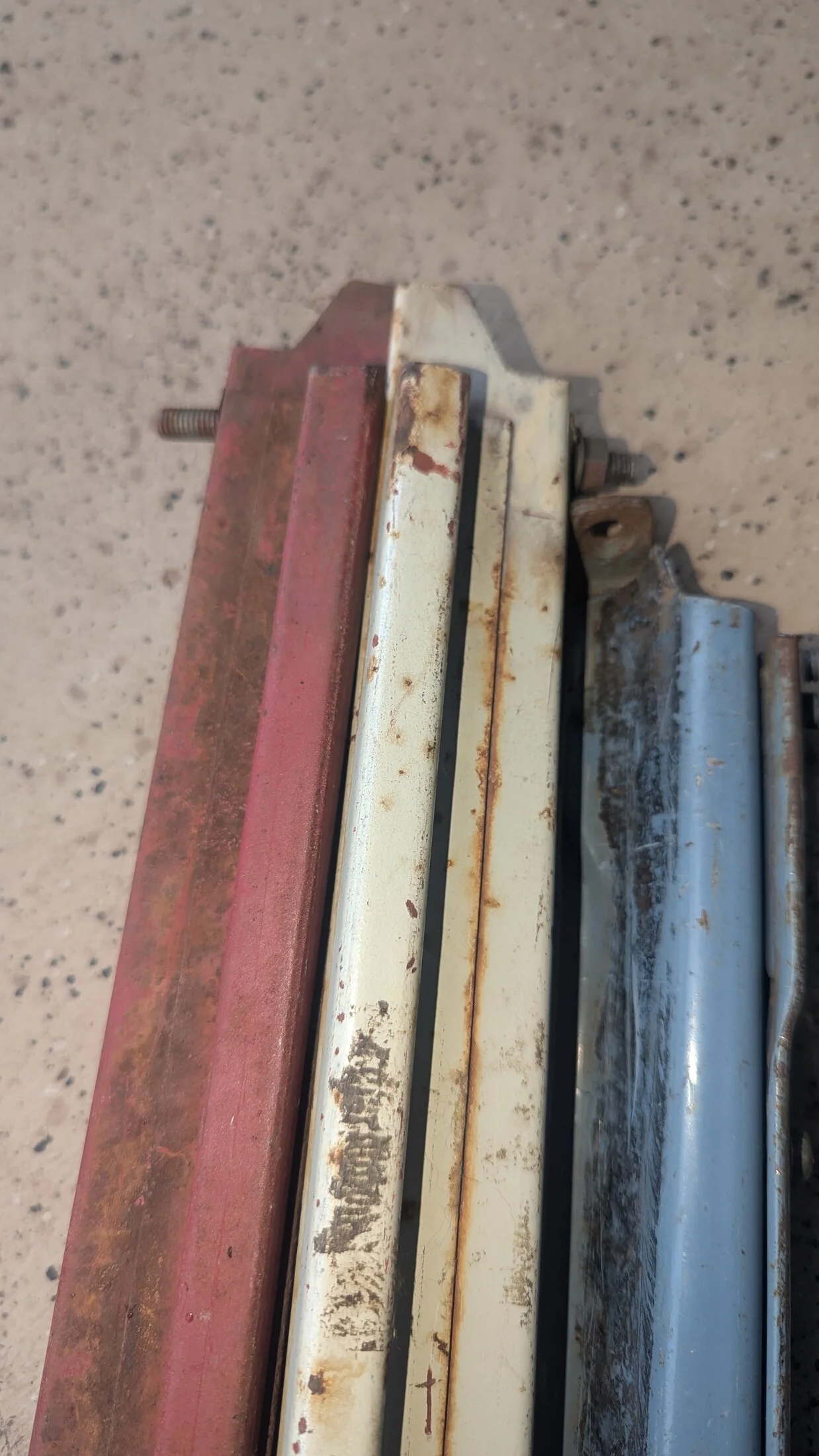

They are originally parts that I bought off here and originally was from over seas to accommodate hard doors. The L bracket I already had but not sure if they are OEM are not. Thanks for your expertise.
Blue set is off a 68 hard top which would match the angle of soft top with steel doors. The red FST header was told came off a 67. The windshield channel with early design would confirm that. The white header came of a 69 FST. US FST models. Red top could have purchased to doors but didn't. 69 I bought the complete top including the soft doors.
