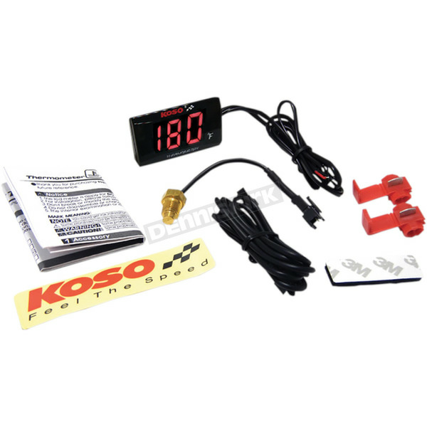

Why not get an el cheapo ebay 12v temp gauge and plug it into the thermostat housing to take out guess work and rest assure it is the correct temp? Even could get a good led digital gauge, run fresh wires and make it permanent.
I installed two extra oil pressure gauges, electric in dash and mechanical in engine bay, very exact match. Nice, constant and reassuring feeling.
