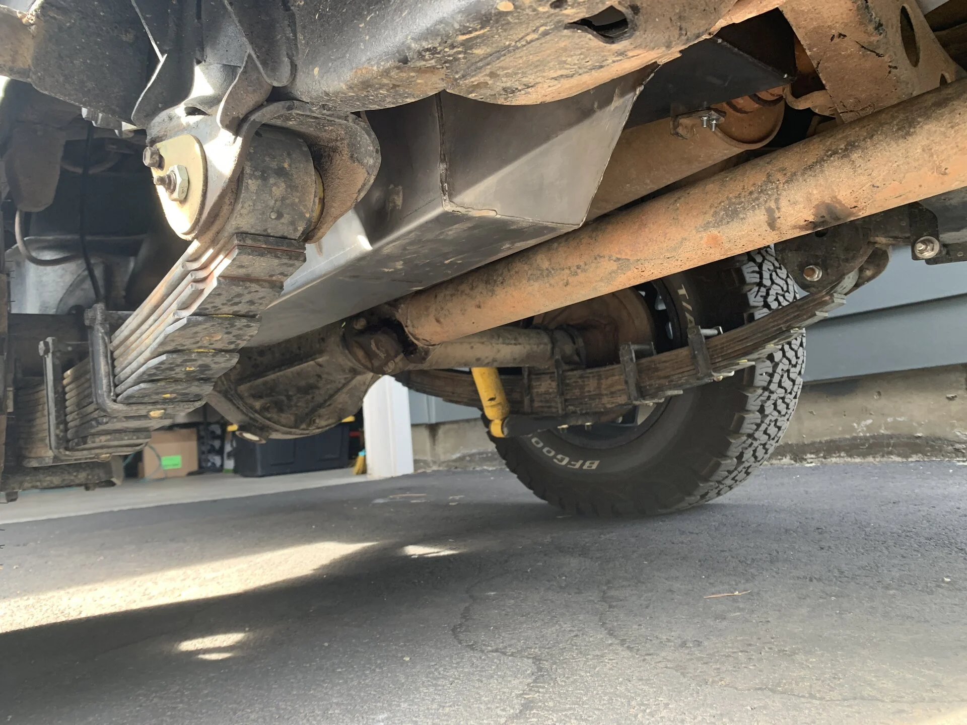

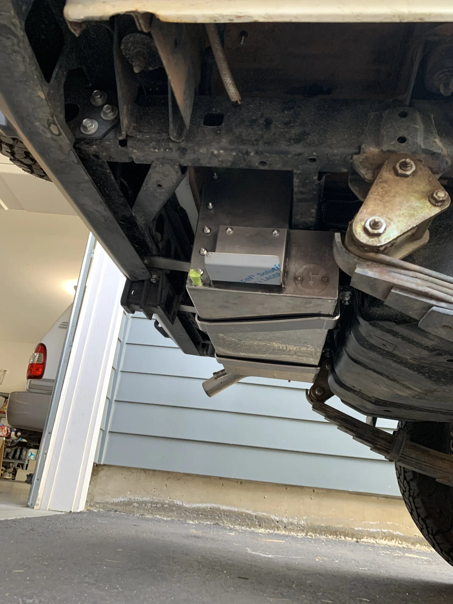

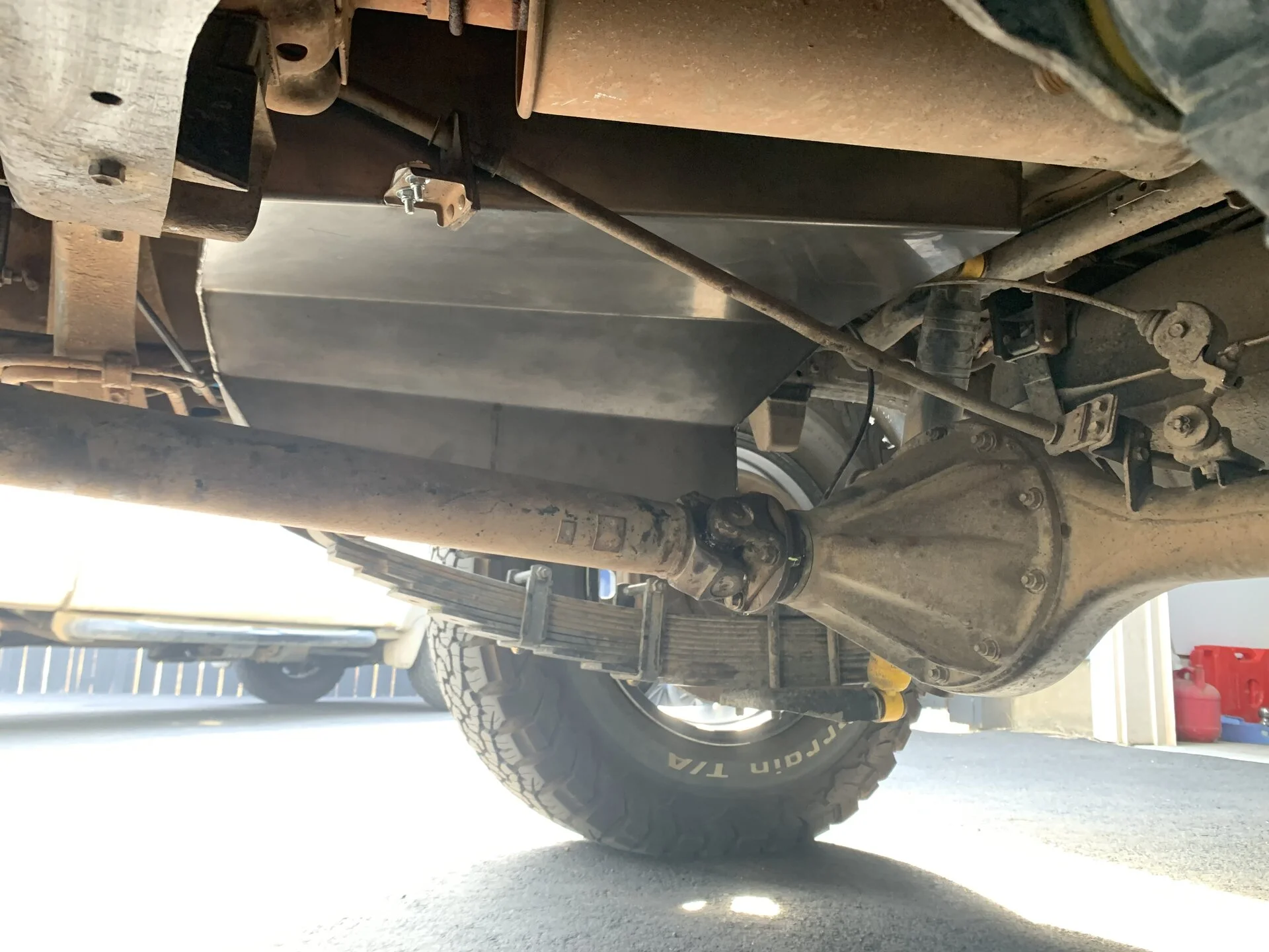

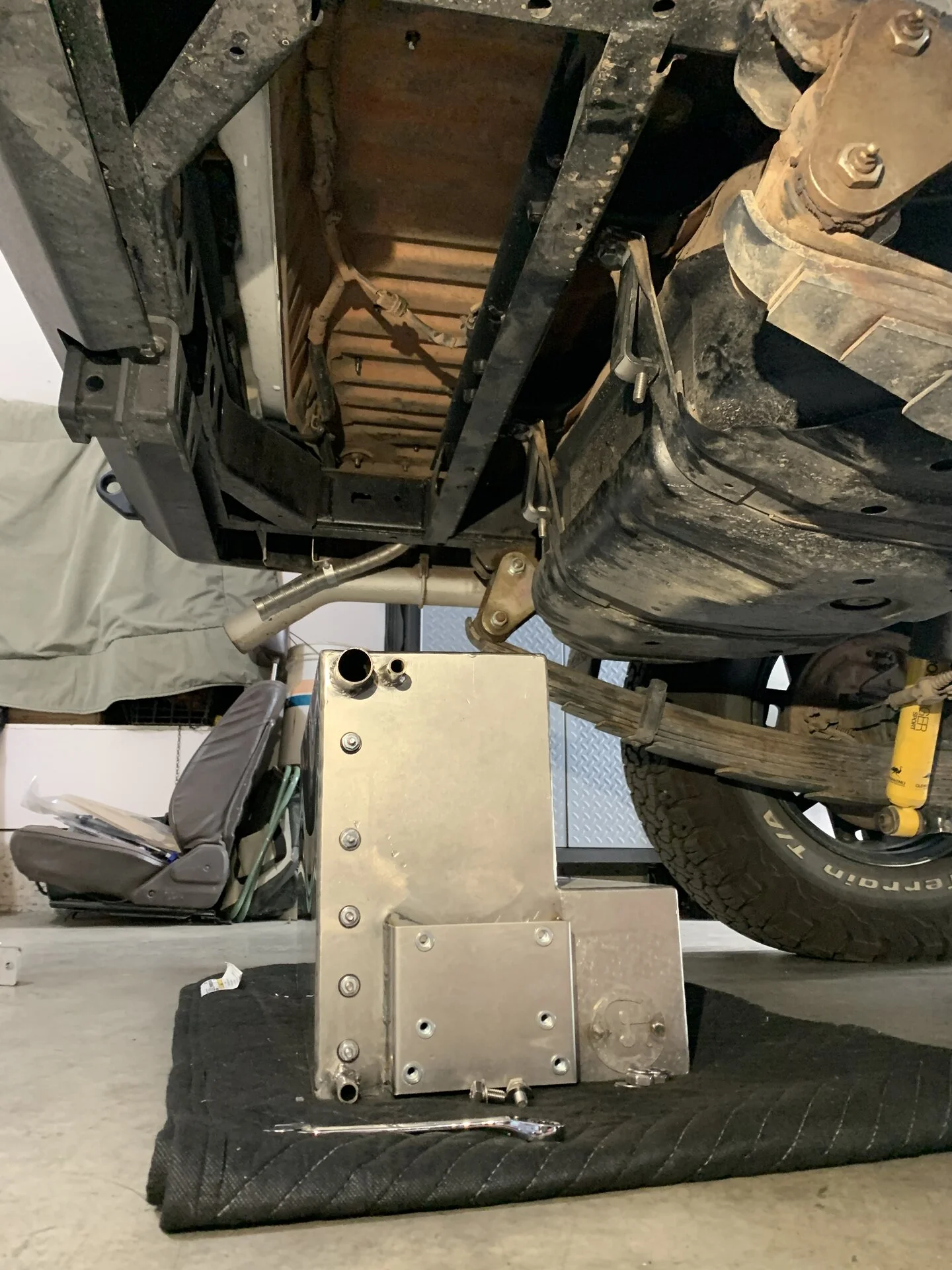

I bought that same tank direct from Long Ranger a couple years ago . They were hard to come by then, but I was able to snag one. It does bolt direct to the stiffener rails on the underside of the body and no need to re-route brake cables or (stock) exhaust.
I also have a Thornburns 40.5 liter tank behind the rear fuel tank. Liam at Thornburns is great to work with too. 40.5L Troopcarrier Water Tank - Thorburns - https://thorburns.com.au/product/40-5l-troopcarrier-water-tank/.
If only one is needed, probably better to go with the Long Ranger and get weight forward of the rear axel.

Hey man! Thanks for this info! I'll probably hold off as it requires that I remove my buildout to attach the LR tank...
