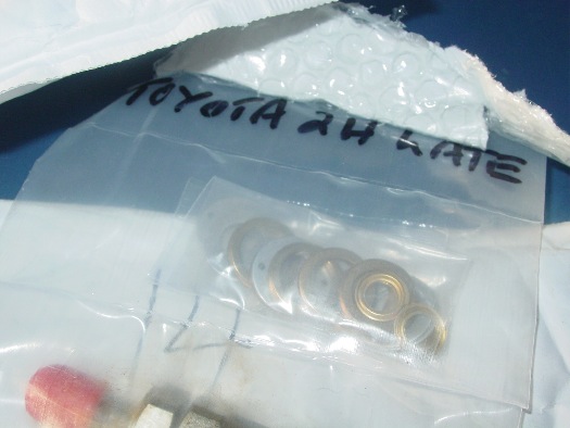

then i got my new set of re-built injectors (from KrazyCritters on
EBay Oz) out and put them in. Here are the steps involved:

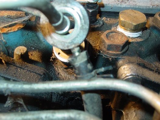

i only loosened the nuts at the injector end, as the nuts on the pump end seems frozen to the injector pipes and i didn't want to find out the hard way, if you know what i mean.
After the pipes were out of the way sufficiently, i used a pair of wrenches to remove the nuts which hold the distribution pipe. another piece of pipe which i knew to be costly to replace if damaged, so I handled it most gingerly.
then it was time to pull the injector body. These are a 26mm size if I'm not mistaken. I used the closest thing i had on hand, a 1-1/16" spanner.
three more. out with the old injector and two sealing washers (the lower of the two must be put in with the correct orientation up-down), and in with the new.
and then they were all in
and finishing up by putting the lines back on, with the nuts left a bit loose for now. The system need to be bled before start-up.
