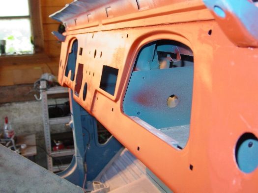

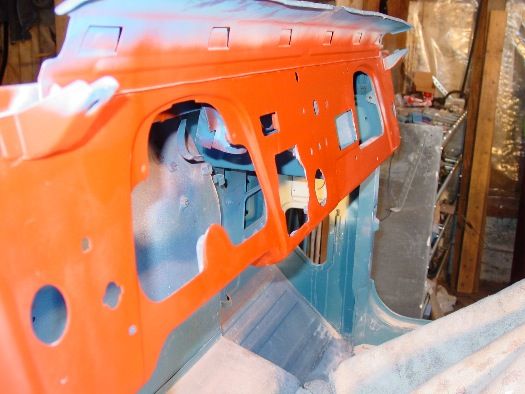

I got in about 5 rounds of sand-prime-fill on the two sections, and I was spent. It's tiring work, especially when using the sanding board in a vertical orientation, and with the heat today, I took frequent short breaks to hydrate.
I think they will be pretty close to done by the end of tomorrow's work. Tomorrow is also the start of the final primer and paint process :bounce::bounce2:

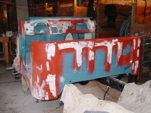

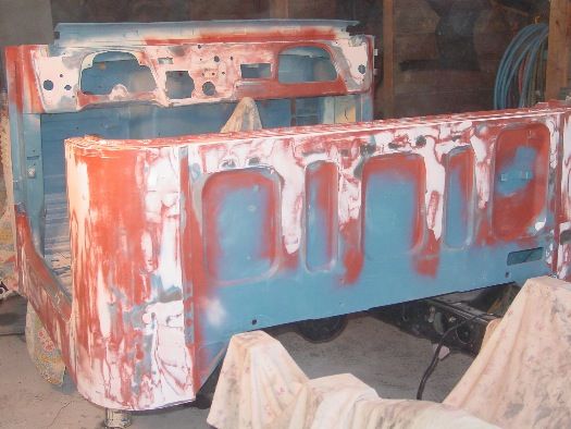

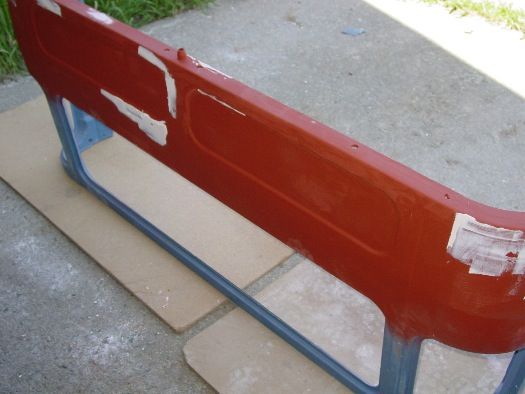

A final set of three for today.
That is rattle can spray-on high build primer filler Rob, not spot putty. Do you think I'm totally nuts? (wait, don't answer that:D)
The Dupli-Color primer filler is the same color as many brands of spot putty out there, so perhaps that is what threw you off. If you look in the first picture on my last post above, you can see one of the rattle cans laying on the floor with it's reddish brown cap) Laying that much spot putty down would be demented, not to mention tedious and wasteful. I got enough of that going on in other areas....
I throw down a coat of the primer filler (that reddish brown stuff, yes, is sprayed on) as I get the panel close to done (around the 80% mark I guess), and that helps me spot irregularities and fill some of the sanding scratches in. I only spray it on the areas i am working on, hence the patchwork appearance. Then i put on some more Wurth polyester filler (the white stuff), sand down and repeat. It works well for me so far.

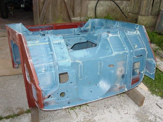

One of the things about the body work i scratch my head over: I sand off about half of the filler, primer, etc, that I have applied as I move along, layer by layer. I guess real pros at it (and there is one in the same building complex where i keep the truck) don't waste so much, but still a lot of dust falls to the floor as things get sanded down. Mind you, the fellow I mention, who is also painting my truck, told me he used 23 cans of Wurth on his Datsun 260Z, a 2 year project on the body alone. I'm way off that, though I did have to go and buy a final can of Wurth today (12 cans all together I think). I greatly appreciate, in light of the curvaceous nature of the 260Z and many other vehicles out there similar in form, just how much straight sheet metal there is on a 40 series LandCruiser. My job is a lot easier than on other vehicles.
I've pretty much ruled out Bodyman as a career option, though i am interested in acquiring the skills of shrinking and stretching metal with heat. It won't be on this project though - no time.
It's hard to tell from the photos I suppose, which I'm sure convey the impression that i am just coating the truck with slabs of filler, how the surface really looks. In 90% of the places, the filler is 1/16" thick or less - just the odd spot where it goes deeper. The worst spots are the middle of the doors, the hood, and the middle of the lower cab lip.
I am leaving the vast majority of the spot weld dimples, though my painter friend seems to have trouble accepting that I am doing that (he frowns when I tell him i want to leave the dimples as they are). He keeps reminding me to fill them in - it doesn't compute for him that i would do all this work and leave those dimples. I'm holding tough.
