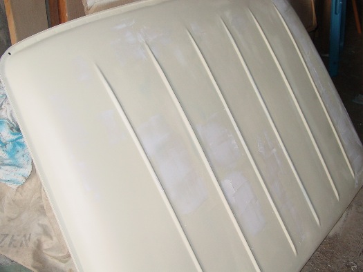

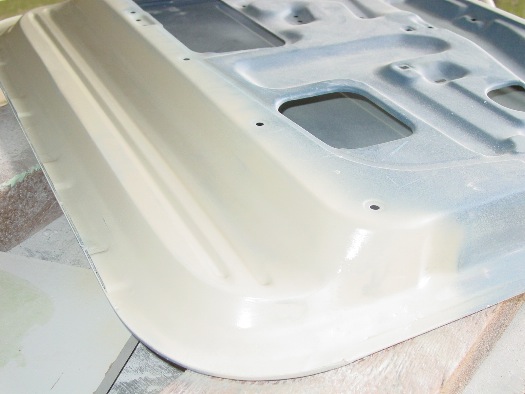

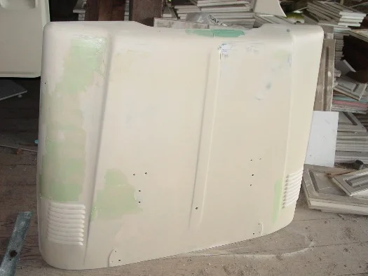

I've been plugging away at the body panels and they're getting really close now. One you get a complete coat of primer-surfacer on there, the flaws just leap out at ya, so the subsequent finishing stages seems to get longer and longer. I'm doing my best this week to wrap them up so I can move onto the main tub and upper cab piece. Here are some picture from the past few days:
