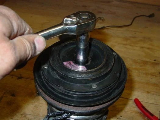

The bearing was in good shape, so I cleaned it up and re-assembled.

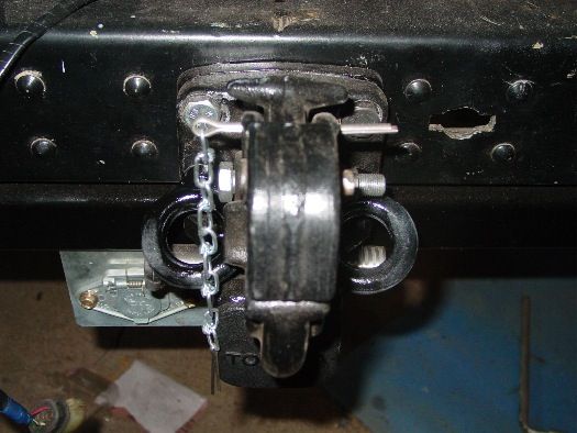

here's the completed install of the rear hitch. The forged Toyota chain loop receivers didn't have a long enough threaded stud to work with my hitch, after I had put the 0.375" plate in behind the pintle. So I took the parts to a machine shop, and had them chop off the threaded studs and weld on a 50 mm long grade 10.9 bolt. after welding they ground the weld flush with the base of the ring, and I paid $100.
After getting the fresh paint marred by my thumb prints, i gave the parts a quick re-spray after these photos were snapped.

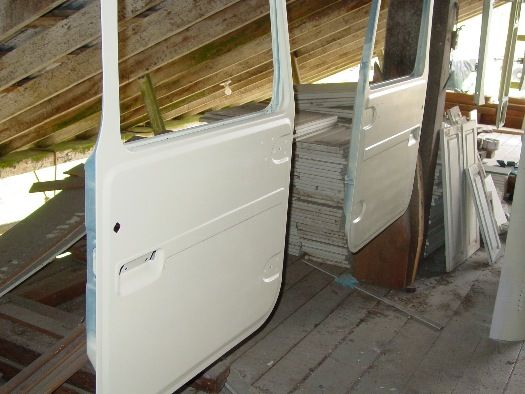

last one. The big panels (door, hood and roof) are all in that final few % of fine-tuning, while the rest of the bits and pieces are better than that.
