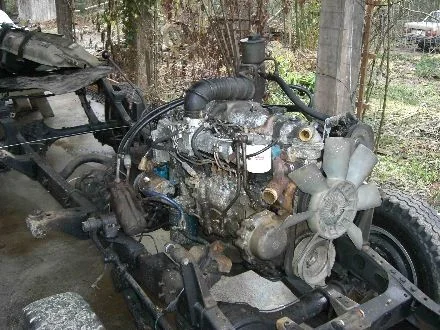

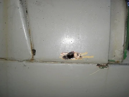

I was hoping to tidy it up and get it through inspection and on the road again, but after driving it around the backroads here a short bit, and taking a close look at the situation, I decided to tear it down and fix it right. I'm not going for the last-detail, concours sort of resto, i want to have the truck working right, solid, reliable, and without rot.

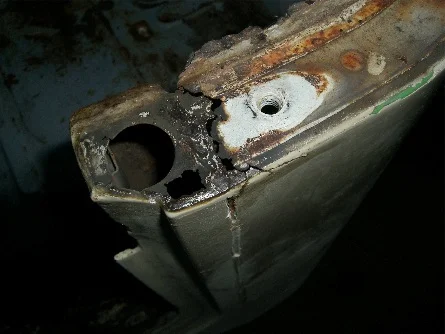

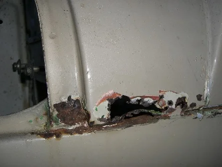

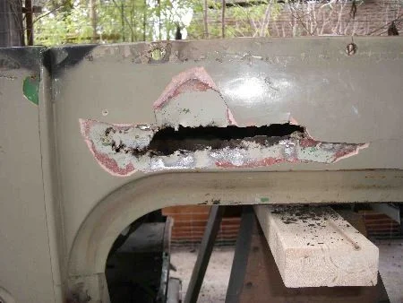

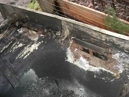

Though the seller claimed "no beach, no bondo" when I queried him about the body condition and where the truck had been, it wasn't the case upon closer inspection:ban:

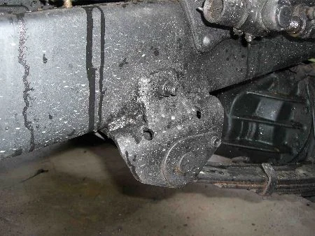

This is the underside of the floor pan and sill area:

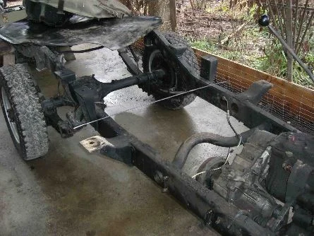

more chassis pics, etc

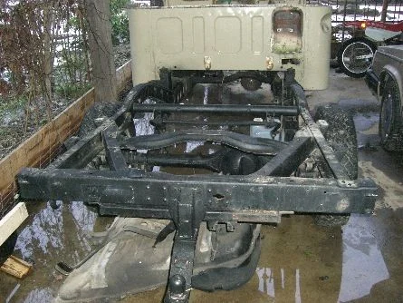

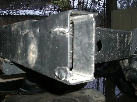

Another couple of view of the chassis, and the front right spring rear perch, which has been fiddled around with. The ties rod has a smallbend and the bracket arm on that side is really close to the backing plate for the drum. I wonder what really happened?
Taking a truck apart that you have little direct knowledge of does mean for a fair bit of detective work - more on that to come!

On the '82 FJ40 I had the front spring hanger rivets had stretched and the hangers actually wobbled. I had to weld them up like was done in your pic.

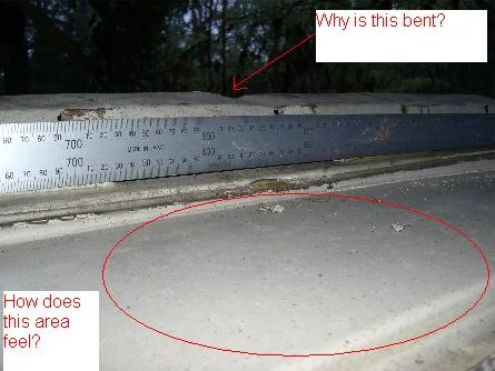

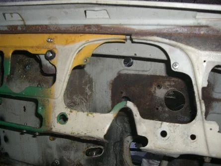

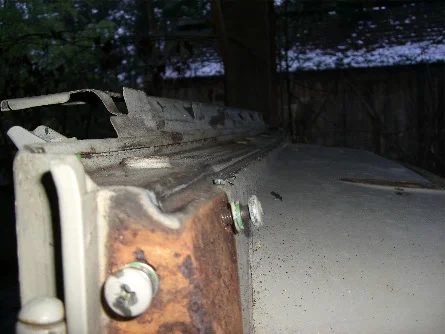

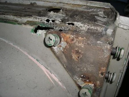

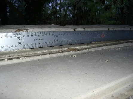

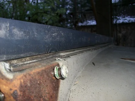

And then there is this 'problem': the ledge on top of the cowl that supports the window frame assembly is bowed in the center nearly 1cm from the reference of the outside corners. I put a ruler on to help show this (pic 3) While the build quality on the later 40 series was apparently worse than earlier models, I'm having trouble believing the factory would do such a bad job - or is this how they are supposed to be?
Why is the dash are bent? Also, if you run your hand across the top of the cowl how does it feel. Straight or bowed in?
Matt

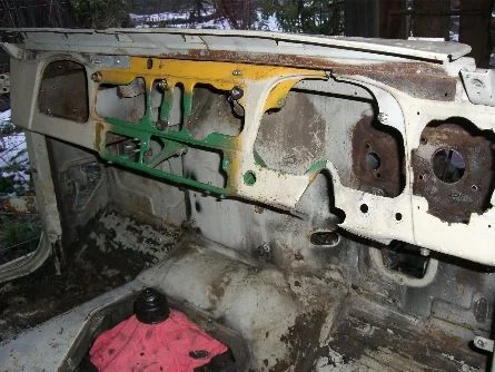

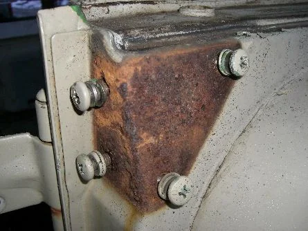

The cab window frame support is bowed and will require major surgery to correct. I see bondo already in the few sections of bubbling in the cowl paintwork. Likewise the lower vent panel attached to the cowl need some attention on both sides. I will find out more if I media blast the cab, of course, and that will cost $$. That repair problem, along with the rust in the LH window hinge support, is giving me pause to consider replacing the front cab entirely and going to a new firewall and LH steering. A major decision, and one with $$$ implications. Re-doing the wiring harness again sounds time-consuming and tedious, not to mention the fact I just finished re-wrapping it. The console panel with the digi-clock and the warning lamp cluster would be backwards. The shifter would be closer I think, and, of course, no hassles at any sort of drive-through situations. Then there's the heater relocation, different ductwork...
Pros and cons, man alive. What to do?
going LHD!
Well, after more thought on the full scope of work needed to the cab, I decided that I would look for a cab firewall that would fit - and be LHD. Fortunately, another 'Mudder on this site, Seapotato, had exactly what I needed. And he gave it to me (thanks!) so it worked well with my current finances! Hopefully I will be able to help him out with something one day.
Got the bulkhead into the back of my Mazda 323 and brought it to the shop. I've aleady drilled out a bunch of spot welds and have removed the vestige of the transmission hump sheetmetal. Yeah, I know, pics would be nice :o Trying to decide exactly where to slice and dice is the next consideration.
Now I need to find the heater ducts to work, and a heater I believe, maybe the blower too, and steering gear (lotsa decisions to consider with that especially, though I will definitely be going with a power steering box. I'm considering using my 60 series steering linkage, as it is beefier and could undoubtedly be modified to fit properly. I would love to keep the current '84 vintage dash, but I would need to find a LHD donor dash from a 1984 - anybody have something like that kicking around their yard?
Then there is the windshield frame issue with the reversed wiper arrangement - maybe I can cut out the lower sheet metal and reverse it 180˚. Has anyone tried that?
