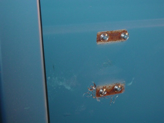

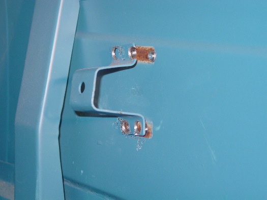

I decided to remove the seat stop from the back of the upper cab. Note the rust behind the piece. This is everywhere that there are seams put together like that, and I've found, from pulling my own spot-welded pieces off, that pre-priming.back-priming the pieces does nothing to affect the rust that forms around the welds.
It might be better to epoxy and rivet rather than spot weld...
Are you going to reinstall that seat stop bracket? I've been thinking about removing mine just like you did. All of my seats have been raised up about 2 inches with spacers so I don't think that the seat would touch that bracket anymore anyway.

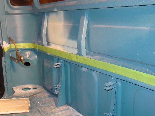

I've been concentrating my efforts on the cab, working at getting a good mate between the upper cab section and the lower cab section. After the replacement of much sheet metal along the upper cab's lower lip, along with re-doing the corner support area, the fit between the upper and lower cab sucked.
It was pretty obvious that if there was a poor fit between the two sections, that any water running down the back of the upper cab would wick into the gap and that would lead to rust-out given enough time, despite the fact that i have new rubber packing pieces for the junction.

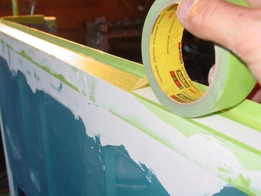

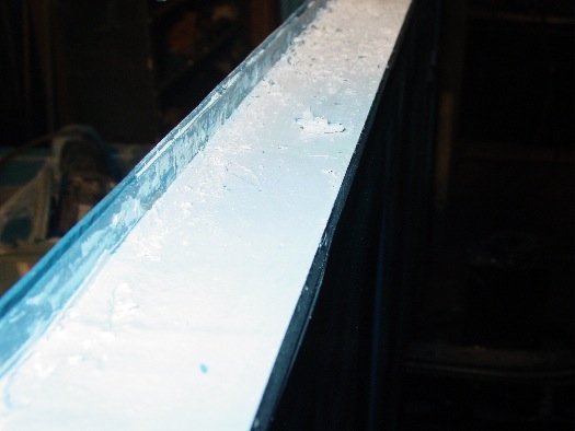

I decided on a two step process - first I got a good straight section of aluminum, like a straightedge, and taped it with painter's release tape. Then I applied double-stick carpet tape to one side and stuck the straightedge on along the main cab section lip. Then I applied the polyester filler in a couple of rounds to build up a flat clean area. I forgot the camera during that stage, but here are some pictures of the lower cab lip after I had removed the straightedge.

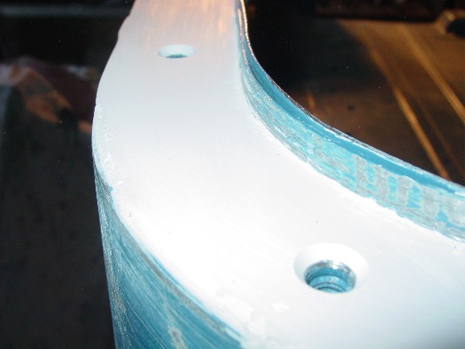

Then I spent some time tidying up the surface and countersinking around the captive nuts. Although the countersinks are not "factory", of course, and they do give away the presence of filler in the area (only with the upper cab removed however), the countersinks do help out with feeding the bolts down from the upper cab, and they are a clean way to finish of above the holes. I noticed in another photo thread that the pre-1979 trucks HJ45/BJ45) used hold-down clamps to fix the upper cab, whereas mine uses 8 bolts or so.
I was going to follow the same process with the upper cab section as i had for the lower, but then I hit upon a better idea: I taped off the fresh filler on the lower cab lip, then applied filler to the upper cab lip and put the two sections together. This would enable me to get a *totally* precise fit between the two sections, or at least I hoped so.
Then of course the camera ran out of battery juice, so I was only able to get one more picture. I've since removed the upper cab section again. With another hour of fussing and mudding, and it will be done. The bodywork on the main cab seems to be moving along at a good clip :bounce:
It has come out pretty well and I am very confident that the seal between the two main cab sections will be really good, perhaps, dare I suggest, even better than "factory"

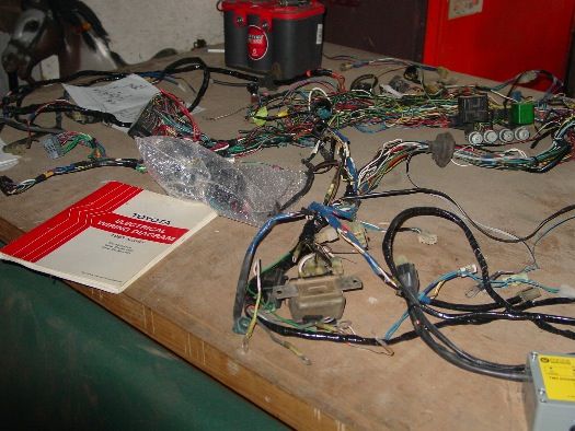

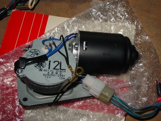

in other news, my recent SOR order arrived today, and now i have my new wiper motor. I'm still working on locating a new wiper relay.

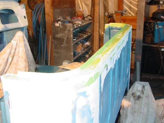

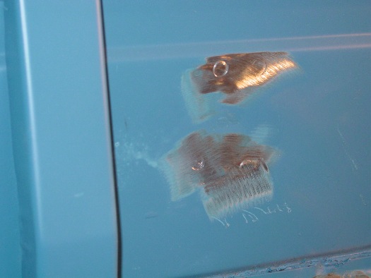

I had a bunch of errands to do this morning, so I only got about 4 hours in on the truck. The work on the upper and lower cab seam is proceeding quite well.
I thought it might be more honest to post pictures of what the body work looks like in the intermediate stages, instead of simply the finished product, so folks can see how the process unfolds. Many out there are undoubtedly pros at the bodywork, and the stuff I'm doing might make a few roll their eyes.
I started out with an ideal of little to no filler whatsoever, and there may be a few people out there whose mastery of sheet metal manipulation and welding allows them to do that. I'm not there, skill-wise, nor will i ever be as fine carpentry is my main passion. So, in the case of the cab lip, i realize that it would be better, perhaps, to have sliced the lip with the zip wheel, adjusted it up and down to achieve a better fit, and then re-weld. Time is not on my side, and I'm actually liking the Wurth filler anyhow. It's very tough stuff and easy to sand, without clogging the paper. Trouble is, I suppose, the more you get into the bodywork, the more flaws you find as you work a surface, and deciding exactly *where* to stop is difficult.
In my woodworking, i pay nearly as much attention to the places that aren't seen as the ones that are in full view, but here on the truck I am making choices a little differently. I probably won't spend time putting the Wurth goop on the cab floor, for instance, as bed-liner will be going on, followed by sound deadener and floor mats. The back wall of the cab is concealed from view by the flatdeck wall, so I am not fussing the work quite as much as other areas. I hope it will come out well in the end, and despite the filler, I have an all-metal cab and panels without fiberglass patches, roofing tar, etc, so I feel like I'm miles ahead of where I started with the truck.
And having seen a 1982 BJ42 from Germany with mint original paint and low kms, I can see that the factory standard for sheet metal was hardly stellar, at least for these '79 and later trucks. Another choice i need to make is whether to leave the spot weld dimples alone or to fill them. In most spots, I'm leaving them - the more egregious areas, like the all at the rear of the cab below the lip, where the spot welds actually sink the surrounding sheet metal in 0.125" or more, I decide to fill. Adherence to what is "factory correct", while important to me, is less a factor than it might be for others out there.
So, here's some shots of today's progress, in all it's plastic rawness.
IN body work it is frowned uppon to put bondo into such a area, but if its hard stuff kinda like dura glass I do not see it being a problem.
Looking like you are getting close to spraying a high build spray putty and blocking party to commense.
Rob
Hi Rob,
Yes, i am getting pretty close with the cab sections to the primer-surfacer application(s). I have been using the ProForm Primer Surfacer, which goes on well, for the most part. It is somewhat poor however as far as sanding goes, as it tends to clog the sandpaper instantly. And a $10 can of the stuff lasts me about 10 minutes when I'm putting it down, so it gets a bit spendy after a while. Unfortunately I haven't found anything else to use, and I'm too far in now to consider going and buying an HVLP unit, etc., and buying the paint by the gallon. That's what i should have done here, and would do the next time if there ever was a next time.
