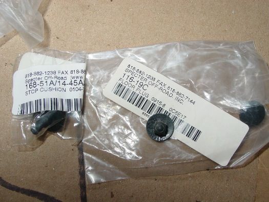

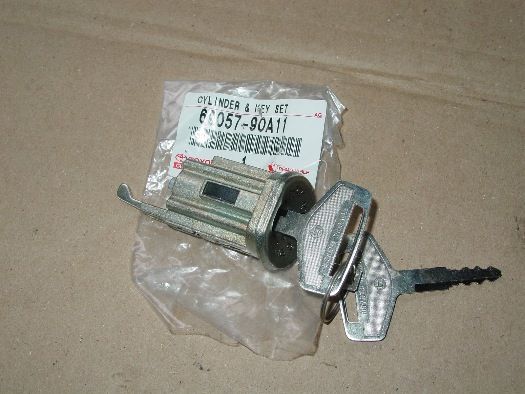

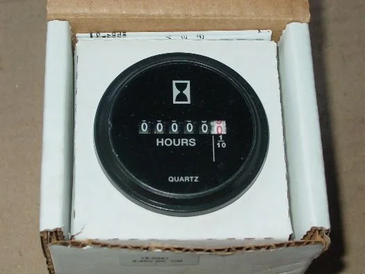

...some minor plugs from SOR and an engine hours meter from JC Whitney. I'll need to put a 2" hole in the dash to mount it. I also acquired a warning light unit off of Ebay ,which combines the 'filter' warning with the 'brake' warning light (eliminating the 'seat belt' light), so I don't need to cut a hole in the dash for the filter warning. I'll post a pic of that warning light combo unit when it arrives. I've also got a set of new Toyota door locks coming from Australia.

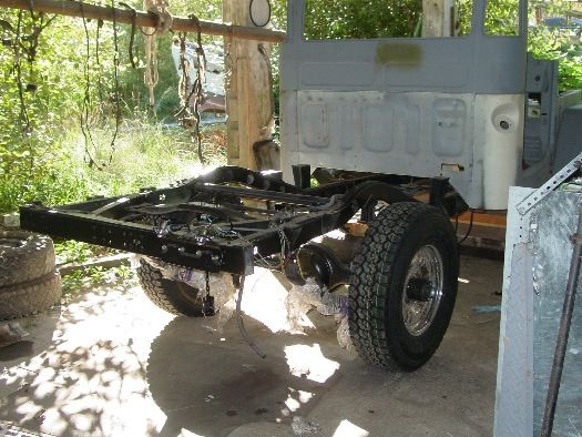

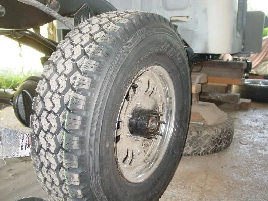

And then I traipsed on down to the local OK Tire outlet and picked up a couple of tires. I selected, after careful consideration, some Toyo M55's, in a 235/85/R16 size, which works out to a 32" overall diameter. These are 10-ply tires with reinforced sidewall, and are designed to perform well in snow and have good traction. I considered the more off-road oriented M/T units from Toyo, which look really cool, but this is a work truck and will spend most of it's life on the asphalt.

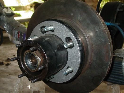

The new wheel spacers were a little thinner than I was hoping, and I needed to remove a little more metal from the side of the 4Runner calipers to achieve a interference-free fit. After the grinding was over, I repainted the calipers, and installed them with ceramic pads.
It was so sweet to get the truck back down onto the ground again, at least at the back. When I've finished re-doing and installed the front diff., and the front brake dust shields have arrived (on their way from Japan presently) and are put on, I can go ahead with getting the front tires. When it's all down on the rubber at last (maybe by the end of this month?), then I can look at putting the engine back in.

I discovered today that the Toyo M/T tires were also 10 ply and considered them anew, but, given the reality that 95% of the miles I will do with the truck are going to be on the pavement, I think I made the right choice with the M55's for my situation.
Tire size was one of the main things I wrestled with in the decision process. I was looking for the 'rubber overdrive' effect, but didn't want to push the tires too big or I'd run into issues with the engine struggling too much to roll them. I mean, at 103 h.p./177ft.lbs, , the 2H isn't exactly a powerhouse, and I've come across enough accounts of sluggish performance with oversize tires and diesels (yah, I know, go turbo...). I felt that 32" was a good compromise, though time and miles will tell.
Also, these M55's are durable tires from all that I have been able to learn, and that was confirmed again today by the guy at the tire shop. Around here, with all the logging roads and forest industry business (Vancouver Island is pretty close to moonscape in many areas unfortunately), there is plenty of real-world brutalizing of tires going on and a lot of experience to draw from. Another factor in the choice was that 235's are one of the most common tire sizes out there for trucks, so I'll have no problem getting a spare if I were to trash a couple of tires in some out of the way locale.

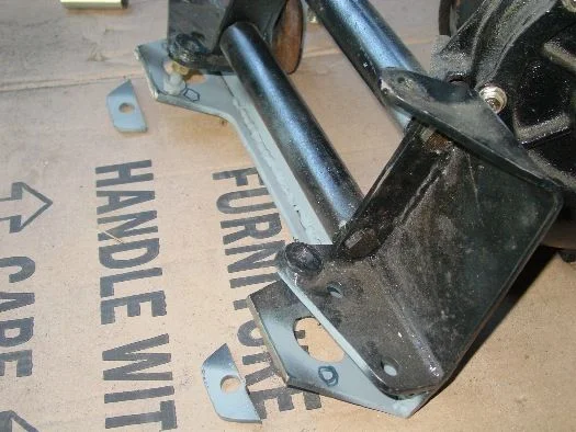

then I took the front sheet metal off the truck, and pulled the pto winching drum off to start in on the remaining work necessary to mount it cleanly to the bumper.
