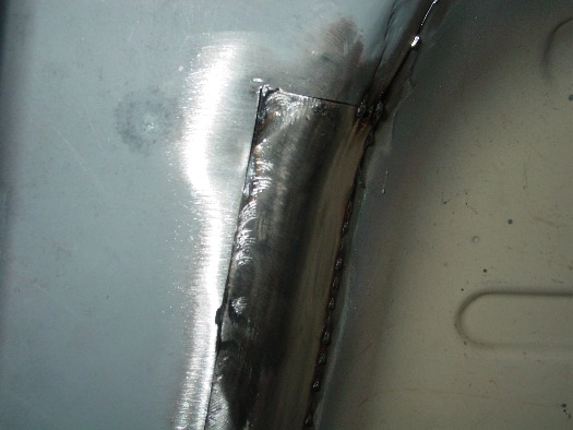

Another 3 hours tonight. Doesn't seem like I got much done, though the driver's side floor is looking a lot better.

Looking good, very good. Your floor repairs are coming out very well.

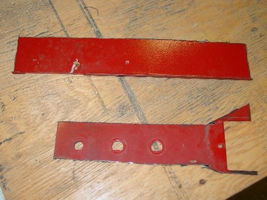

This morning I managed to arrange with a helpful friend to go out with a trailer to drag home some landcruiser stuff from out in the bush. Here's what the cat dragged in.
The red one is a '77 FJ40, while the white/green one is from a '79 BJ40.
The FJ had just the arrangement of heater cables and switches that I was wanting

Then I turned my attention to getting the little mounting brackets for the glow and starter relays installed on the passenger side apron. The FJ inside firewall yielded the bracket for the glow relay, an exact match on bolt spacing. The small tab I'm using for mounting the starter relay came from the BJ40 firewall, and needed a nut welded to the backside.
last set. I might put another bracket on the apron for mounting headlamp relays, or I might use the 60 series ones somehow. I'm also looking at the possibility of using the 60 series fuse panel instead of the 40 one.
Edit: I notice I've put two glow plug relays into place (one older style, and one newer style), instead of one glow plug relay and one starter relay. Hopefully this is not ass-backwards - though I'm pretty sure that my starter relay will fit one of the mounting bars I've put in.
Edit 2: the correct starter relay fits right in where the black glow relay is mounted in the picture, so no problems.
