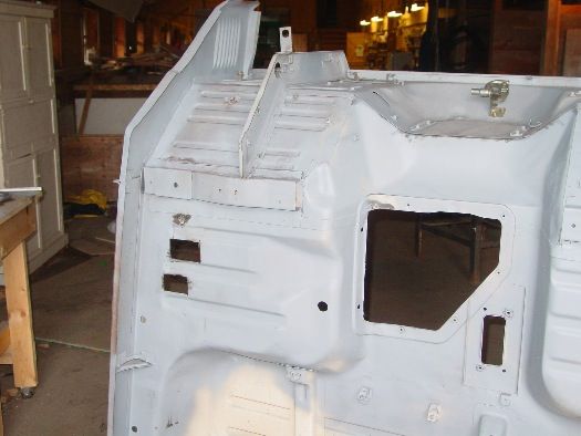

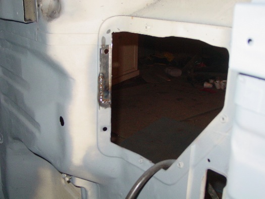

then I drilled holes and welded captive nuts to mount the sheet metal baffle which goes atop the heater pipe feed into the cab.
I'm planning to use the tee-junctions and rear pipes from a regular 40 series as a means of heating up SVO in a separate fuel tank, and If I'm going to do that I will need to put another hole in the rear of the passenger seat well so the pipes have a convenient exit point to the rear.

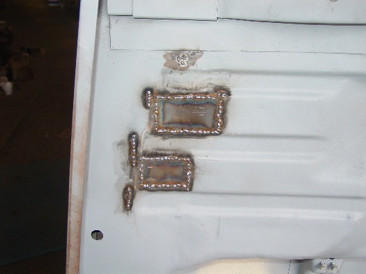

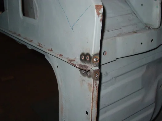

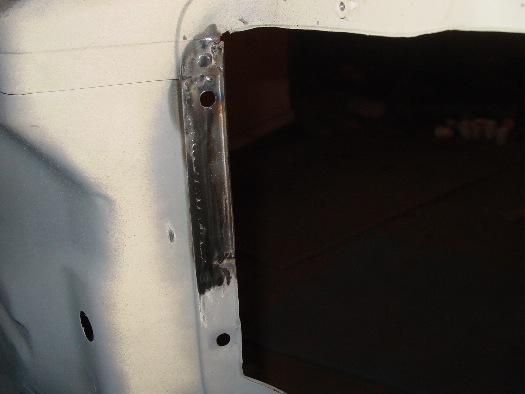

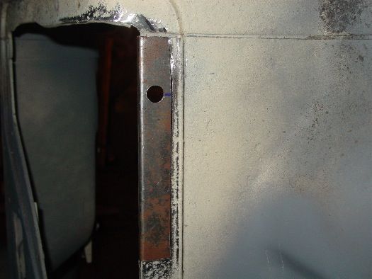

After the gusset was cleaned up and primered, I went and re-worked an earlier patch that was not too pretty. This one was covering the hole for the RHD parking brake, and I chopped the crummy earlier work i did out and welded in a new patch

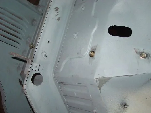

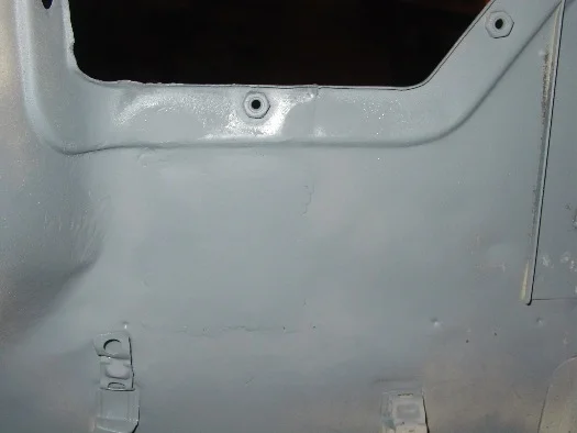

I then worked on the myriad defects in earlier work on the floor pan, and ran out of etching primer again. I remembered to drill a couple of drainage holes with the .875" hole saw in the passenger side floor under the rocker panel sandwich (visible in the second pic.)

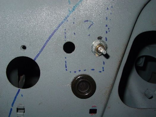

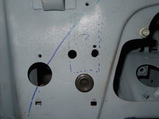

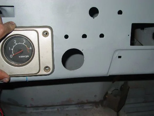

Unfortunately, I should have taken a little more care and thought about placing the rheostat, as it interferes with the aux. lighting switch that mounts in the neighboring hole. Another weld repair coming up. then I found out I was out of gas, which is really weird since i only filled the tank a few days before going on vacation.

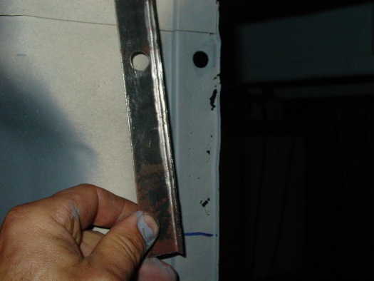

Did this same mod on the HZJ45, welding is OK, but you might want to think about running a bolt throught the tube as back up as I have seen the weld fail.

I started tonight by repairing yesterday's mistake in placing the rheostat. I looked around the dash, and decided that the next best place to mount it was out in the middle, in the upper row next to the power socket/lighter
