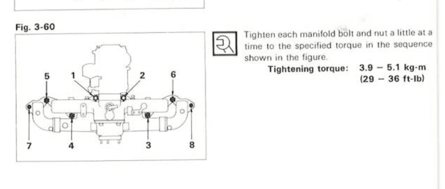

As a slight curve to the topic; once you put the new manifold on, is there a tightening sequence and what are the proper torques, especially with a lubricant like never sieze on there? Dry torque vs. lubricated torque is something to consider.
I'll most likely be installing a new manifold gasket myself shortly, and have not had luck when searching for this information.

The FSM has the tightening sequence and torque values for the manifold (see below).
I'm using the nickel Never-Seez, and plan to reduce the torque by 5 or so lbs because of it. That's based on advice from my local fastener guru, though I would defer to some others here on Mud who've done this more than once. Especially those who are able to go for long periods in between...
