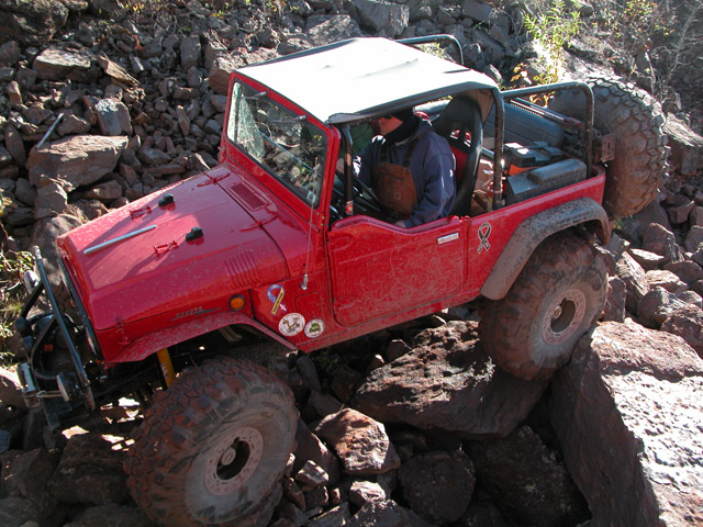

I had two 60" high-lifts in the rack...
After taking the rack off, I moved one to a tube mount I made behind the rear seat....
Hope that helps...
:beer:
