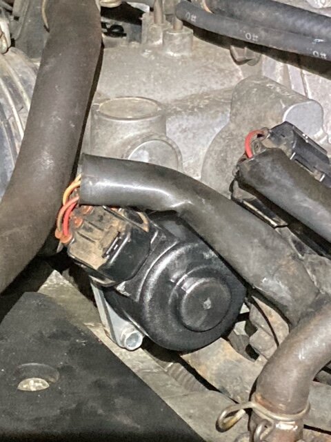

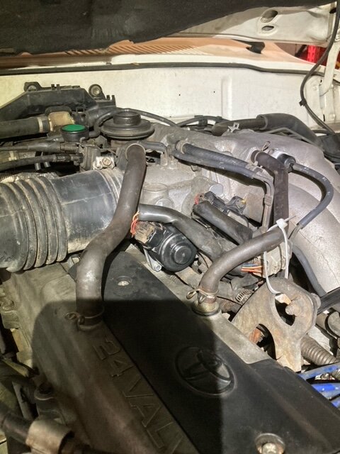

Update:
OK, the high idle issue did not, in fact, go away with Seafoam. It did for a while but came back after about 400 miles. So I followed jonheld's advice and looked into the IAC valve. I didn't know where it was but it wasn't hard to find, it is facing the front of the engine attached to the throttle body opposite where the accelerator, cruise control and throttle cutoff cables are (on top of the engine). See the picture below, its the black circular object in the middle of the picture.
I replaced the IAC (part 22270-66011), along with a new O ring (part 90079-60004, the new IAC valve normally does not have a new O ring) and that solved the problem for good.
Of note, there are 2 Philips head screws that hold the IAC onto the throttle body and mine where locked in place. I got the top one out but the bottom one is in an awkward spot and you cant get a tool straight in on it so its really easy to strip the screw if you are not careful, like using a drill to try to twist it out (ask me how I know). If you have a cordless driver or some such use that and be very careful in trying to remove it. I eventually got mine out with an easy out and driver but it took a while, I had to buy some tools I didn't have, and I was very close to having to disconnect the entire throttle body off the engine to be able to get at the stripped screw on the IAC. You can see in the zoomed picture I replaced the screw with a machine bolt so its less likely to strip if I ever need to remove it again (the thread is #10-32 x 5/8"). A dab of anti seize was also applied.
