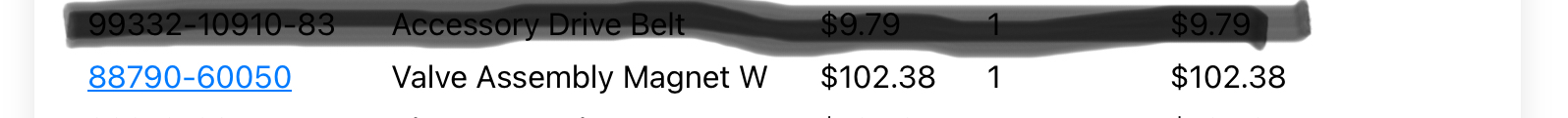

Do you have a part number for that? Mine has a round connector, all the ones I see online are square.
looks like the temp sensor changed in 98 to the rectangular connector commonly found online, the 97 part is 9697LX4 60050, or 88790-60050, they look to be identical. Of course double the price and the only place I could find it was on ebay.

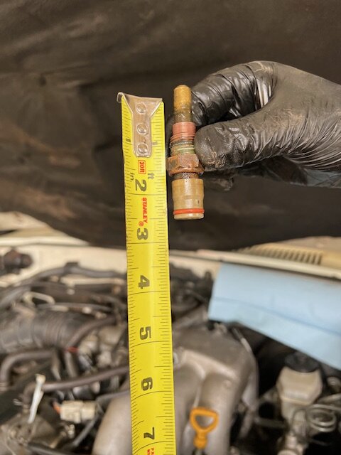

It should the square connector one like this. I wonder if you removed the right one, check the neighboring ones to see if there's a squarish connector one (-that is right one)
I don't think thats right. As I noted above as far as I could find in researching the issue is that the square connector came into play in 98. Mine is the round one. It is not an aftermarket addon, I can tell looking at the harness that the round connector, on my Land Cruiser anyway, is stock.

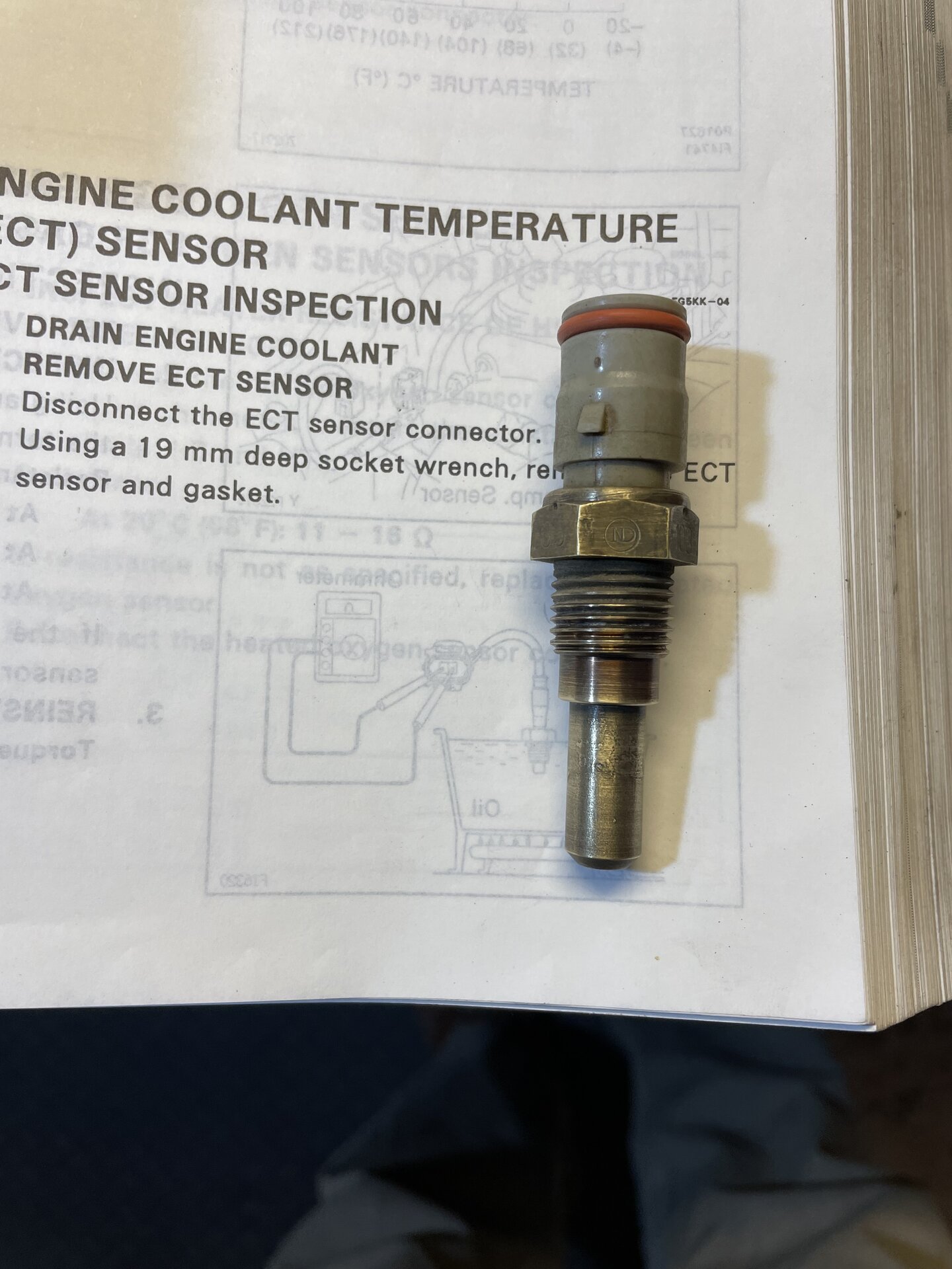

This part # is correct. Toyotas description is wrong…….
Maybe this is helpful?
yup, thats the part I bought. It seems to level out the high idle a bit but still seems to stay in the 900-1000 range for too long. Eventually it goes to 640, usually, sometimes not.
