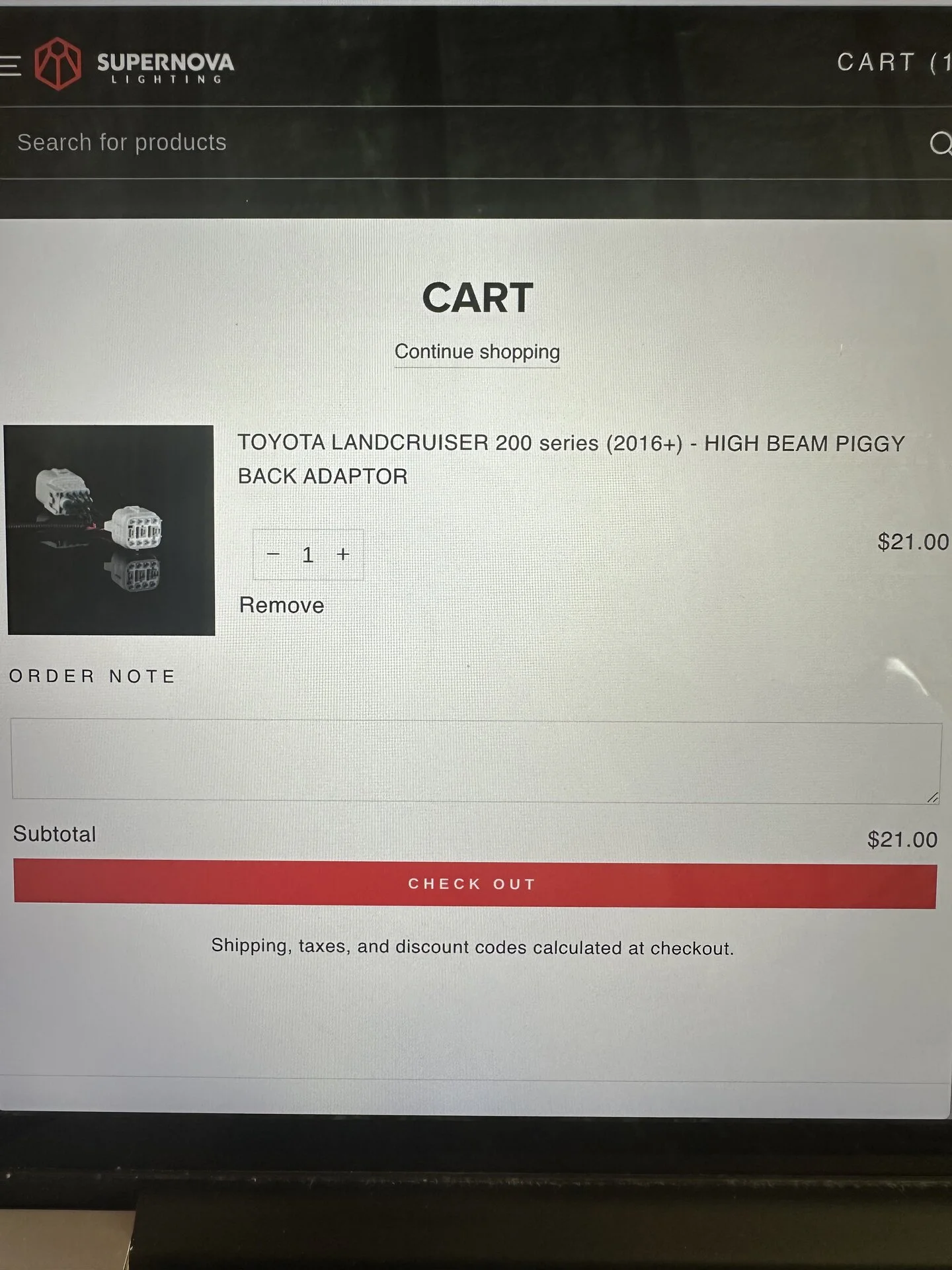

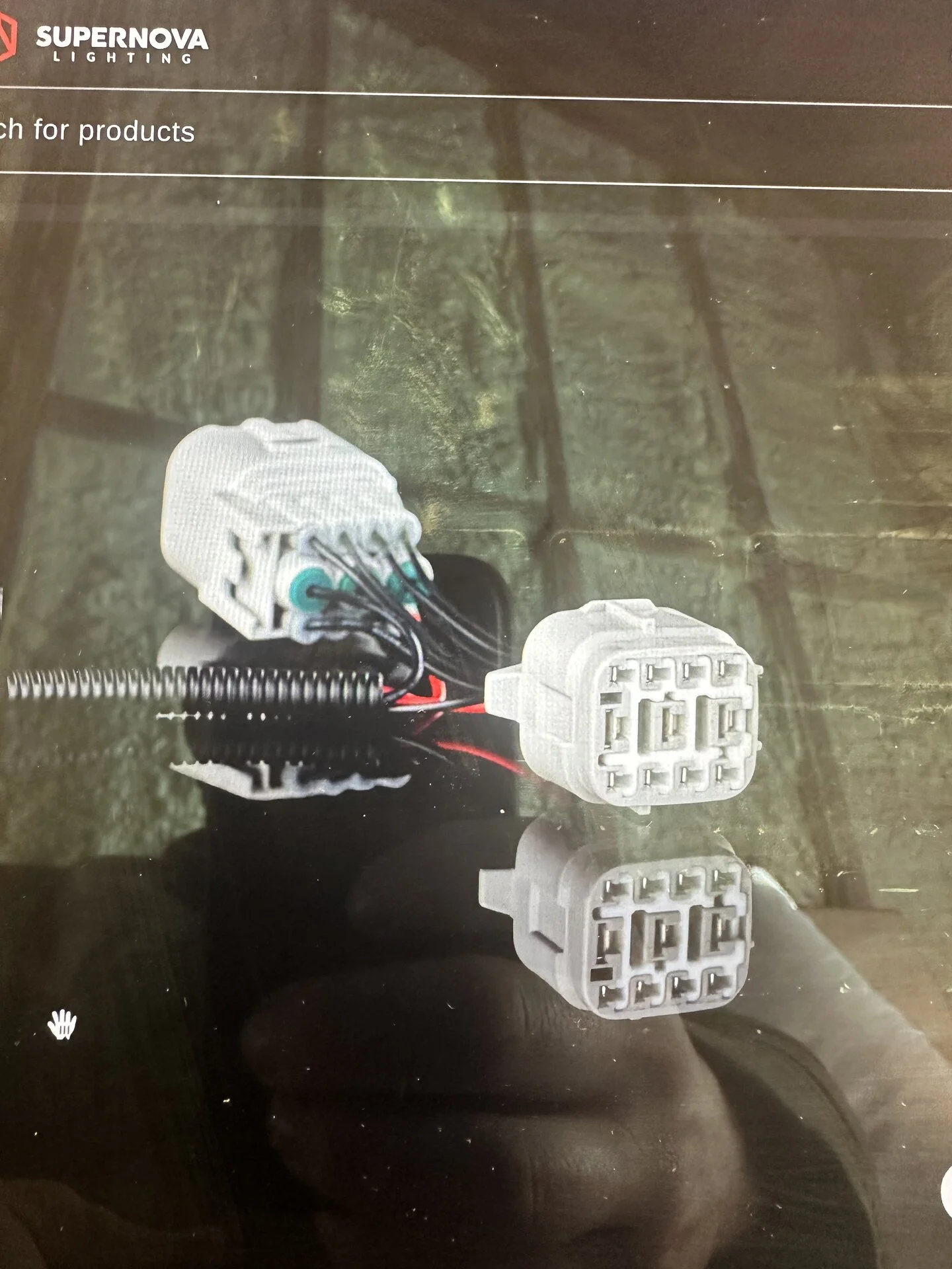

Update: I ordered and installed the 2016+ LC piggy back connector from Supernova and it works flawlessly. The only hassle was getting the high-beam connector unplugged to begin with! I found that sliding the whole connector harness off it's mount allowed me to then much easier disconnect from underneath due to the tight angles (I run a bullbar and didn't want to have to mess with it).

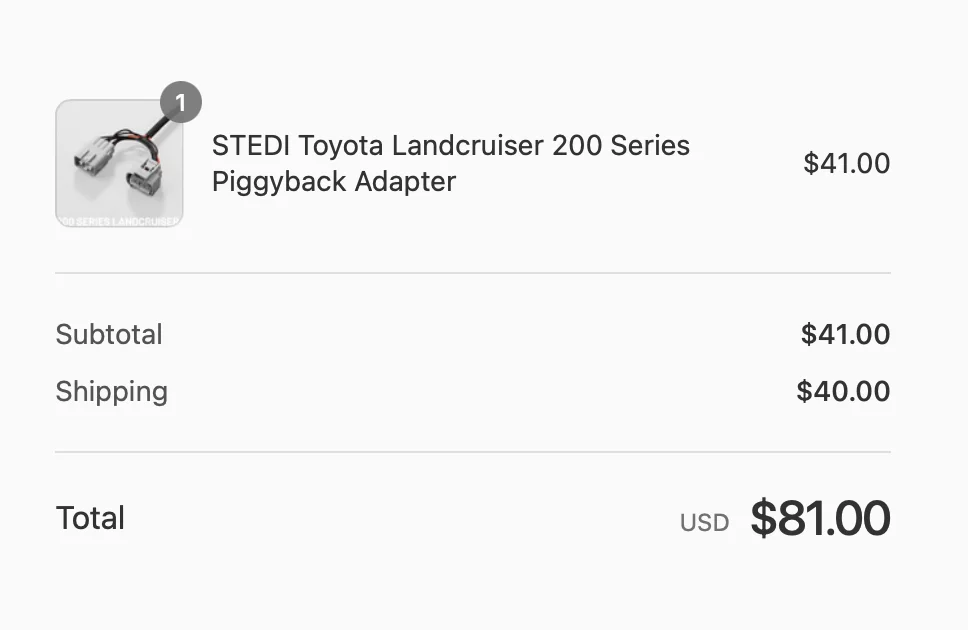

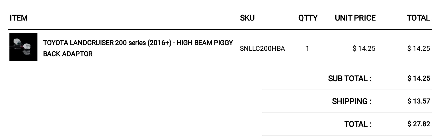

I compared pricing between Supernova (Australia) and Stedi UK who both ship to the US and Supernova was much cheaper ($27 total) than Stedi UK ($81 total) when shipping to California (screenshots attached).

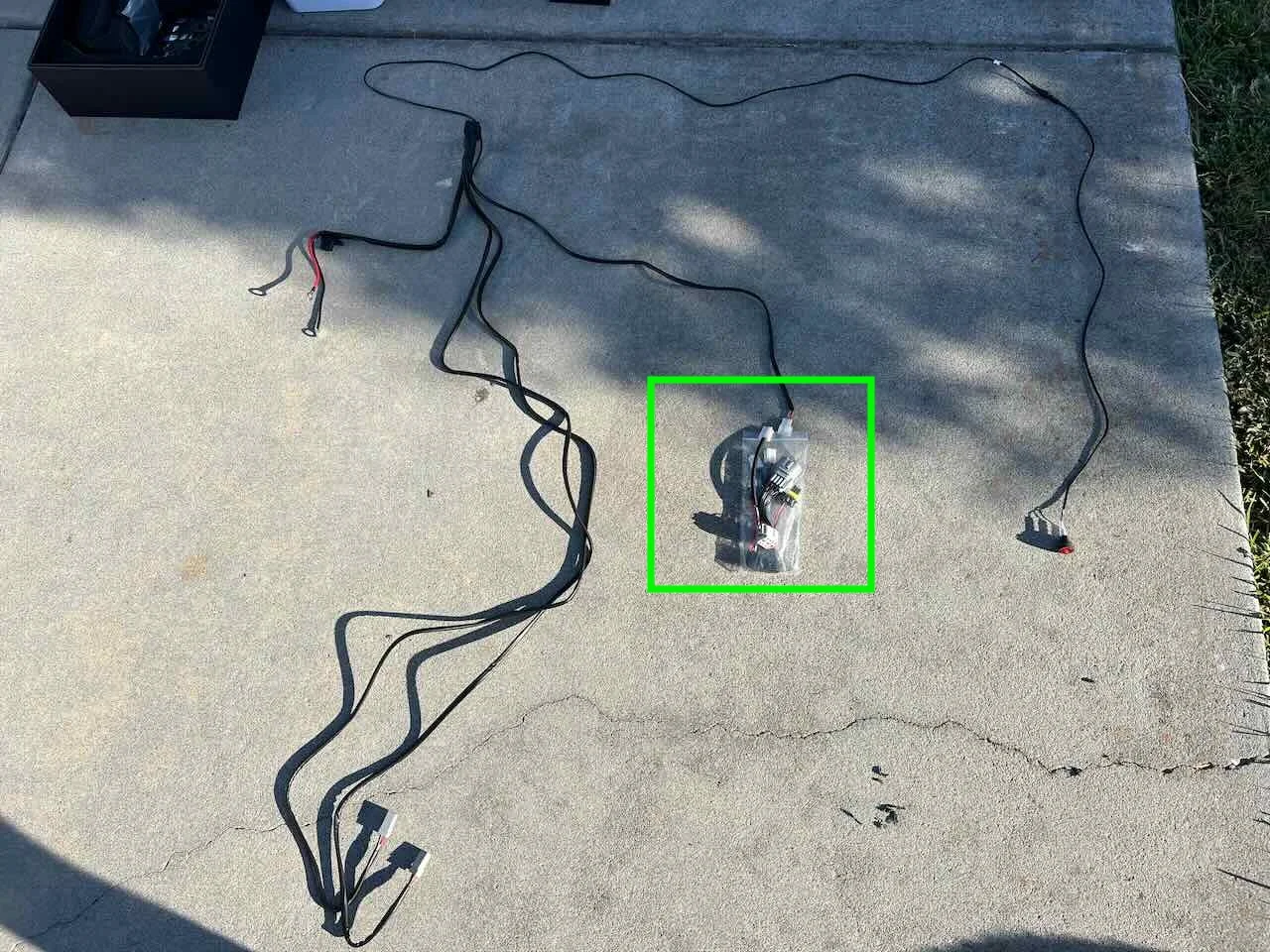

Here is the wiring loom that came with my new Stedi Type-X spots with the new piggyback adapter highlighted. Didn't have to mess with tapping, plug and play:

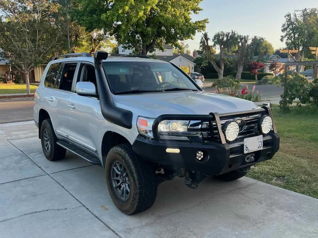

The end result:

Which model and size lights are those? I ordered summit bumper and gonna order that piggyback. Anything else I should order from them at same time that I may need to make light’s successful? Thanks
