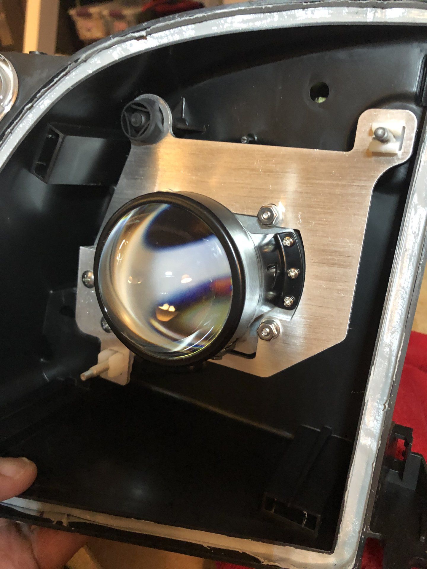

Since you're this far into trying to improve your lighting ... pick up one of my brackets and you'll have the lighting you desire. You have the harness, bulbs and ballast so all you need is the Mini H1, Moto Holders a few hours to install or I'll build you a set of lights and you have this.
You'll get a modest improvement trying to shim the bulb in the stock projectors

Yeah, this really is my best option. So you sell fully retrofit lights? I wouldn't mind getting a new set anyway as my passenger side high beam has a big chunk chipped through. How much $?
$1450.00 plus shipping for the Mini H1 or $1750.00 for the D2S .. add $40.00 for glass lenses
