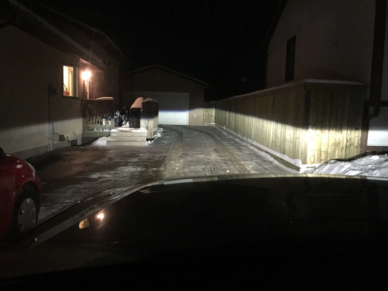

Better option:
-Factory Projectors
-2.5" clear lens swap
-H1 HID kit
Write Up: LX470 Projector - TSX-R Lens Swap
Cost: ~$190
Parts: 2.5" : FX-R - Clear Lenses from The Retrofit Source
H1: Morimoto Elite HID System - HID Systems from The Retrofit Source Inc
This is a decent option that offers substantial improvement over the factory halogen setup. It does require you to separate your headlight housings, but for the budget conscious consumer, this might be the best option.
Pros:
-Sharper cutoff and more light intensity than the non-clear lens option.
-Brighter than stock
-Cost
Cons:
-Seperation of housing is required
-Beam still gets lost in rain and bad weather
-Can blind oncoming drivers is "squirrel finders" are not closed
full
(@Luke111 photo from: New 2006 LX in Virginia)

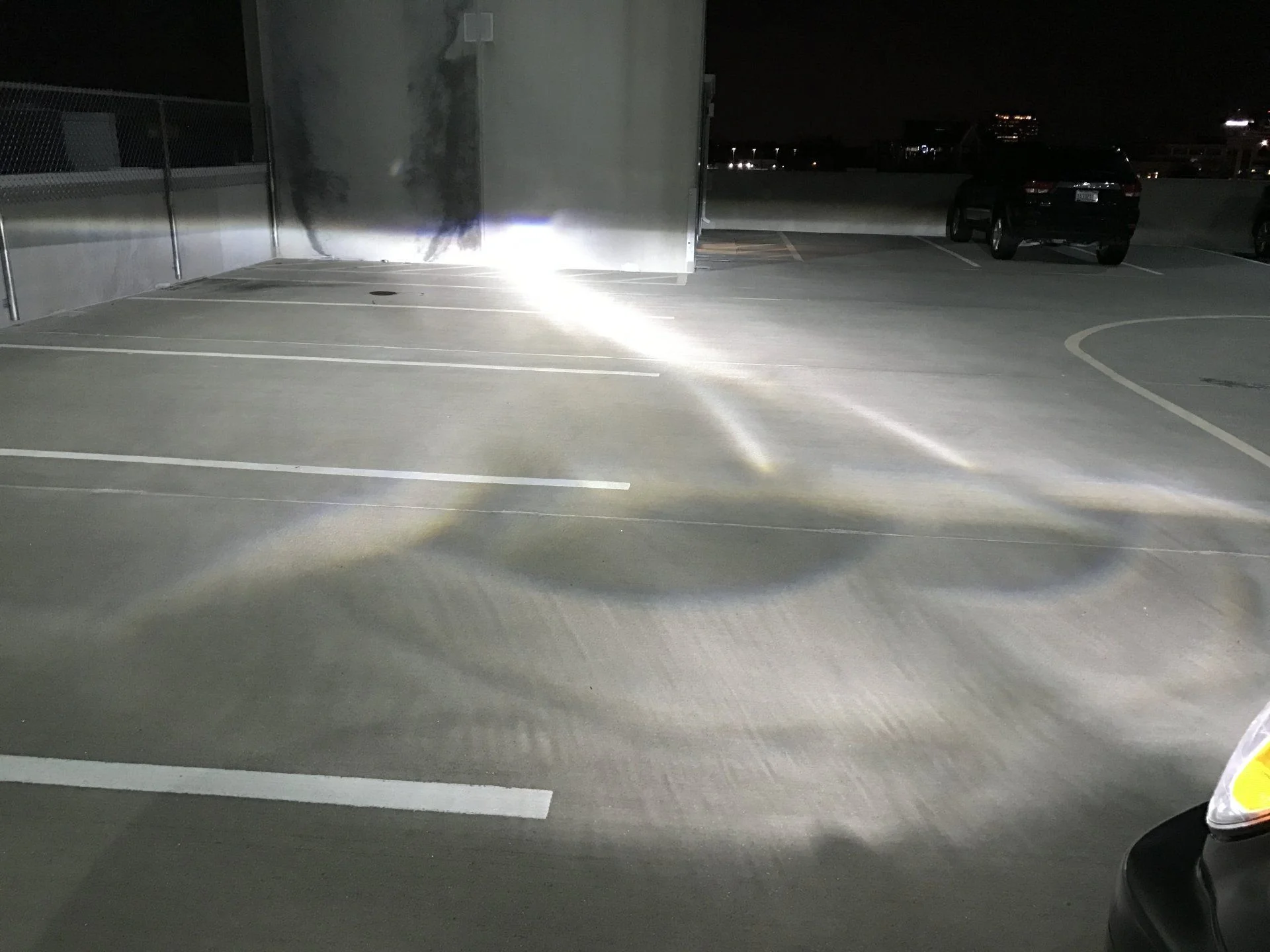

Best option:
-TSX Projector Retrofit
-D2S HID Kit
-80mm Rubber Caps (dust seal for the rear of the housing as the stock one doesn't fit)
Write Up: Retrofit HID's and TSX Projectors into my LX470
More pictures and info: Lexie the Comfort Cruiser
Cost: ~$350
Parts: D2S: Morimoto Elite HID System - HID Systems from The Retrofit Source Inc
Low Beam: Acura TSX - HID Projectors from The Retrofit Source
Rubber Housing Caps - Custom Headlight Build Materials from The Retrofit Source
This is the best option out there and what I am currently running. It provides a clean cutoff with bright, evenly distributed light while (when properly adjusted) doesn't blind oncoming drivers. My windshield is tinted 60% and the light output is still nothing less than stellar. There is an optional clear lens upgrade for the TSX projector, but I preferred the stock lens (2.5" : TSX-R - Clear Lenses from The Retrofit Source).
Pros:
-Bright, full, useable light output
-Easy to source
-Easy to retrofit
-Wide beam pattern
Cons:
-More expensive
-Requires irreversible modification of original projector (not a bad thing)
-More work intensive
full
(@deanfun photo from: Retrofit HID's and TSX Projectors into my LX470)

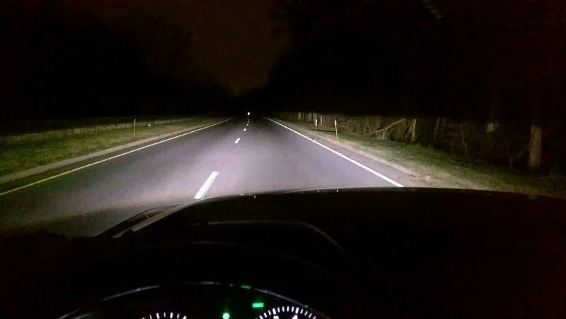

Other Best Option:
-SC430 Projectors
-HID Kit
Write Up/info:Lexus LX470 retrofitted with Lexus SC430 projectors.
Cost: ?
This is an equal upgrade to the TSX projectors, however the SC430 projectors have proven to be almost impossible to find by myself and other forum members. It is however an easier swap, but still requires you to cut the original projector.
Pros:
-Easy to retrofit
-Wide beam pattern
Cons:
-Same as TSX Cons
-Harder to source over the TSX projector
full
(@silverbullitt photo from: Lexus LX470 retrofitted with Lexus SC430 projectors.)
