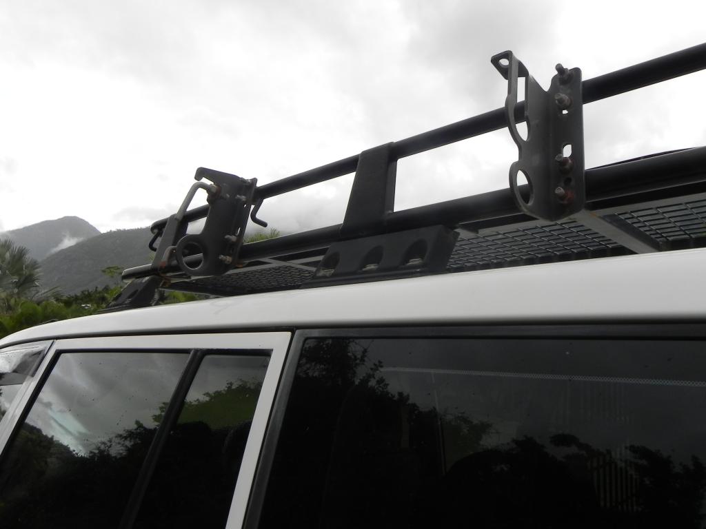

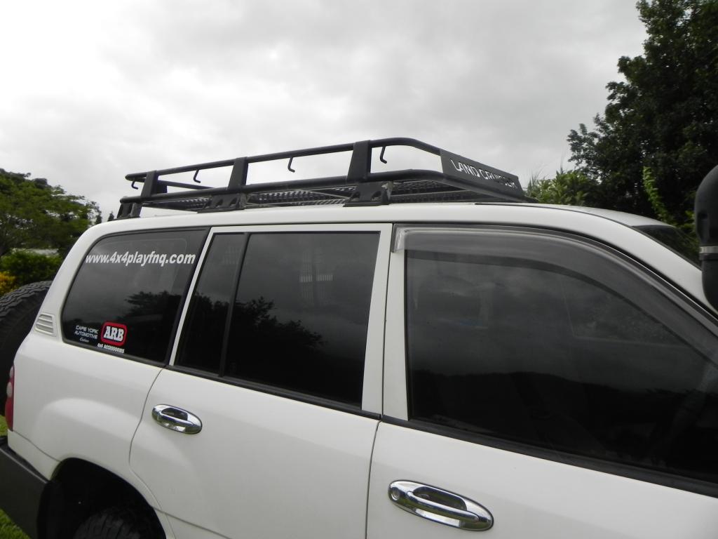

Try ARB or Kaymar. Mine are mounted to the roof rack it holds both the high lift and the shovel. It is true that bugs dust and dirt can get into the mechanism of the jack. If I a, expecting dust, dirt and mud, I simply wrap the mech in Glad Wrap.
Not sure if its called the same thing in the U.S. but Glad Wrap is the clear plastic stuff on a roll that you wrap around your sandwiches.
I also added on the Highlift jack and shovel holder to the rack.
