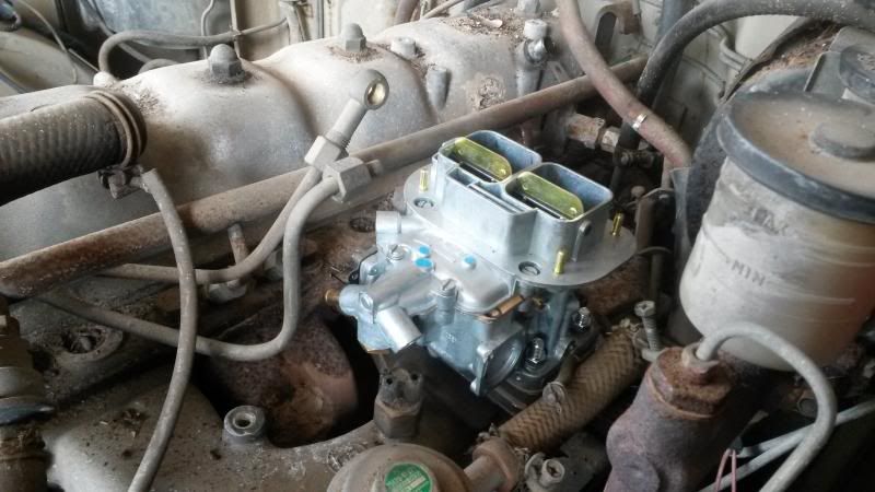

I have a weber on my 71 and the man who owned it before I did put over 2" of spacers under carb. I don't know if that would help any
And mine had to have the spacers to match up with the stock breather too
It looks like I would need a lot more than 2 inches. And doesn't even look like those lines would actually bolt up to the inlet and outlet of the carb. And I don't even know where to begin when it comes to the throttle linkage. Thanks for the help
The lines would need to be cut and bent to line up and then attach to the weber
It is not a direct bolt on
If I were you I would buy a Trollhole carb.... It's new replacement ... A direct bolt on (or very VERY close to being one) and youll retain all the oem stuff to go with it
if you live were the cruiser will be subjected to a smog check, the weber is going to be very disappointing. even one of the trollholes is not smog compliant.
Take it back, tell them it doesn't fit, and buy an Aisan from the classifieds and send to Jim c for rebuilding, or from cruiserparts.net.

I bought the Weber over 2 years ago now. I might try bending lines this weekend. My ultimate goal is to put the 350 TPI engine from my 89 Camaro in there. Those motors have great low end torque

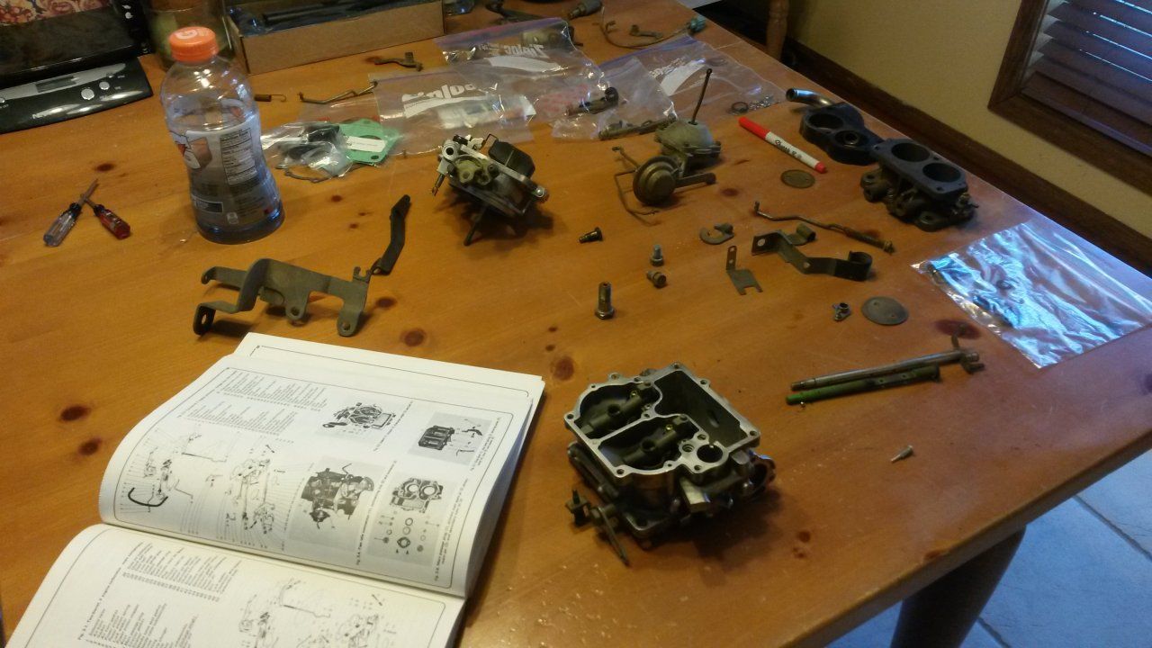

Ok. So I've finally decided to break out the old original Aisin that I had given up on rebuilding years ago. Here's where I'm at. I can't seem to find the weight that goes in between the "stopper" and the "steel ball." Any ideas on getting just this piece or using something as a substitute?
