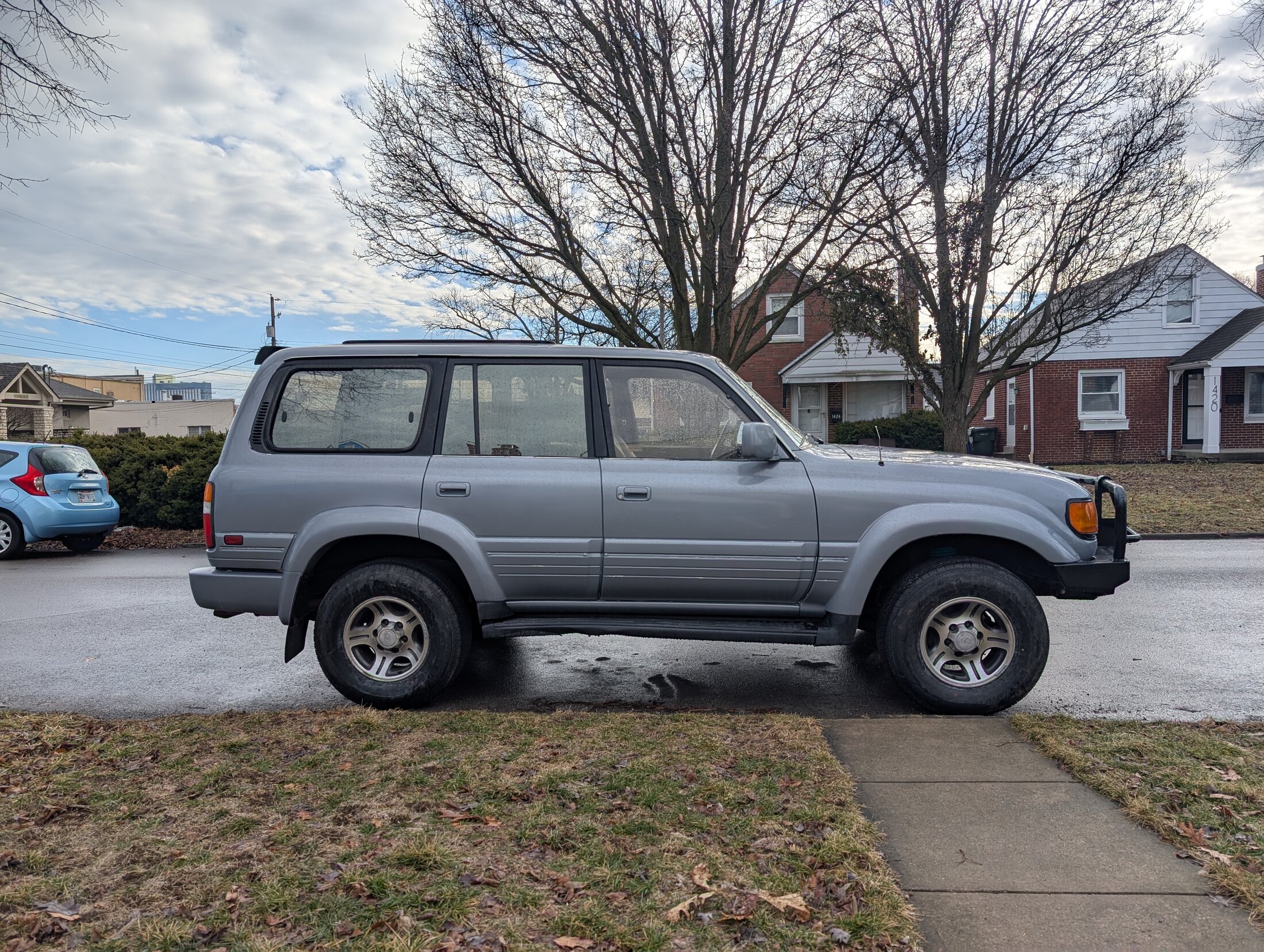

Appreciate everyones time. Below is how the truck currently looks with the stock tires + lift.

I agree. If you don't like the look of the lift, go back to stock springs (used. Don't think they are available new from toyota anymore), or Dobinsons stock height springs.
there is definitely cheaper options for shocks, but I think with shocks, go as high a quality as you can justify
I agree, go with the Dobinsons stock height
Sadly partsouq also has them as not available.
I think the best thing to do here is the dobinsons stock height springs, thanks guys.
IMO the Dobinsons is a better choice you should get a little over OEM height with a better ride.

I bought and installed the dobinsons stock height coils. Looks much much better now, thanks everyone for the suggestions!
Looks a lot better. I'm considering going with the Dobinsons stock height for my 80 as well, but I'm going to go with some 285/75's first.
