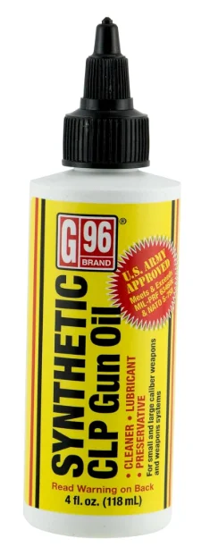

You can relube the cable. I've been think about this on mine too.
It will require something light, that doesn't oxidize and get sticky, and able to withstand low temps and remain functioning.
I was thinking of using a synthetic gun oil called G96 as I personally have proved it remains liquid down to -65*F, (cold chamber at work) and it meets the other two criteria as well.
Thanks. I mean, it was a brand new cable … but I guess it’s possible that it sat on the shelf for so long it dried up, and using graphite didn’t help …. hrm. I wonder if a few drops of ATF oil which seems to penetrate EVERYTHING would do the trick?
