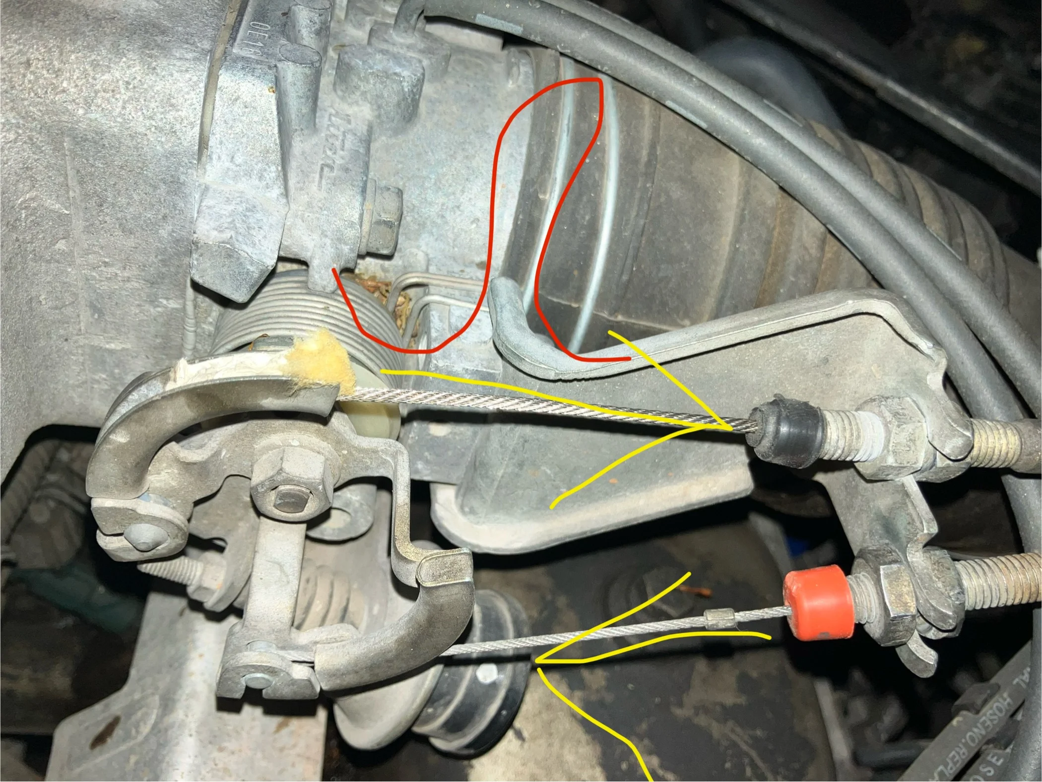

Anyone know a good place to get these cables? The accelerator cable (???) that goes into the black box on the passenger side and the kickdown cable.
Mine are stretched to s*** causing wear on my transmission from hard shifts. I managed to pack a ciggie in there to let the cable have Less slack so it won’t shift like it’s wide open constantly but I need to get that part before I can start driving her again!
Why not just adjust them with the jam nuts on the bracket there? Thats what they're for....
Because it’s so stretched that the jam nut don’t do anything anymore… seriously Facebook has given me more answers than this forum on this for some reason the red on the photo shows the path the cable is taking instead of the path it should (yellow) because it’s stretched can’t get it not to do that without raising file to high hell because of the cables function
If the cable is not returning into the jacket, thats indicating something else isn't pulling on the other end of the cable, or its binding internally. Typically that isn't a symptom of a stretched cable. Have you detached the cable from the throttle linkage and confirmed it moves freely? Is the cruise control actuator binding up? I'd disconnect the cables from both ends and check their movement, and use a cable lube tool to inject some lube in the jacket. Checking the usual online sources, many of the 3FE cables are NLA, so your best bet may be some good used ones. I'd call Georg at Valley Hybrids and see what he's got.

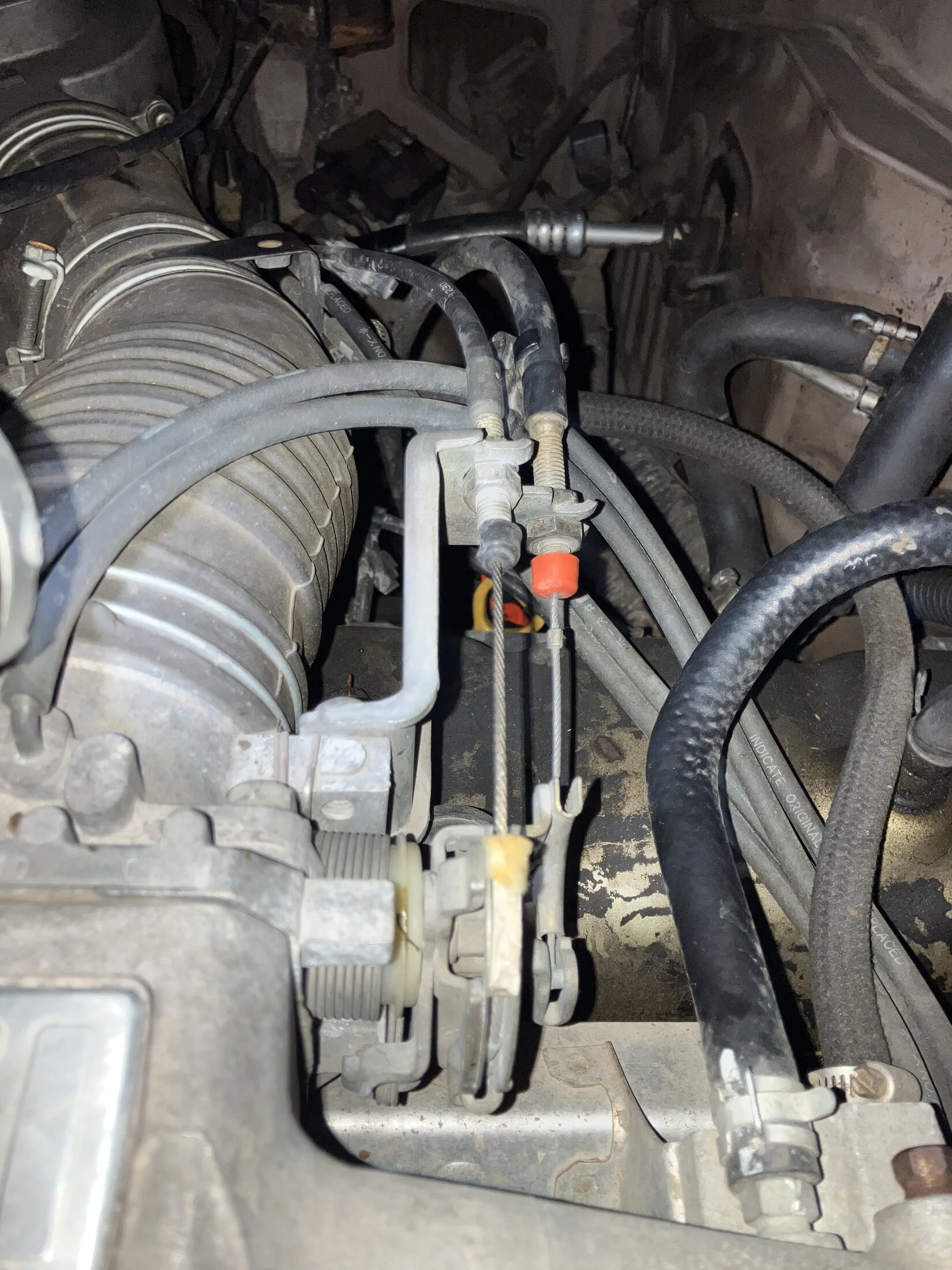

The throttle cable (black stopper) runs to the cruise control actuator on the right fender. If that's the one that is not returning to the correct position, then your throttle would stay open or the throttle pedal would not return properly.
The transmission kickdown cable (orange stopper) requires very fine adjustment. From the pictures you posted, I can see that it is WAY out of proper adjustment.

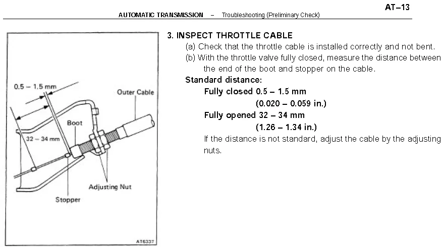

I would suggest following the adjustment procedure in the Toyota FSM and go from there before replacing parts.
Again, the kickdown adjustment should be made in VERY small increments as you're adjusting the overall system fluid pressure.
The FSM and EWD for your truck can be downloaded for free in the resources section.

Again, I would refer to the adjustment procedure in the FSM before replacing parts. Keep in mind the FSM calls the kickdown cable the "throttle cable" in the AT section.
Once you're at the correct starting point according to the FSM, you'll be making VERY small adjustments. Like 1mm at a time at most.
If you replace the cable with a non-OEM part, you will have no length reference to start your adjustment.

What are your measurements between the boot and the stopper with the throttle in the idle position and WOT? You seem to be concerned with "slack".
At the idle position there should be slack in both throttle cables. Did you start at the FSM specification? That should have been the very first step.
