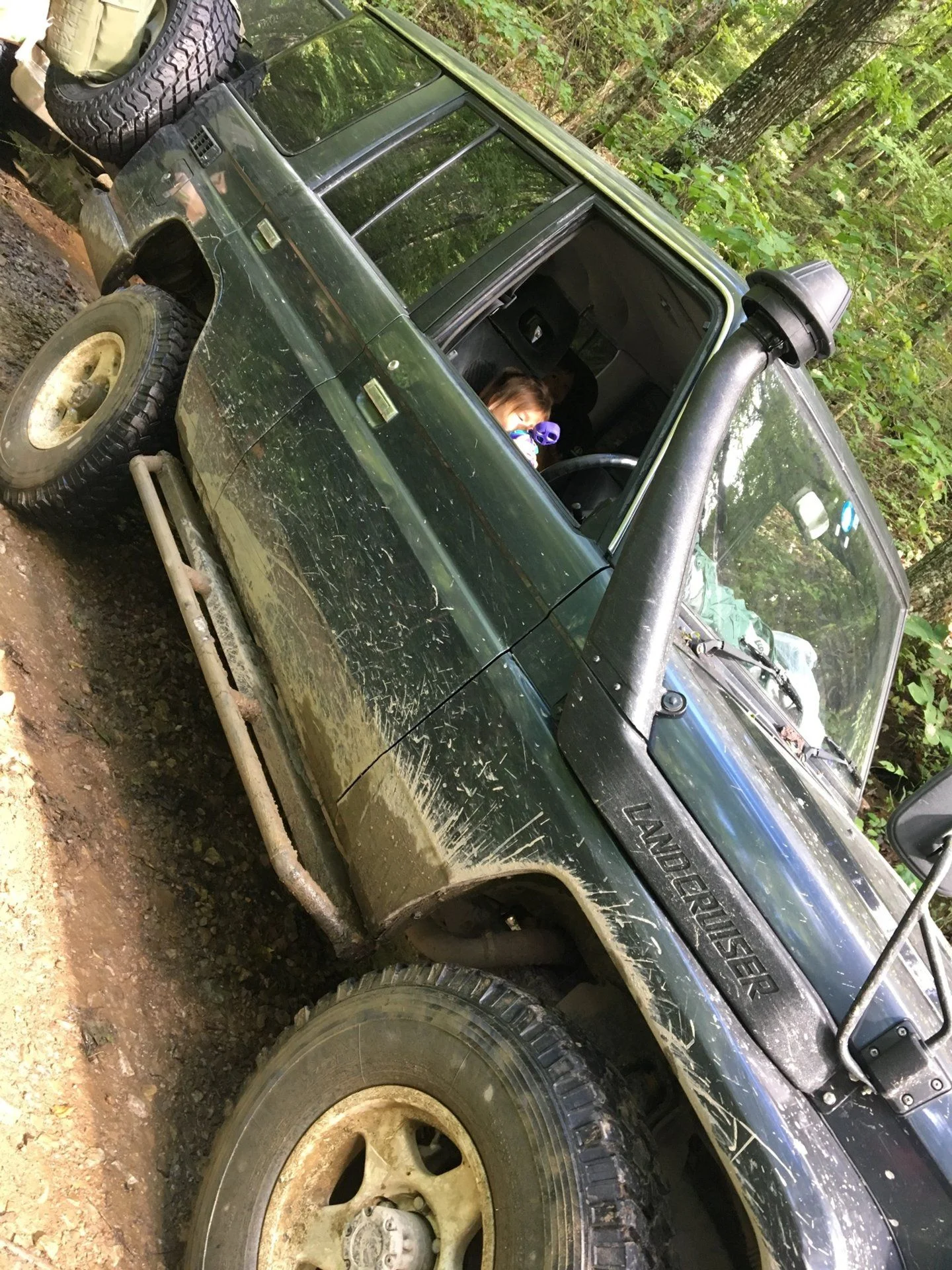

I second 235/85R16. Excellent all round tire, easily available, and economical to buy. Currently I'm running 235/85R16 Duratracs. Those air'ed down are actually do very well off road.

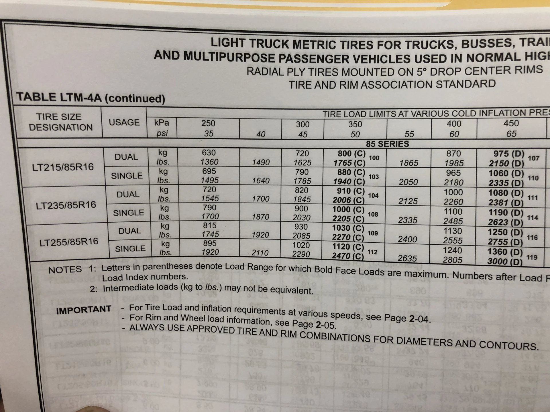

215/85/16 is about as tall and skinny you can get stateside for 16" 85 aspect tire I believe. I don't even see a table for 95 aspect.
^^^ Proverbial horse’s mouth here...
IE: factual information. Not opinion.
Anything can be bought on "Amazon" or Ebay!
I guess I should have been more clear. I just don't see the size in question listed in the "yearbook". Simple searching online appears to show that this tire is specific only to the 70 series therefore I don't expect it to be available in the replacement market stateside.

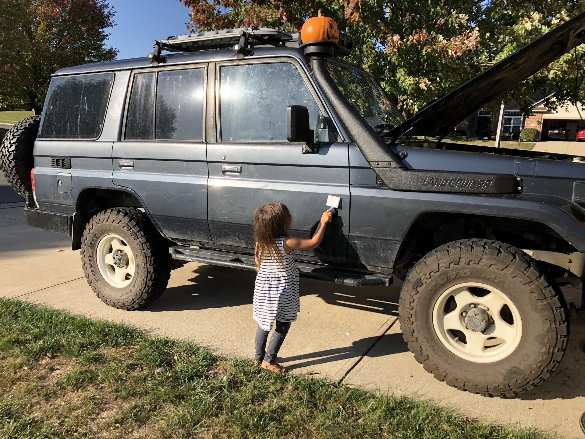

If it's the latter, then as others have stated, 235 85r16 is a good size for tall skinny, or in the taller size, 255/85r16 which is what I'm running.
So size wise you can see they are almost identical. When you factor in different brands can vary as much as 1" on a size, this is as close as you can possibly get.
225/95r16 = 32.8 x 8.8
255/85r16 = 33 x 10
7.50 r16 = 31.8 x 8.4
235/85r16 = 31.6 x 9.3

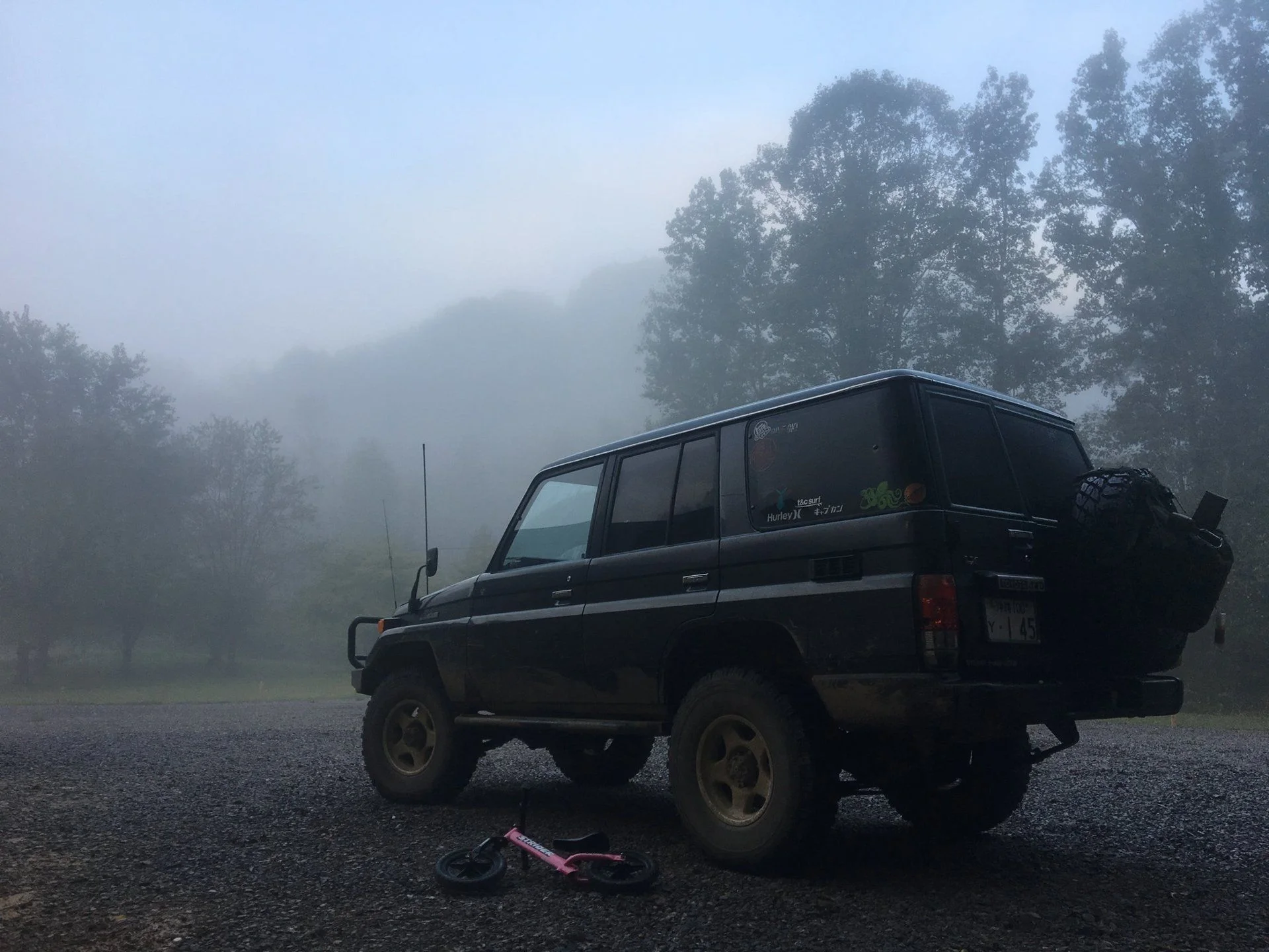

255/85r16 is a good tall/skinny basically a skinny 33”. I’ve got them on my 70 in the Toyo MT flavor. @jmlockwood has them in the cooper st maxx flavor.

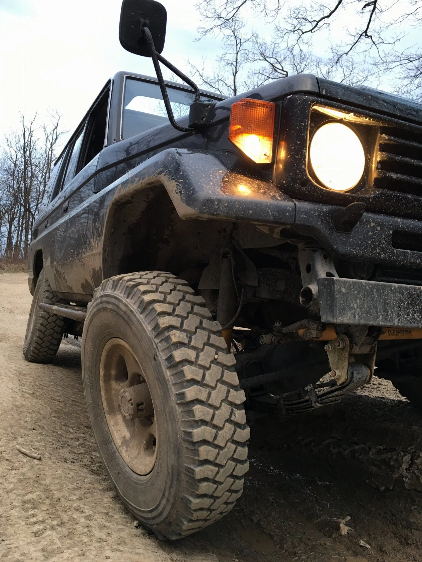

you can get used XZL’s in 8.25r16 from eBay. I had them for a while and liked them very much. It’s basically a 34x9. If you go that route be prepared for a rough ride as they are commercial tires. Ideal application is with a high constant load. They’re also available in a 9.00r16 which is a 36x9.
foreign markets have a lot of tall skinny tires but prepared to be turned away at a chain tire shop. I’d find a good local tire guy and table talk options for mounting.
8.25r16 XZL on the same truck.
