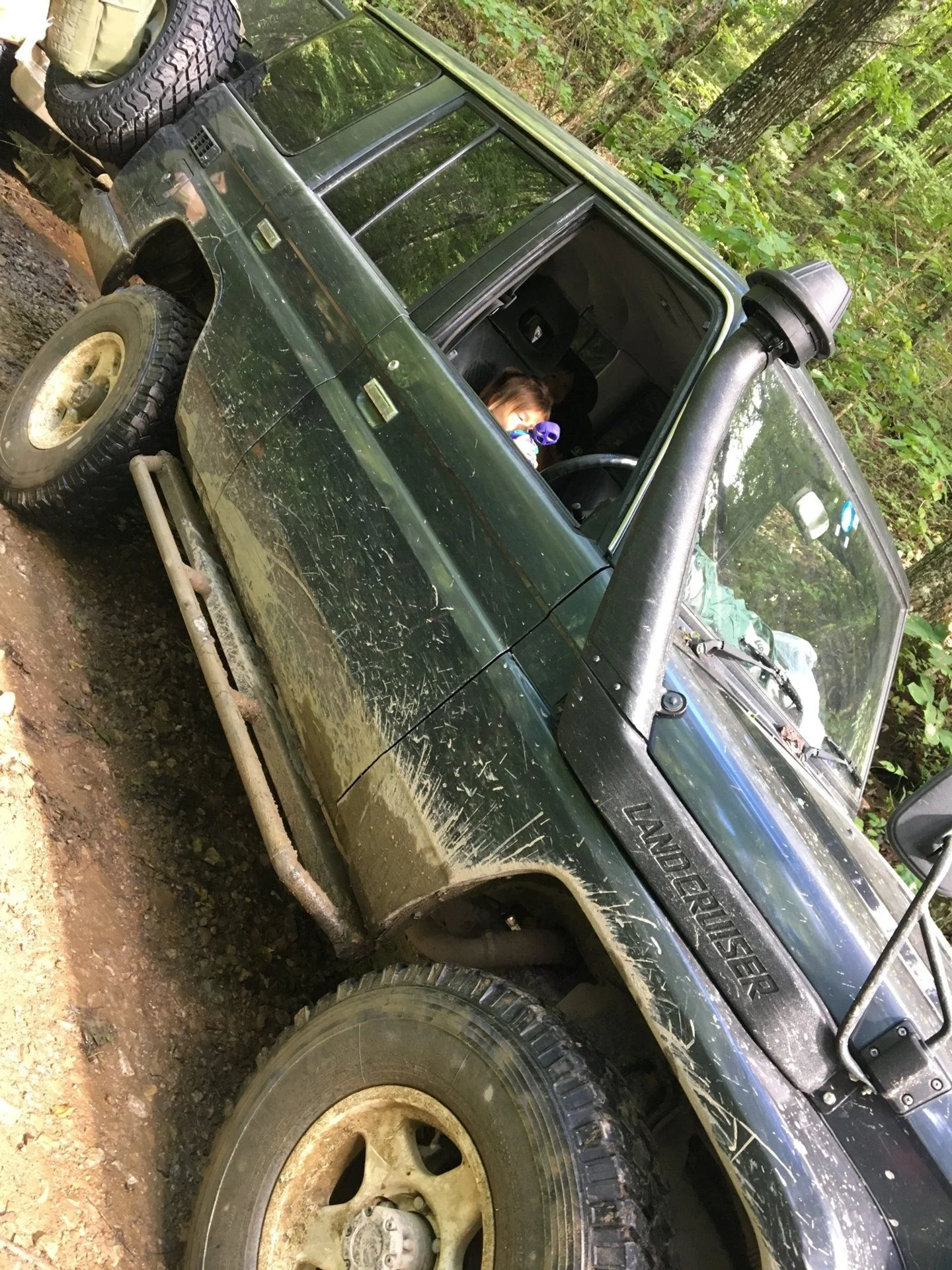

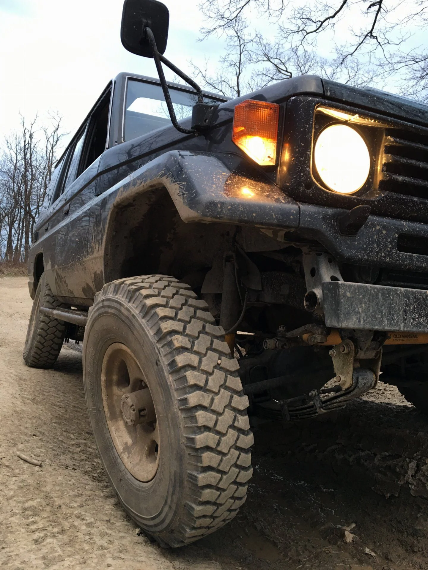

8.25r16 XZL on the same truck.
XZLs are DOT compliant. Not sure why people think they aren’t.
View attachment 2114674View attachment 2114675View attachment 2114676
