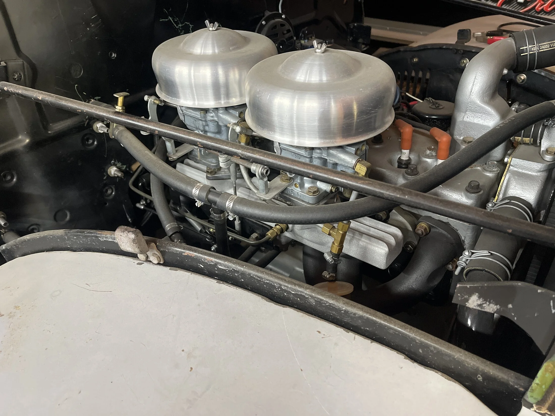

HELP! My late husband did a frame off restoration of a 74 FJ40. A Weber carburetor was installed by a friend a while back. I have had nothing but issues with this carburetor. The car is running like Sh*t (constantly backfiring, no power, stalling etc) and I am being told the carburetor needs to be rebuilt and gas tank emptied as the gas is old/bad.
I don't want to put the Weber back on the vehicle but I don't know what to look for on-line to replace it with. I have been looking for the original carb that was on the vehicle but cannot find it. When I go on to eBay, there are sooo many carbs in all sorts of conditions. Some are <$100 which seems like you get what you pay for. What do I need to look for? What should I avoid? I have been reading posts and see that Aisin seem to be the most recommended but they are hard to find.

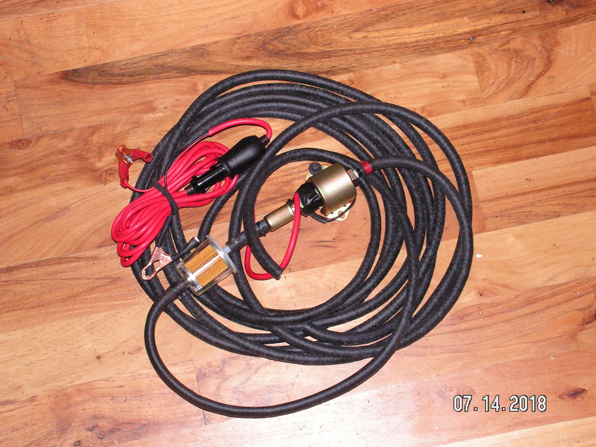

Bad gas will make anything run like crap. You can make an electric transfer fuel pump for like $50. Back in the 80's I did the alcohol resistant fuel tank liner program from JC Whitney to fix a seepy seam - still gas tight.

backfiring through carb? Did you double check the timing?
Webers can work good
Webers can work great, I have two of them on my 49 Power Wagon flat head 6 and run as smooth as can be. Running Holley Sniper on my FJ.
And valves mal-adjusted …
You will likely need a carb isolator/heat shield and an oem air cleaner as well if you go OEM.
All of a sudden it gets expensive to replace the carb just to find out it was something as simple as baselining.
I’d say hang on to the weber and work through all the other potential issues first. It all probably needs to be done anyway.
Consider ditching the points for a Pertronix and flame thrower.
New wires, plugs, fuel filter, gas dump/tank flush.
Do you know which weber you have? 32/36 or 38/38?
