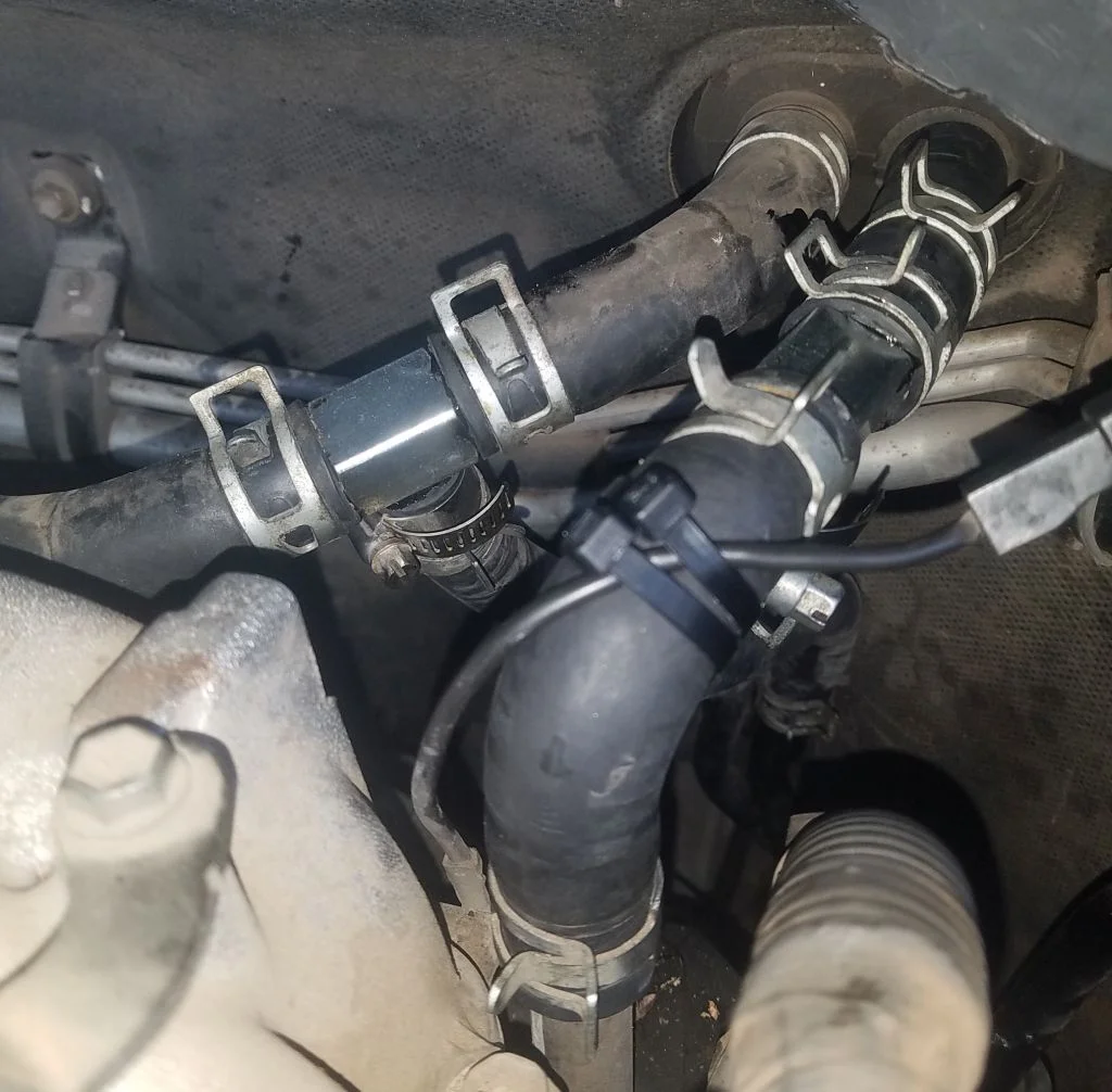

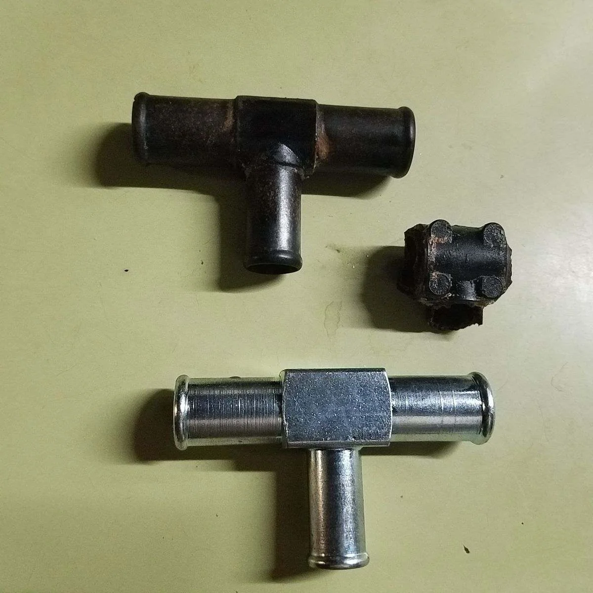

I noticed by accident some coolant deposits on one of the tee's so I ordered the metal ones when doing the timing belt. One of them totally disintegrated when removing it. I suppose I should do more routine inspections.
Those look like pretty good match for the metal replacement. worked with original hoses and clamps? Source?
Four Seasons 84543 Heater Fitting, Amazon, $13.69 ea. Dimensionally perfect replacement, uses existing hoses and clamps.​
winning :beer:
Edit: not quite perfect. The hose on the stem was a little loose, had to put a screw-type hose clamp on it. The larger hoses fit close enough with the Toyota clamps. The new Four Seasons steel Tee is 5/8x1/2x5/8"
vs the Toyota plastic Tee 17x14x17mm.
