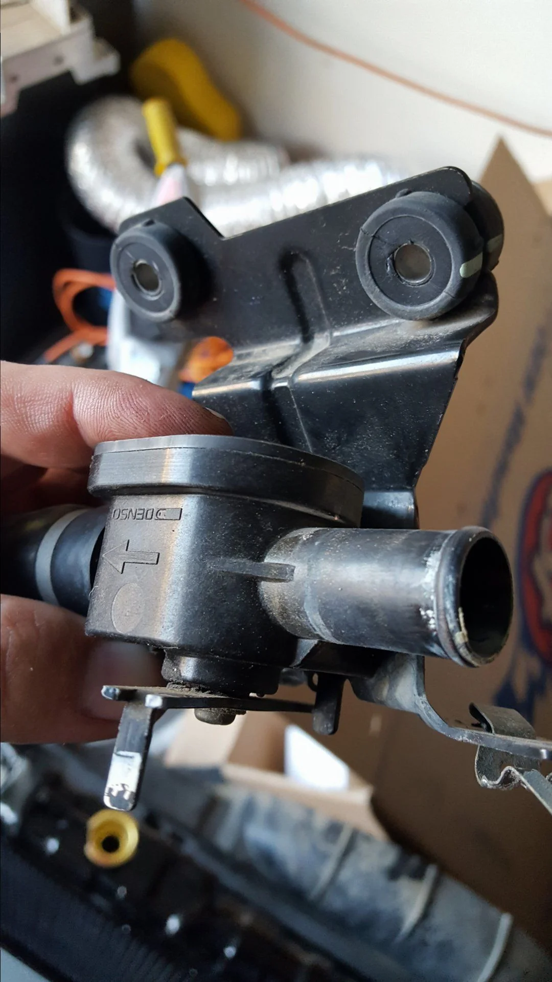

Just pulled my 23 year old crapper...looks like the damn thing would go 23 more! Replaced with OEM for the helluvit!
