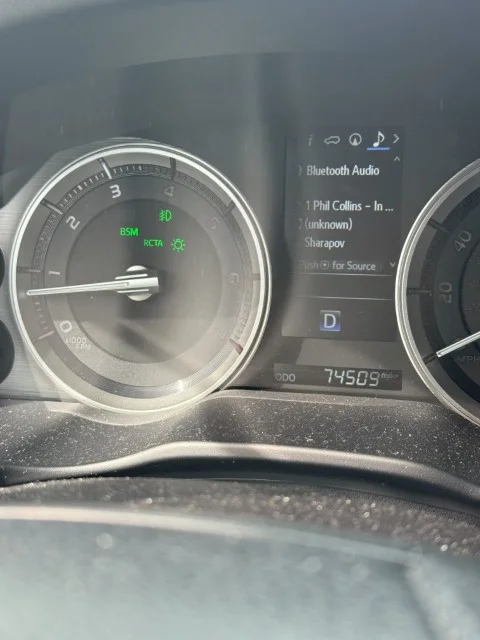

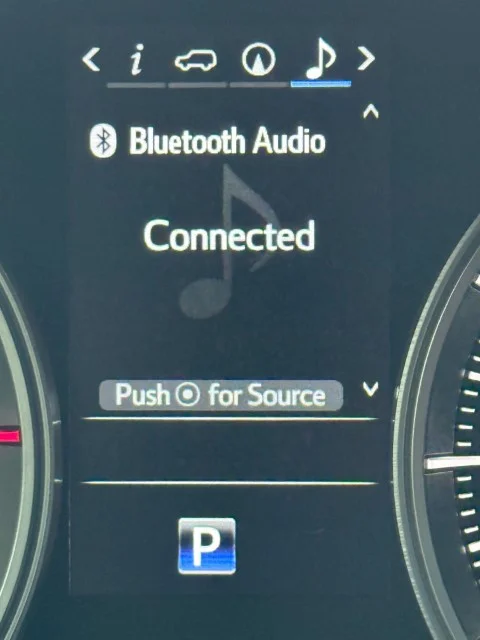

Guys, this is super weird and I can't seem to find an answer. My instrument cluster sometimes displays the music tracks and sometimes it doesn't. It goes months working just fine then all of a sudden it only shows connected. I've asked at the dealership and of course they can't find anything wrong with it. I've unpaired, repaired, restarted, any idea what could be causing this? This is a first world problem, but I want my instrument cluster to display my music. Any idea what the problem could be?

What phone?
Have you tried a different music source?

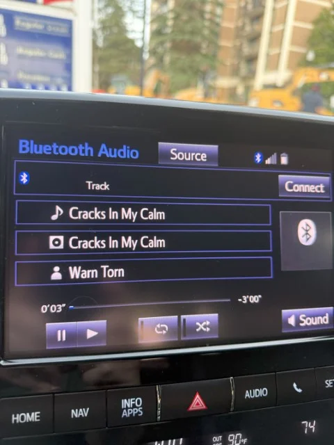

I don't have the display in the cluster, just on the big screen. Occasionally mine will also stop showing the track info, but the music is still playing. I've also found changing to a different playlist will fix it. I use YouTube for music, my phone is a Pixel 9 Pro.

What phone?
I just tried a different source and it works fine (spotify), super annoying that YouTube Music is so glitchy with it's connection.
What phone?
I phone 16, I tried a different source and it works. Something about YouTube Music just keeps glitching.

Agreed that YouTube Music is inconsistent. Just this evening I got in my truck to come home, no track info. Had to stop to get gas, now it's fine. Weird.
There has got to be a way to fix this. It's absolutely inconsistent. Same thing has happened to me over and over.
I just realized something. When I play my favorites playlist, it doesn't work properly. When I play any other playlist, it works fine. I guess it must be an issue solely with the app. Maybe my LC doesn't like my music??
