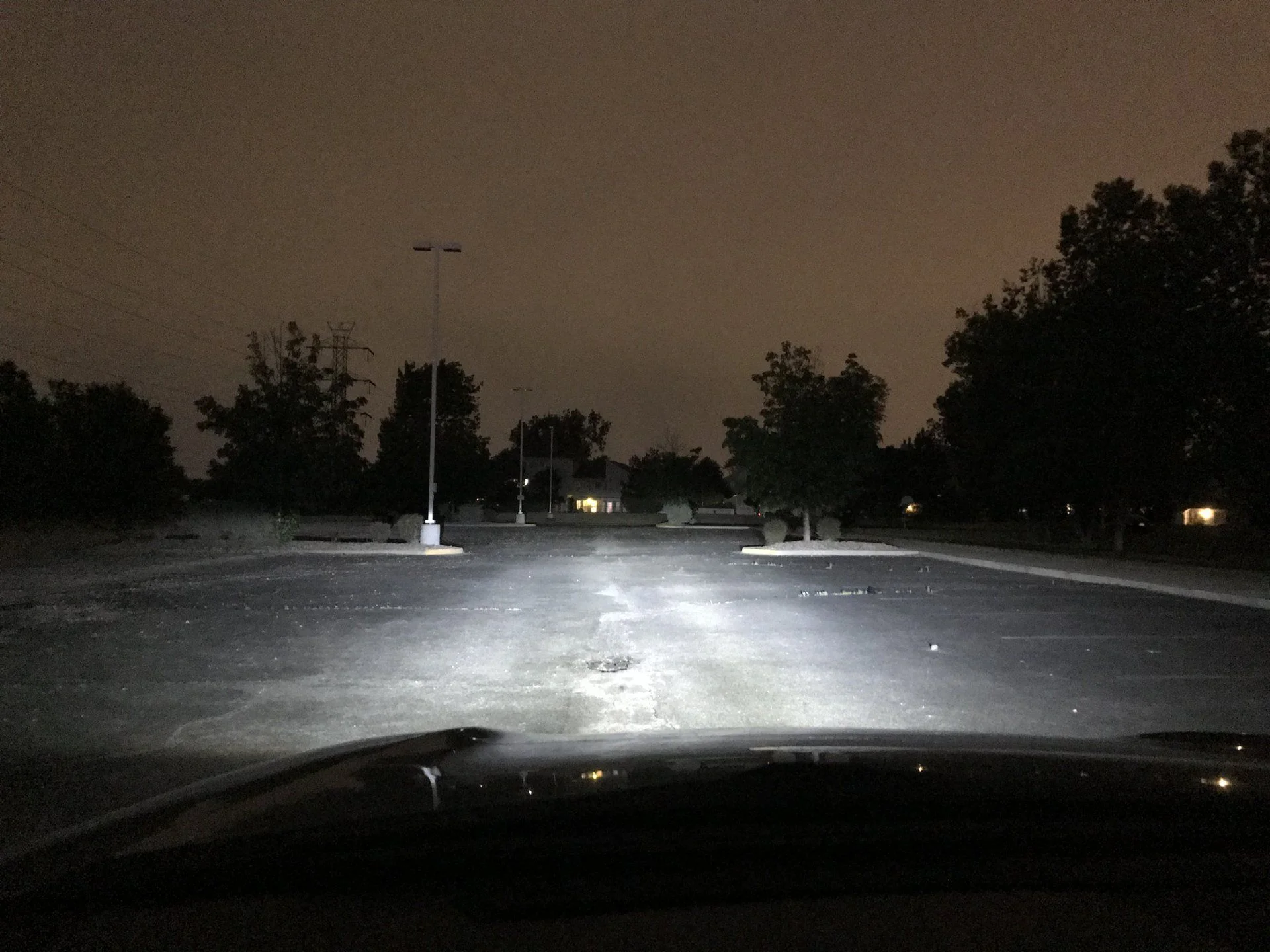

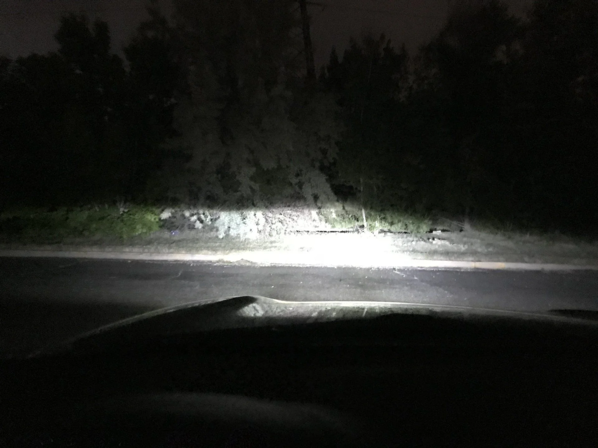

I swapped in the Hikaris into my LX and have been very pleased with the results. It wasn’t super dark, but I snapped these pics tonight. The driver side needs to be adjusted still, but even so the beam pattern is nice and the color is good. Very happy with the performance for the price.

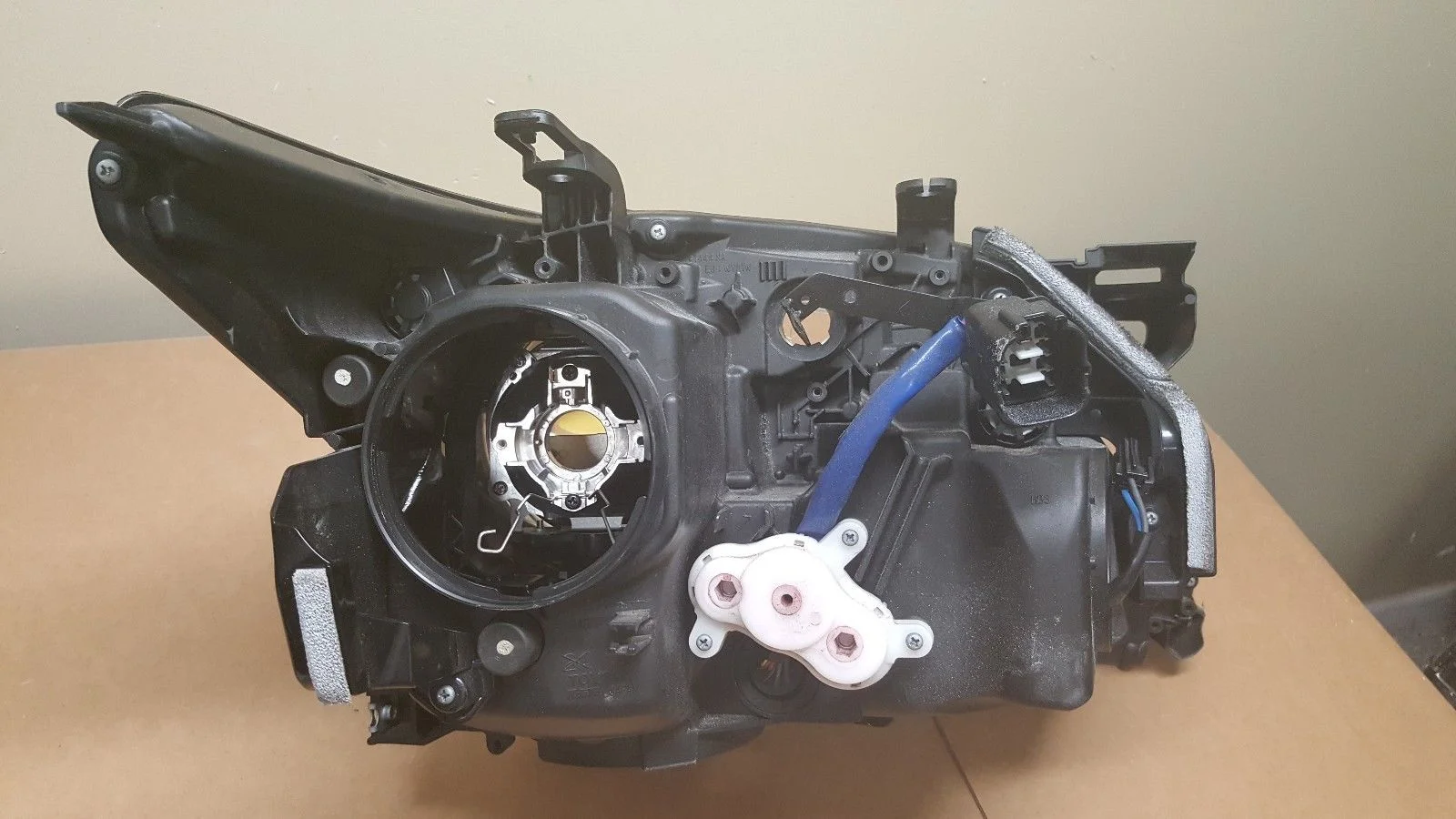

I read the below thread, then experimented. On mine I just had to turn the hex screws in white plastic body below. It's key to find a perfectly level surface and a nice flat wall to project against. After you get it dialed in, make sure to notice where the headlights hit people's rear and side view mirrors (I drove up behind parked cars on the side of the road to ensure it wasn't going to be nuisance) and make sure it doesn't blind oncoming traffic. It took me a couple of times to get it perfect, but it's worth it.
Headlight Aim - ClubLexus - Lexus Forum Discussion
