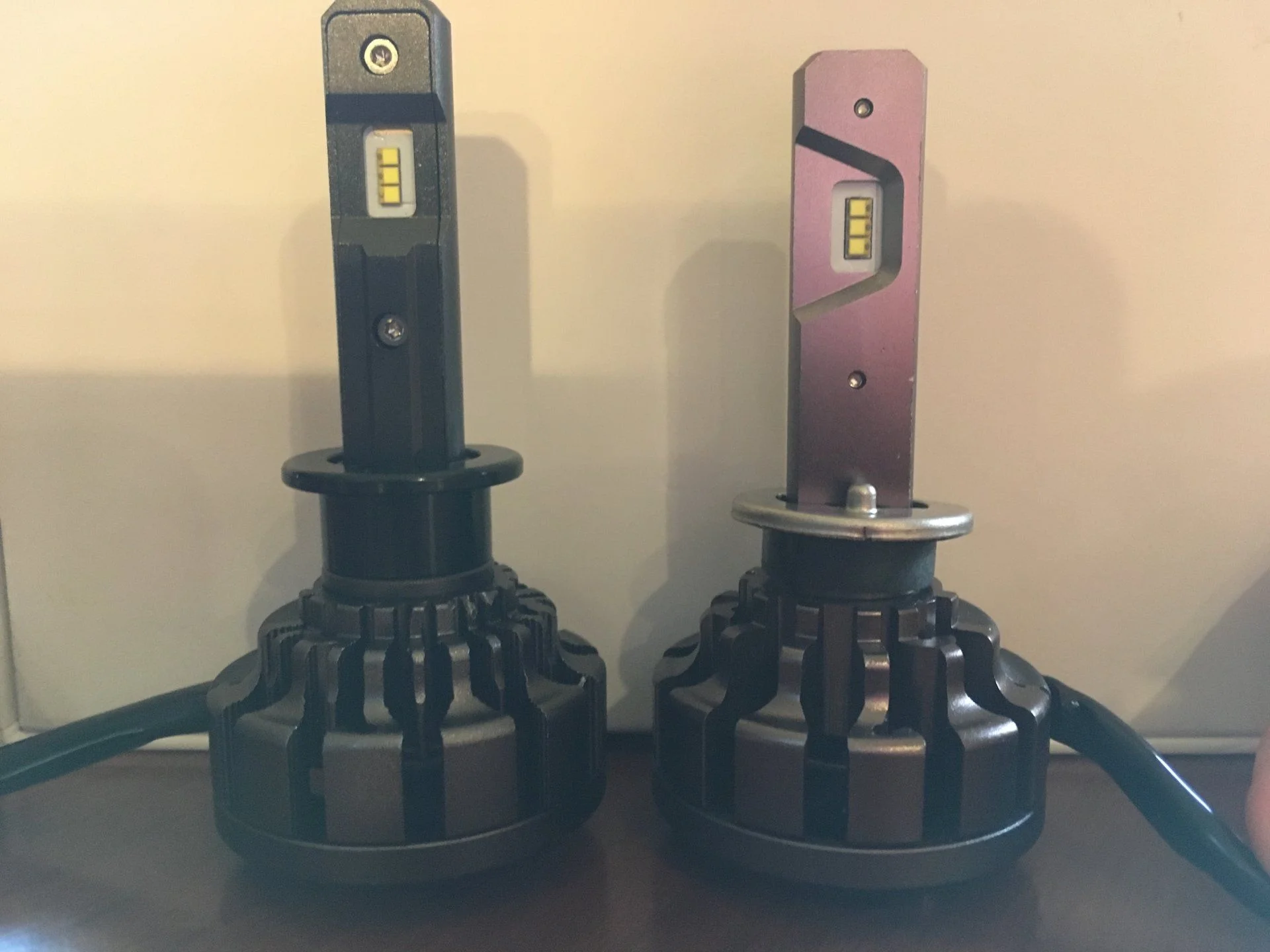

The only issue I have had to date is both H1s burning out in our 2007 LX (within 4 weeks of each other). Hikari's customer service told me they had not changed the design of their H1 bulbs, and replaced them under the terms of their 2 year warranty. If any of the H11's fail, I'll be sure to post a photo of the new and original bulbs side by side.
Just as a data point, I'm attaching a photo of the original and current H1 design side by side (original H1 philips design on the right) Not a thermal engineer, but it sure looks like cooling may be the culprit in at least the original H1 design. Will post the cap modification once I have the time

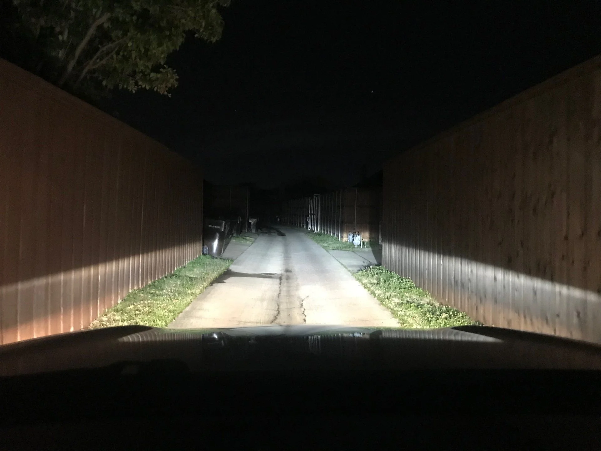

I just picked up a new-to-me LX570 and found this thread. The OEM headlights, while having good beam patterns, was severely lacking in lumens. I could see better with my LX450 with LED bulbs and Toyota fog lights.

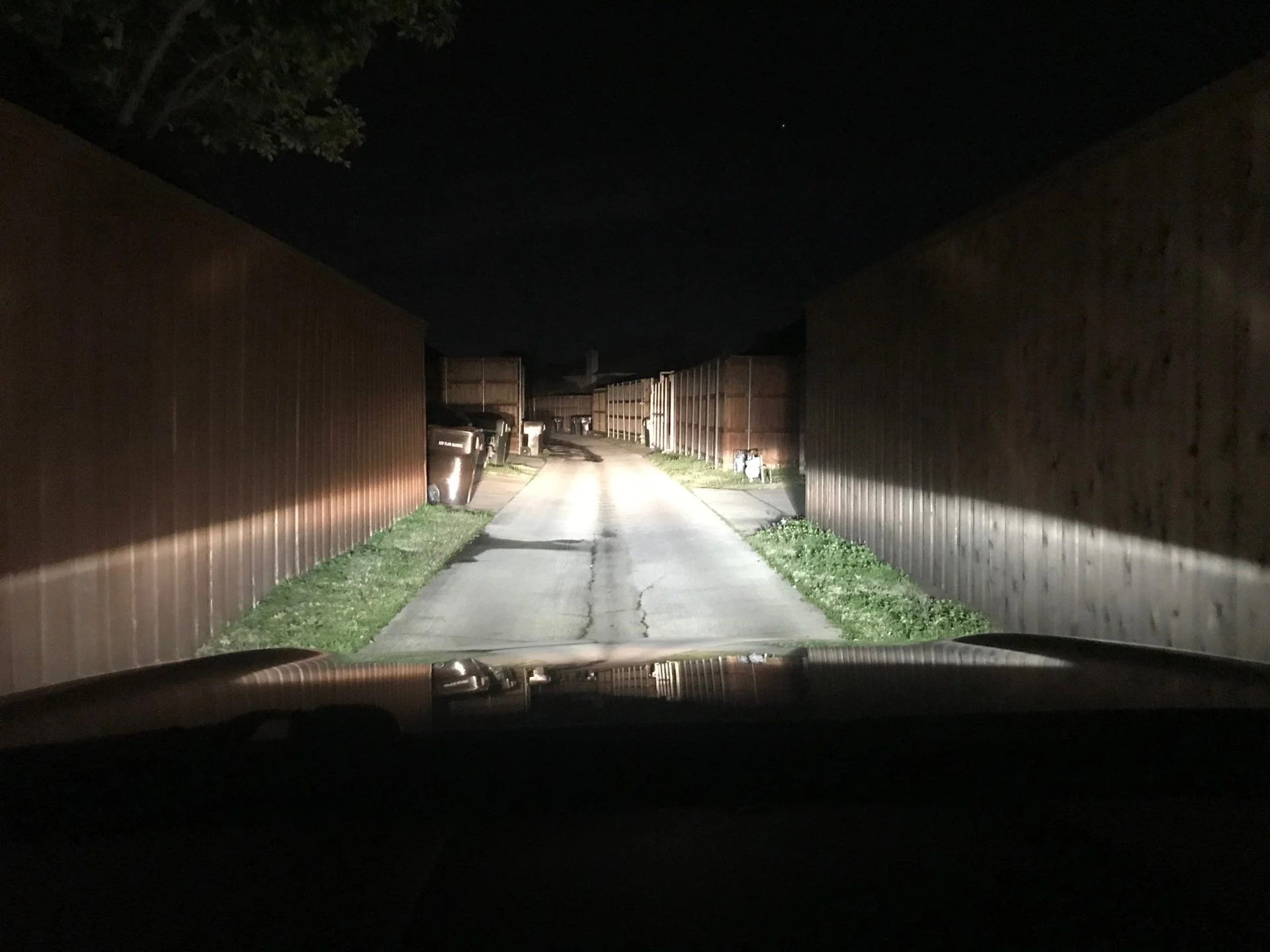

My first mod was to replace the low beam with the HIKARI Ultra LED Headlight Bulbs with the Philips LEDs. The result was excellent light output while retaining the beam pattern and the AFS functions. Here are the resulting pictures:
1. LED low beam
2. LED low beam with OEM incandescent high beam

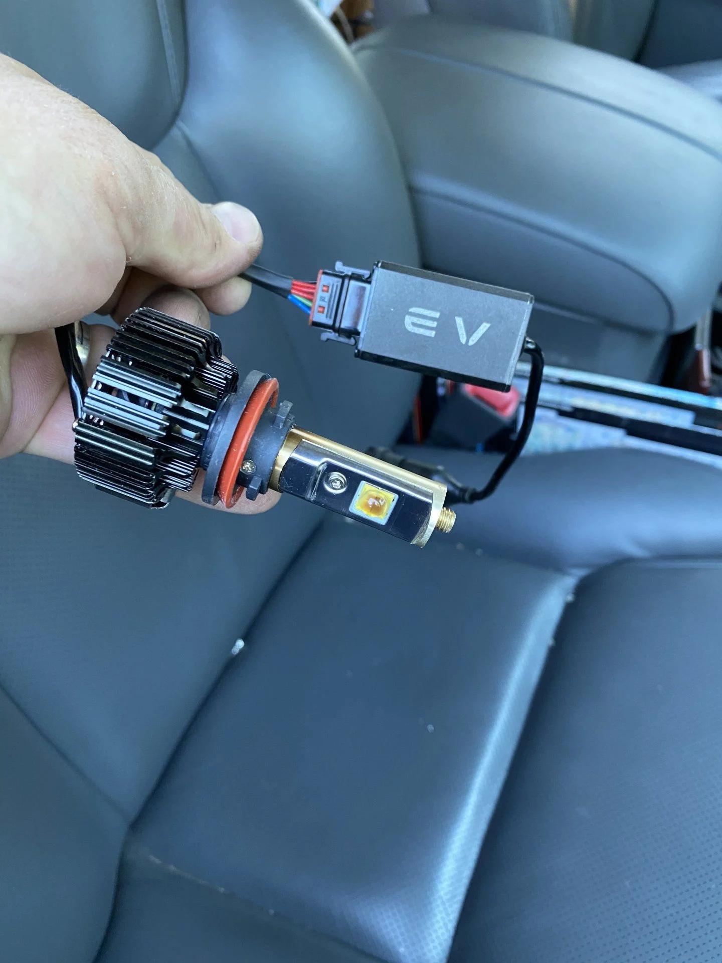

I just purchased and installed the Hikari "eye of megatrons" in my 2009. Can confirm that they are too long and do not work with the stock dust covers in place. AFS immediately throws a code as soon as lights are turned on. Removed dust caps and AFS works perfectly. Going to either try to rig something up or return them for a different bulb. Light output of the low beams is pretty good compared to standard halogens.
I think maybe you have a different bulb or maybe they changed the design.
Working fine in my 10, do you have wires and module hanging straight down? First time I installed, wires were to side and it affected AFS

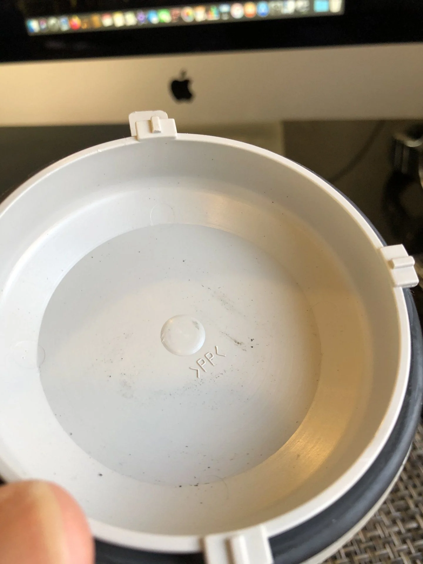

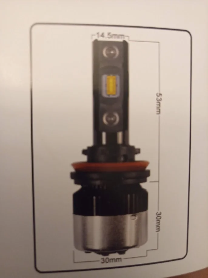

Here's the model number on my box. Doubt you guys still have the packaging for comparison but I'm guessing something must have been changed. The wires are hanging down just like when the stock halogens were in there and AFS works perfectly without the dust caps, so I think this bulb is just slightly longer maybe due to a design change. To test the fit, I marked the very end of the bulb with a black dry erase marker and installed the cap. Sure enough the cap touches the end of the bulb just barely as there was marker on the dust cap.

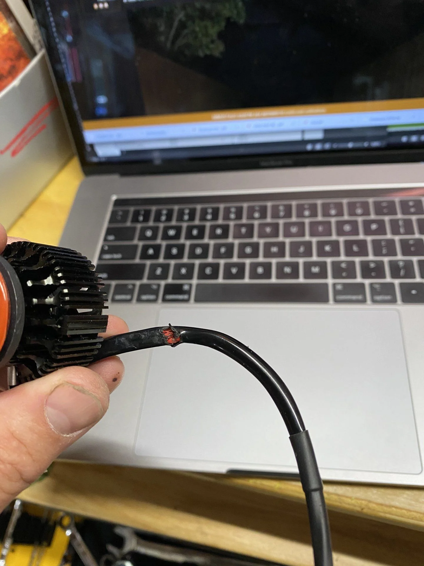

My passenger H11 (low beam) just failed. I am getting a new set under warranty.

Both my pas side Head and for light went out. So I decided to replace all the options posted here.
This is what the PO had put in. Not sure what they are or how old they are.
I think a found the problem. Not sure if the rough roads on the WABDR did this or if it was the AFS constantly trying to work. I will make sure to take more care than he did.

Hello everyone, this is my first post! I read through everything and ended up getting the same ones that the last poster got (see pic). I spent a little extra on the high beams and noticed that the more expensive bulb is actually 3mm shorter than the less expensive H11. Like the last poster noted, the H11 low-beam bulbs hit on the cover and caused the AFS light to flash. I tried to find a cover that would allow more clearance and tried the rubber boot type cover, but that didn't work because the plastic ring around the rear housing is interrupted with a flat spot that won't allow anything to slip over it. I then went back to the drawing board and lucked out with a part from LASFIT: LASFIT DC1012 These can also be found on eBay for less. They are direct replacement with extra clearance. Loving the brighter whiter light of the LEDs and now just waiting for them to fail haha. I also used the same H11 bulb on the fogs and replaced the "city" light with a cheapo for now. Thanks to everyone for pointing me in the right direction on this little project. I am now wondering if anyone has done switchbacks on the front turn signal? It looked a little tricky to replace. Let me know if anyone has any insight on this -Thx!

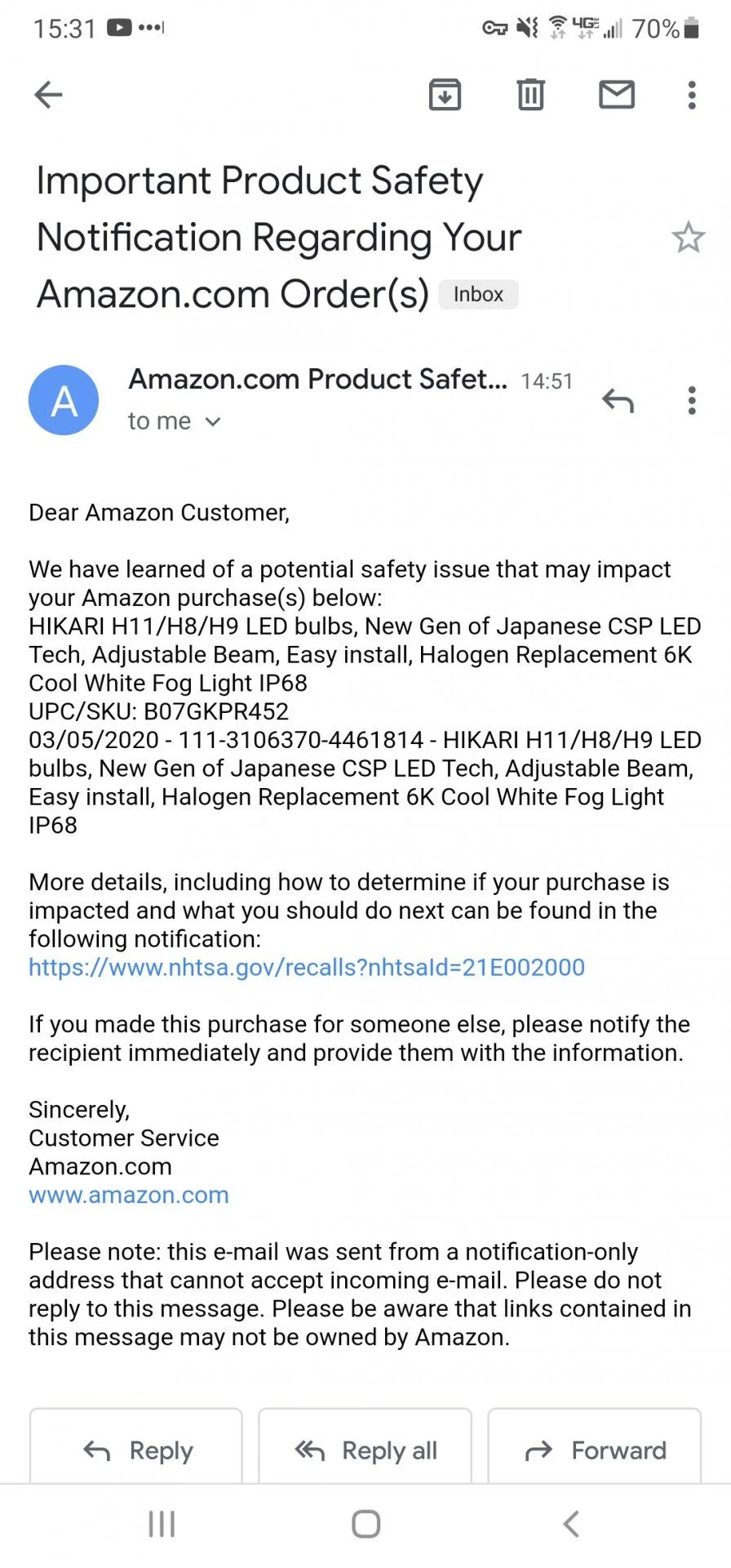

PSA... I just got this email from Amazon. Essentially, it says the Hikari bulbs are too bright and I'll be offered a replacement halogen set.
This is the link in the email Check for Recalls: Vehicle, Car Seat, Tire, Equipment - https://www.nhtsa.gov/recalls?nhtsaId=21E002000
