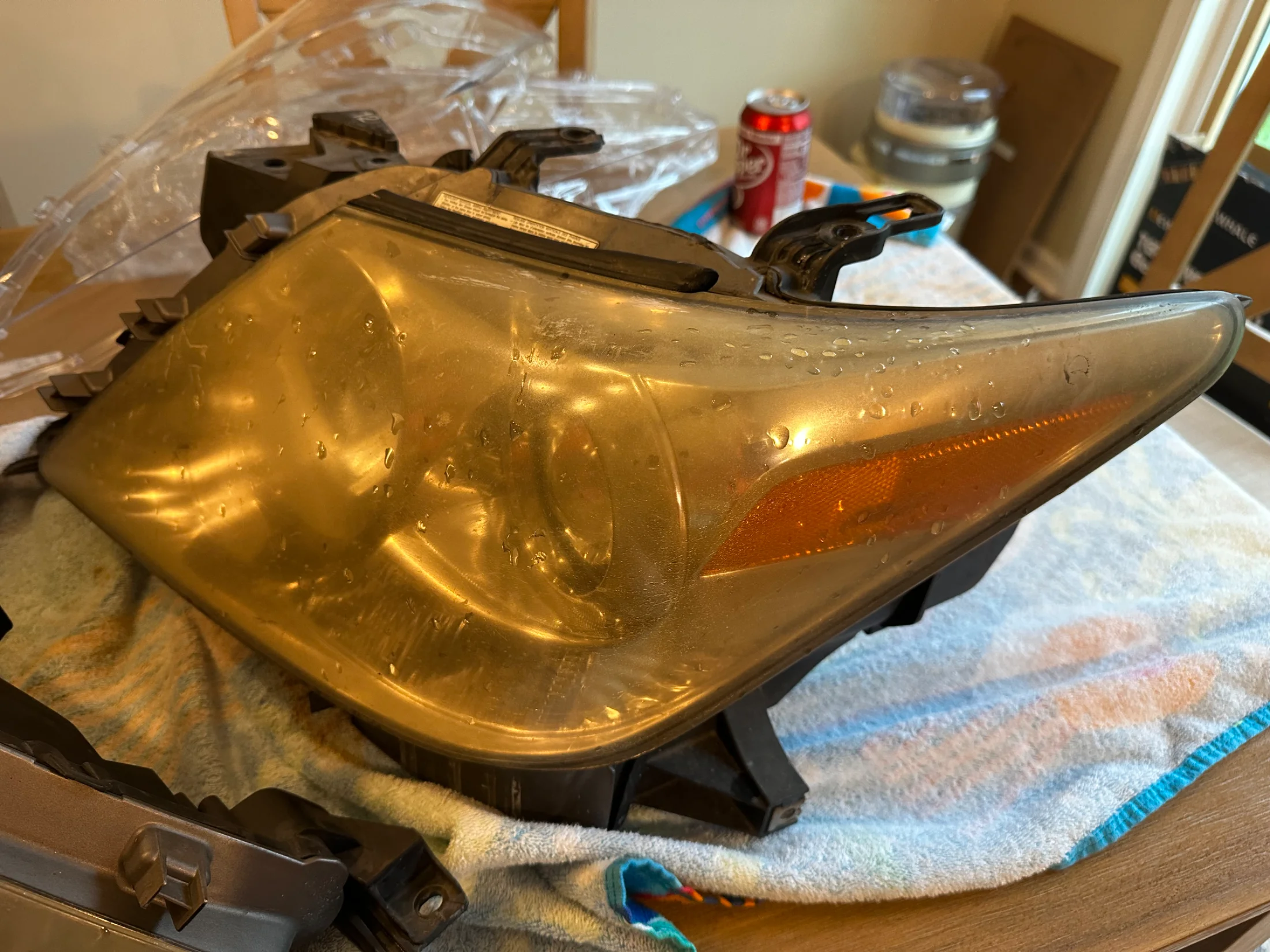

Sweet! This certainly solves all my qualms with wanting to pull the trigger. Admittedly, I am just buying some crappy lenses off of Amazon for ~$80. I am not thinking they'll be incredible quantity, but my current ones are so yellow, cracked, and fogged over. They're just toast!! I am currently debating paint/clear on some of the inner pieces since I will have the housing open. I may come back to this thread soon, as I still am a little uncertain on what HID bulbs/ballasts I need to get. Lighting is new to me.

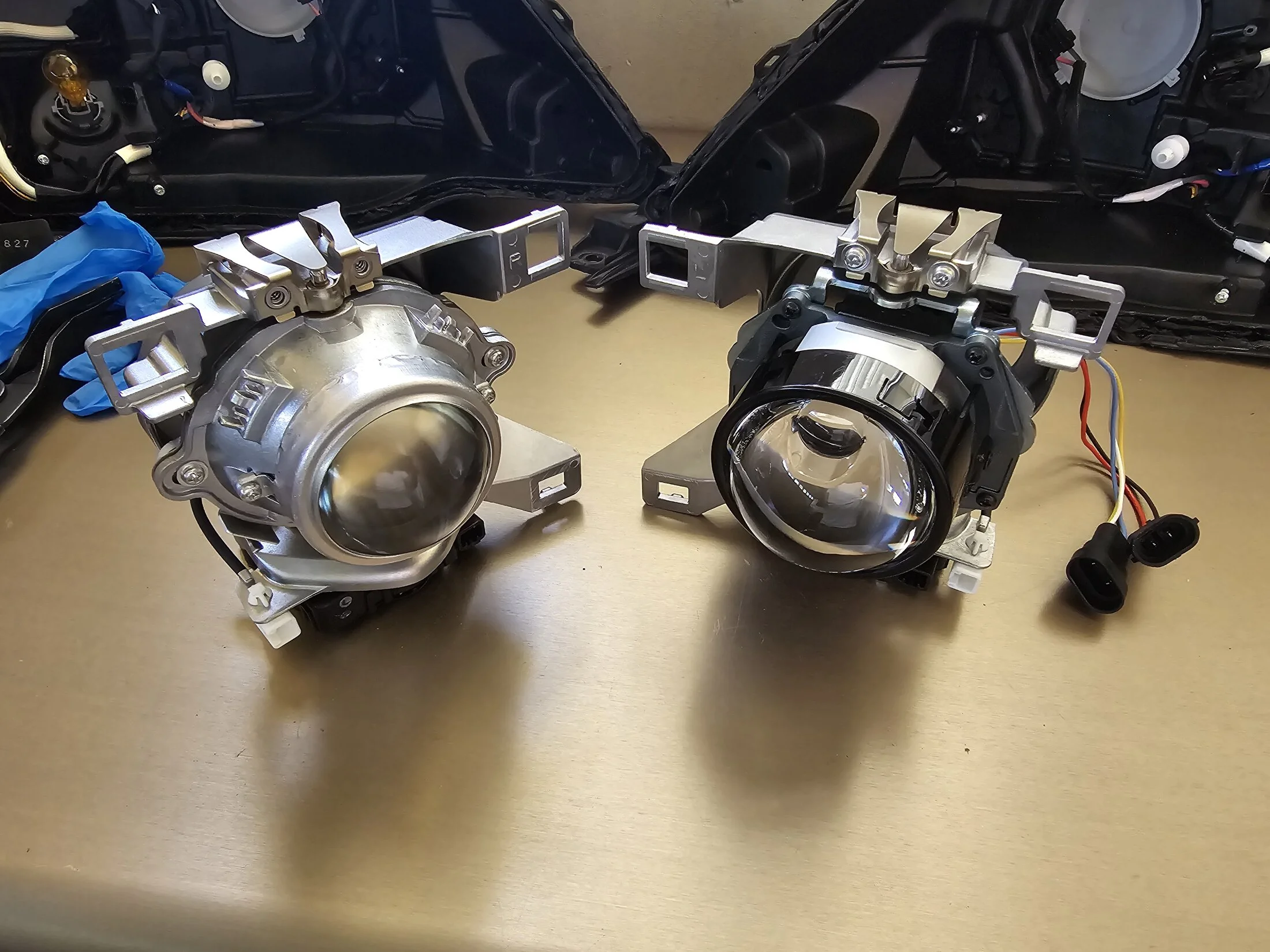

My thread may help ya in the future. Truthfully, I wouldn't consider most of this thread a "retrofit" since there's really no modification required, just a bulb swap. If you truly want great output, look into proper Bi-xenon or Bi-LED projector retrofits.

I’ve actually been scouting this thread for weeks. What you’ve accomplished with bi-xenon is great! Truthfully I’m just so new to headlights and the process, that I’m not sure I should undertake it to that level. My biggest concerns would be: what parts I need to buy, overall cost increase (how much did new shrouds and rx350 projectors cost?) and the inability to replace with new housings if I mess up my headlight somehow. The 4 bolt modification to get the 2nd projector in looks like there is room for error that I’m not sure I should follow through with.
I can definitely understand the hesitation. The second projector is not for beginners but just to show what's possible.
Cost would depend on HID vs LED. I'd be happy to put together a bundle of everything you'd need and price it out for ya. I'm a dealer across most major brands. It would likely add 300-350 but output is significantly better (and it's really the only good way to do so).

The funny thing is my current lens are so bad that even just swapping those out would give me 30-40% of my light back!

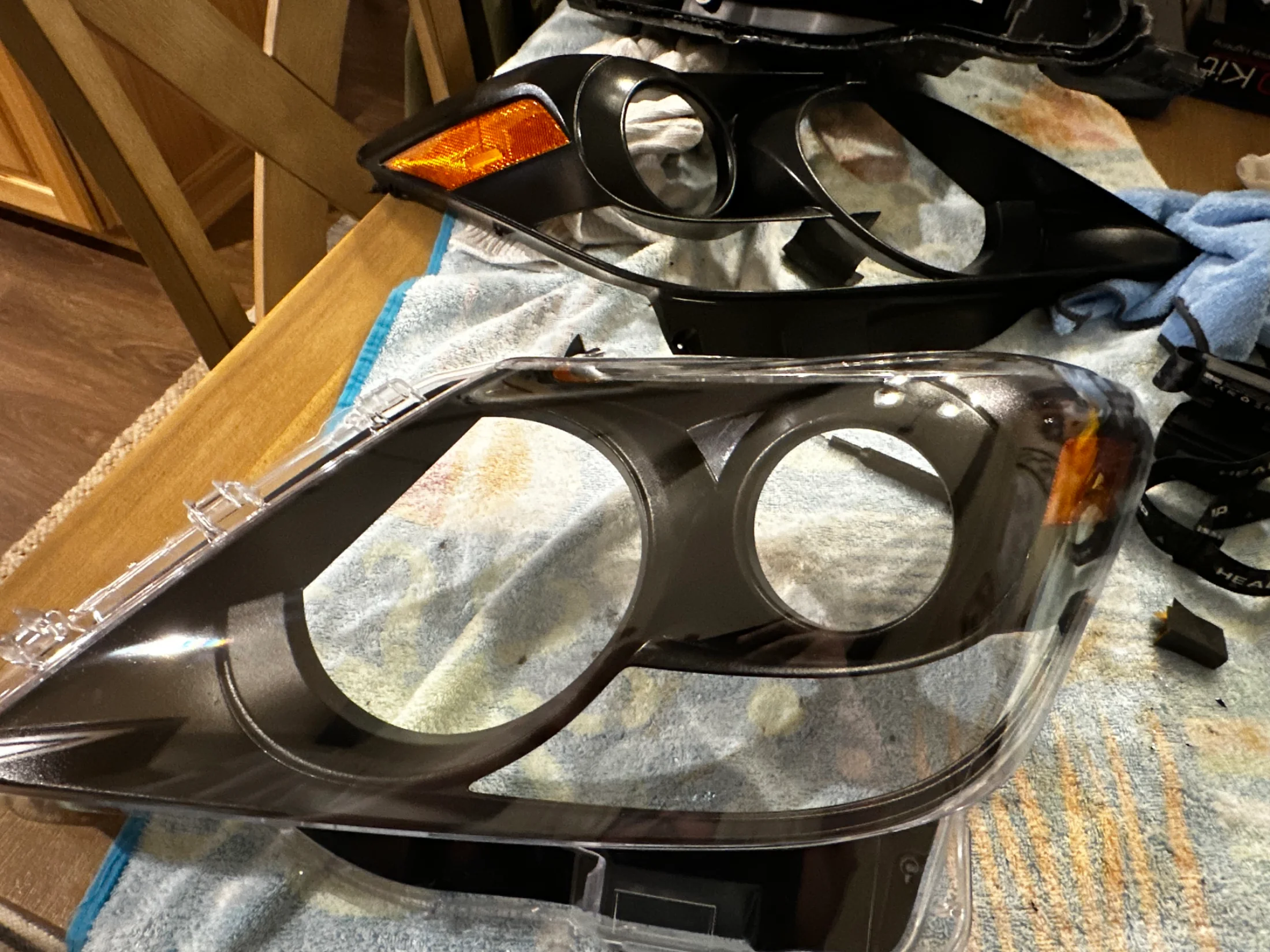

Well, finally got around to getting this project completed. 2 sets of lenses never delivered. 3M film package was stolen. The whole thing has just been seriously delayed over and over. But it is done!
Bulbs:
Low beam - DDM Tuning 35w 4300k
High beam - vLEDS V50 monochrome (would not recommend, they are too large and I had to file the housing to get them to fit, great light output though)
Parking light - vLEDS amber
Turn signals - Morimoto XB LED w/ built-in resistor.
Photos show my old housing, new clear lens with surround painted black. And reinstalled back on the car. I’ll likely take some more photos tonight with the lights on.
Completely worth the time effort and money. So far no one has flashed their brights at me for the DDM kit, no chance I would use the high beams with other people on the road
Fog lights were left untouched because a front bumper will be in my future.

How hard was the process of splitting the lights to change the outside lense? Mine aren't quite as 'misted' as yours looks in the photos, but it's definitely something I'd be keen to replace. Also, where did you source the lenses?

Honestly, if you’ve got a regular sized oven and basic tools to disassemble the bumper. It was not bad. Patience is the key with an older car as the butyl rubber can be a bit finicky to work with. But as someone who has barely ever changed their own oil, I think this is a project most people are capable of doing! Put the housings in the oven at 200-220 for 15 minutes and it’ll pry apart. (Make sure to remove the 8? Or so screws holding the lens to the housing. And try your best to clean all the old rubber out for a clean finish on reinstall.
I found my lenses on eBay ~100 shipping included. 10/10 worth it.
