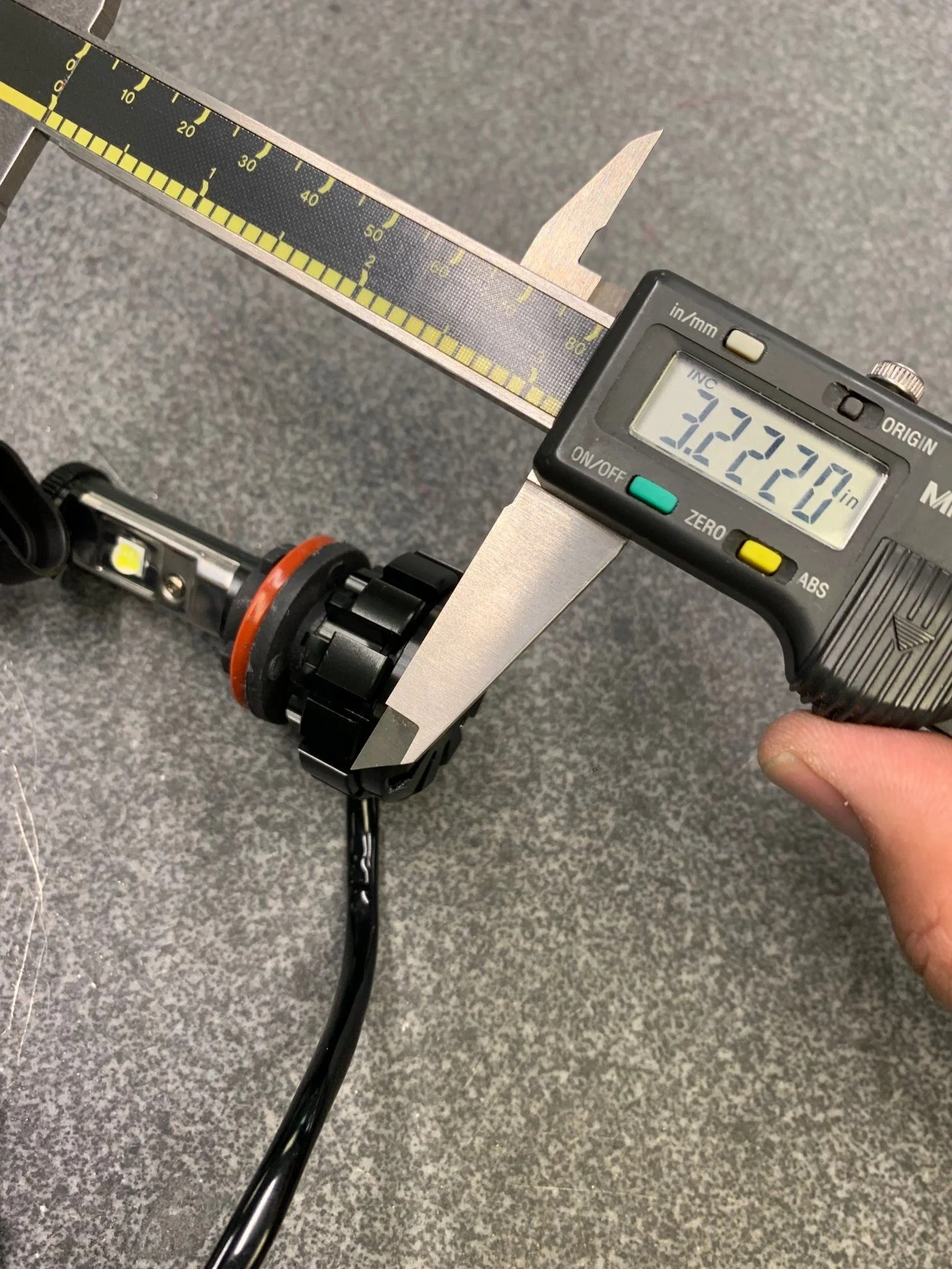

Here are the caliper measurements:

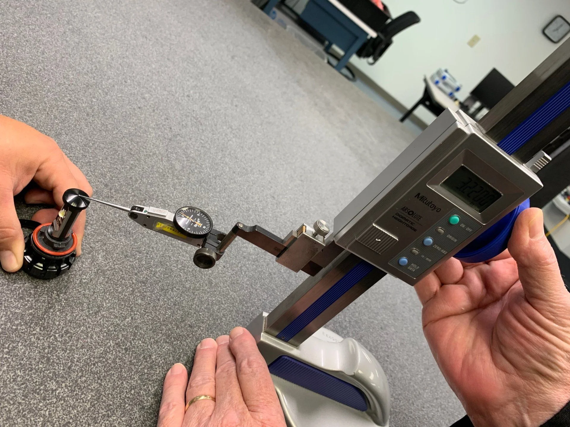

Verified with Height Gauge:
