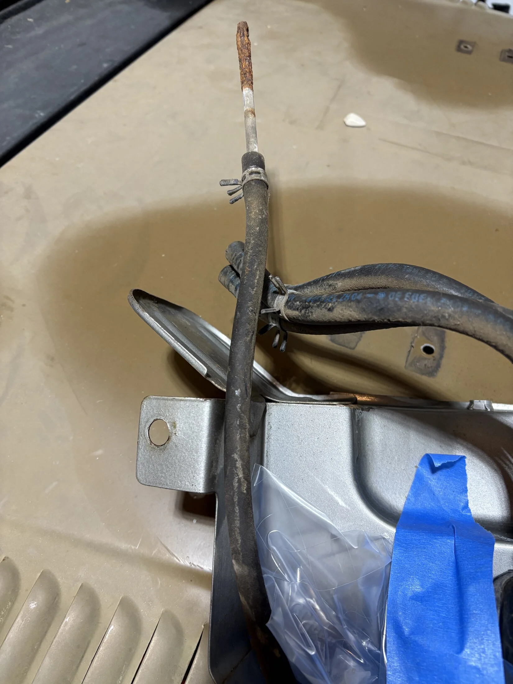

I've searched a bit, and can't seem to find where I can source a replacement hard line that goes from the upper hose in the fuel separator, through the body, along the underside of the body over to the rocker panel, then to the charcoal canister. Does anyone sell those? As you can see, I don't think mine has been working. Ha. Also, for those of you who have used an Aqualu tub, how have you secured this hard line under the body? Thanks.
Not a purest so I would just get some soft copper tubing that you can bend by hand to form it to fit. Seems like you could bend a tab around the tube, drill a hole threw tab and tub then attach with a pop rivet.

To secure you can use one hole SS vinyl coated clamps that go around tubing.Use the bolts that hold your step on to secure them.Could use brake line and bend to make new tubing piece.
