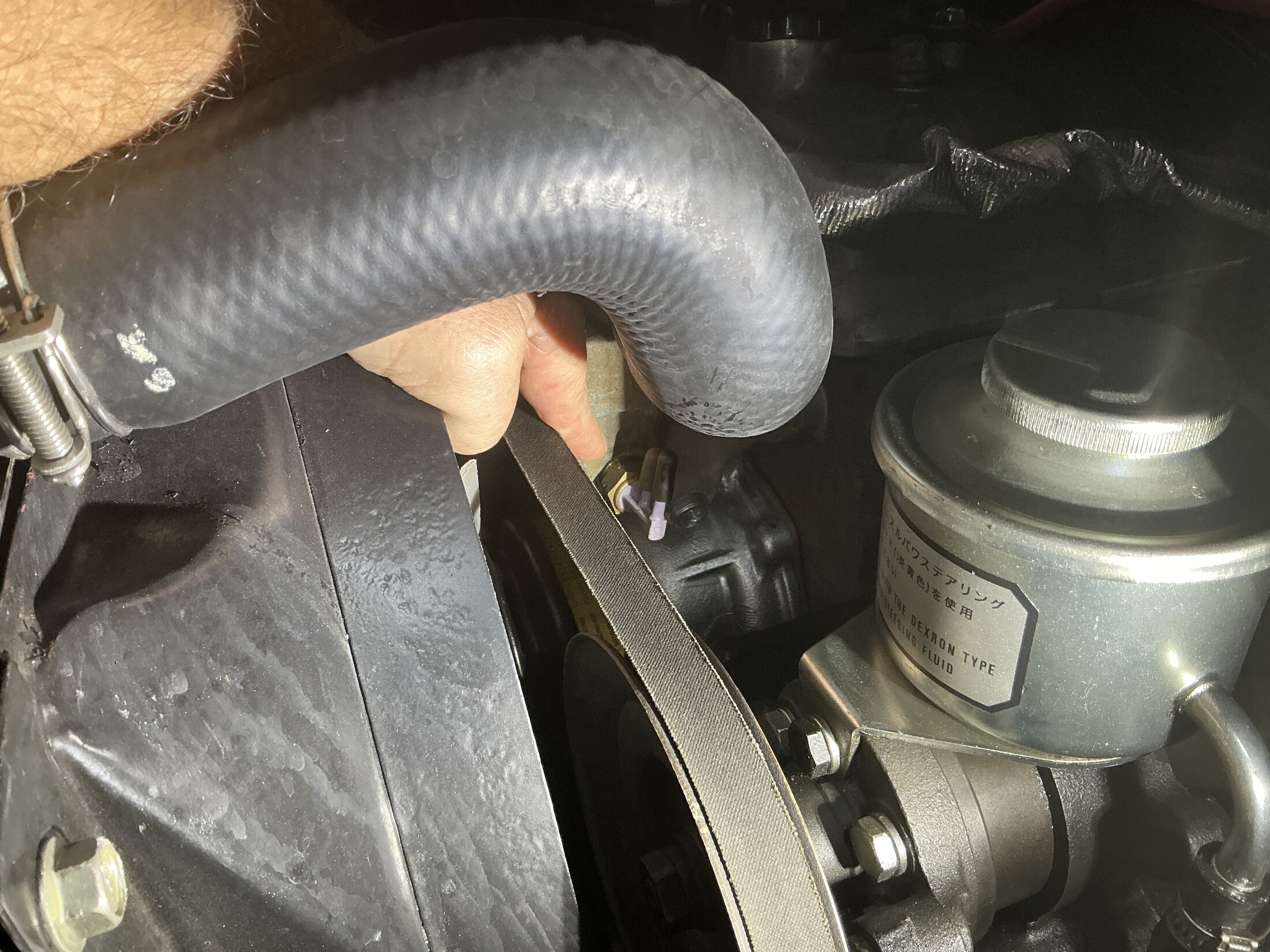

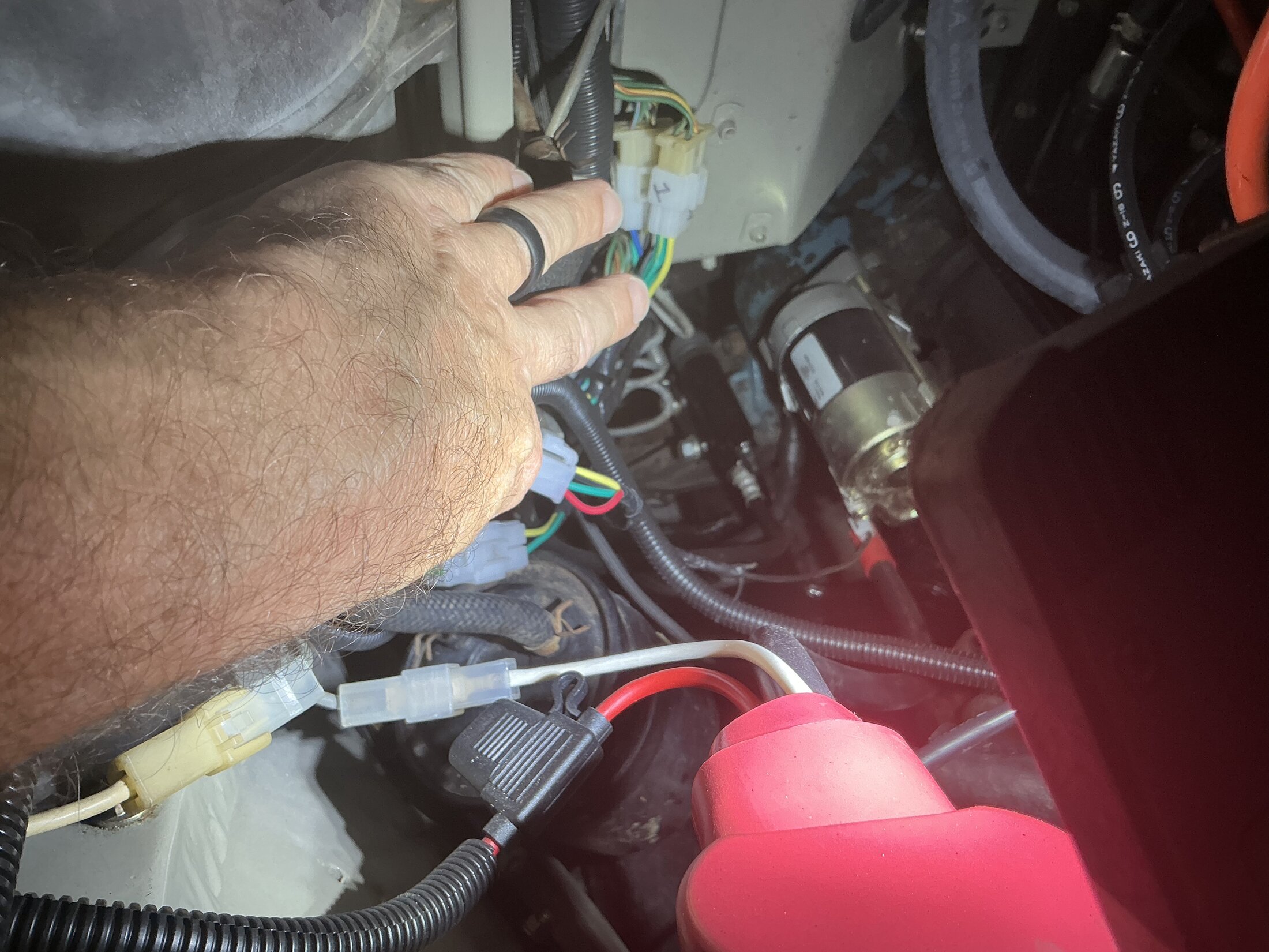

Some photos…
Here I’m holding back my ultra-cool plug-in trailer wiring harness (Coolerman) showing the charcoal canister output hose that goes to the hard line that crosses the firewall.
Now I know why I can’t find the BVSV on my bench. I forgot I had installed it! It’s the purple thing that has two caps on it.
My charcoal canister line terminates at this filter. The empty black bracket behind it is for the VSV. It’s off a 60 series I think.
