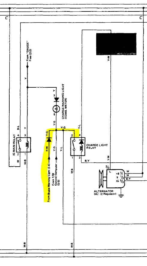

I had the same issue. I spent hours chasing it, but never found the cause. I definitively ruled out the hand brake switch/circuit, so it was something in the charge light circuit that was causing it. My guess is a failed diode, shown directly above the charge warning light in the diagram below and/or between the light and the brake warning light.
From what I understand, when the alternator is charging, it sends 12v on what would normally be the ground for the charge/brake warning light. If the alternator stops charging, that wire instead serves as a ground, and the light turns on. So my guess is that there's a fault to ground somewhere, or some diode isn't doing its job, so the light is always grounded and therefore always on.
My ultimate solution was to remove the bulb.
