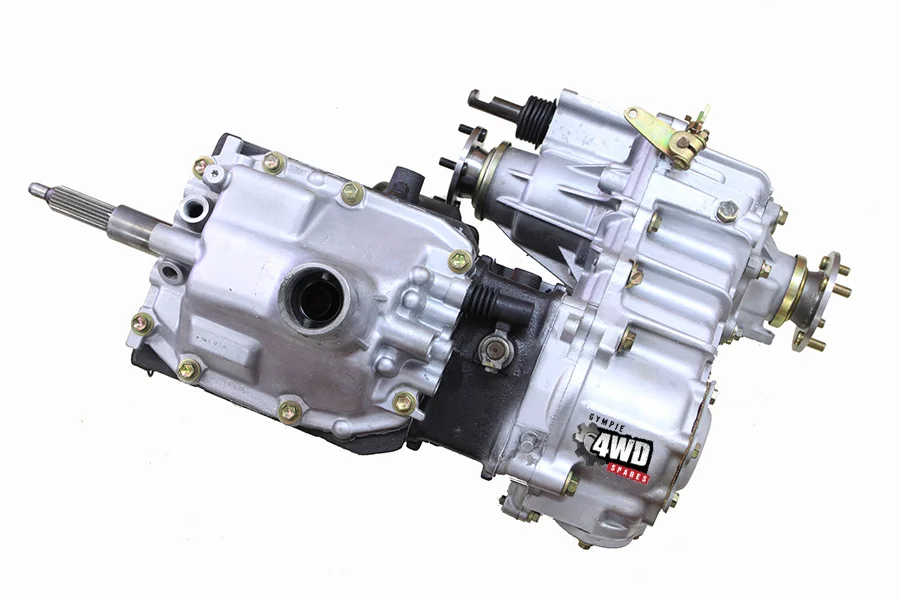

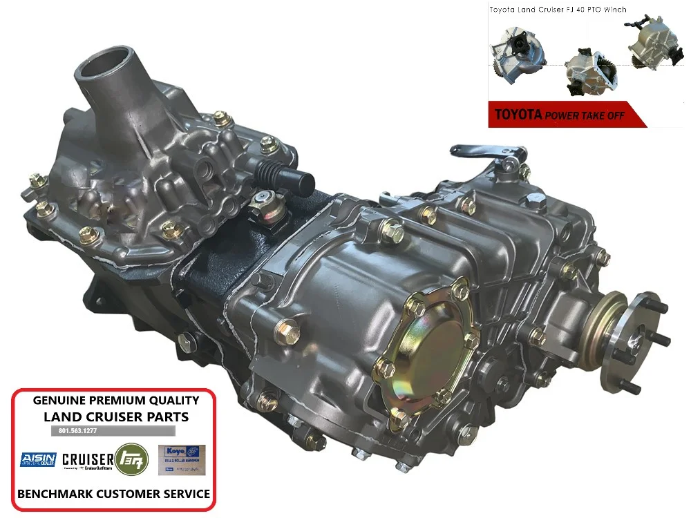

@TOM HARRIS : Where are you in CA--NorCal maybe? Mudrak (Sonoma) did my swap in 2022. Valley Hybrids (Stockton) is well versed in the swap. And there is Trail Tailor in Redding. You can confirm your transmission already has the spacer between transmission and transfer case, as shown in the pictures above. With the space your existing drive shafts should work without changing lengths. And the transmission cross member should also be OK. You do have to take the transfer case apart to separate it from the transmission and there are a few minor changes (bolt lengths, 5th gear oiler) that need to be addressed.
