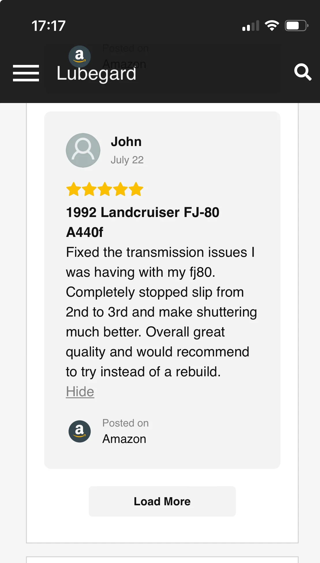

You might consider adding some Lube Guard. The black bottle. I’m not really a proponent of additives in general, but my buddy swears by it and I guess it’s pretty well regarded in the transmission rebuild industry… which he began in when we were in college 30 years ago. You prob don’t have anything to lose, and maybe you can report if there’s any real world benefit.
Highly Friction Modified ATF Supplement - Lubegard - https://www.lubegard.com/products/black/
Fwiw… from that link above:
