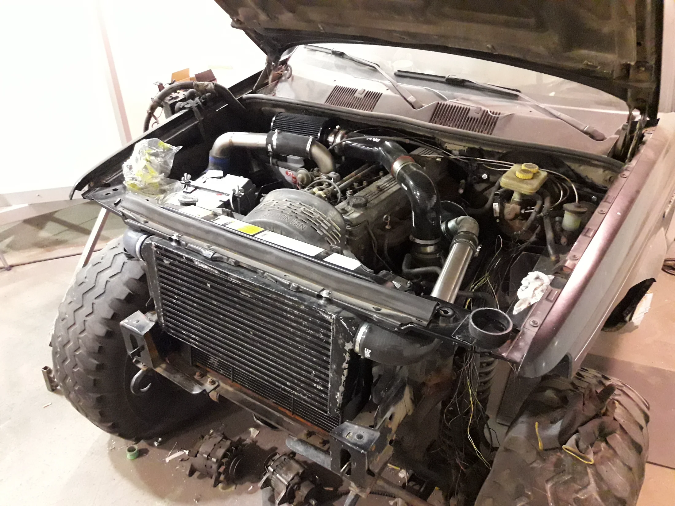

It's actually going into a Grand cherokee ZJ, basically transplanted everything from my old rusty HJ61 back in the day.
I know, sacrilege of the highest degree...

The firewall issue isn´t something I´m worries about, I would simply move the forwards and modify the driveshafts, I have chopped this truck up pretty good so I am not afraid of the sawsall :grinpimp:
I am waiting for a response from Marks down under regarding fitment, might go their way.
Very grateful you all letting me post here even if this isn´t technically a land cruiser any more, have been apart of this forum for many years and few that compare :beer:

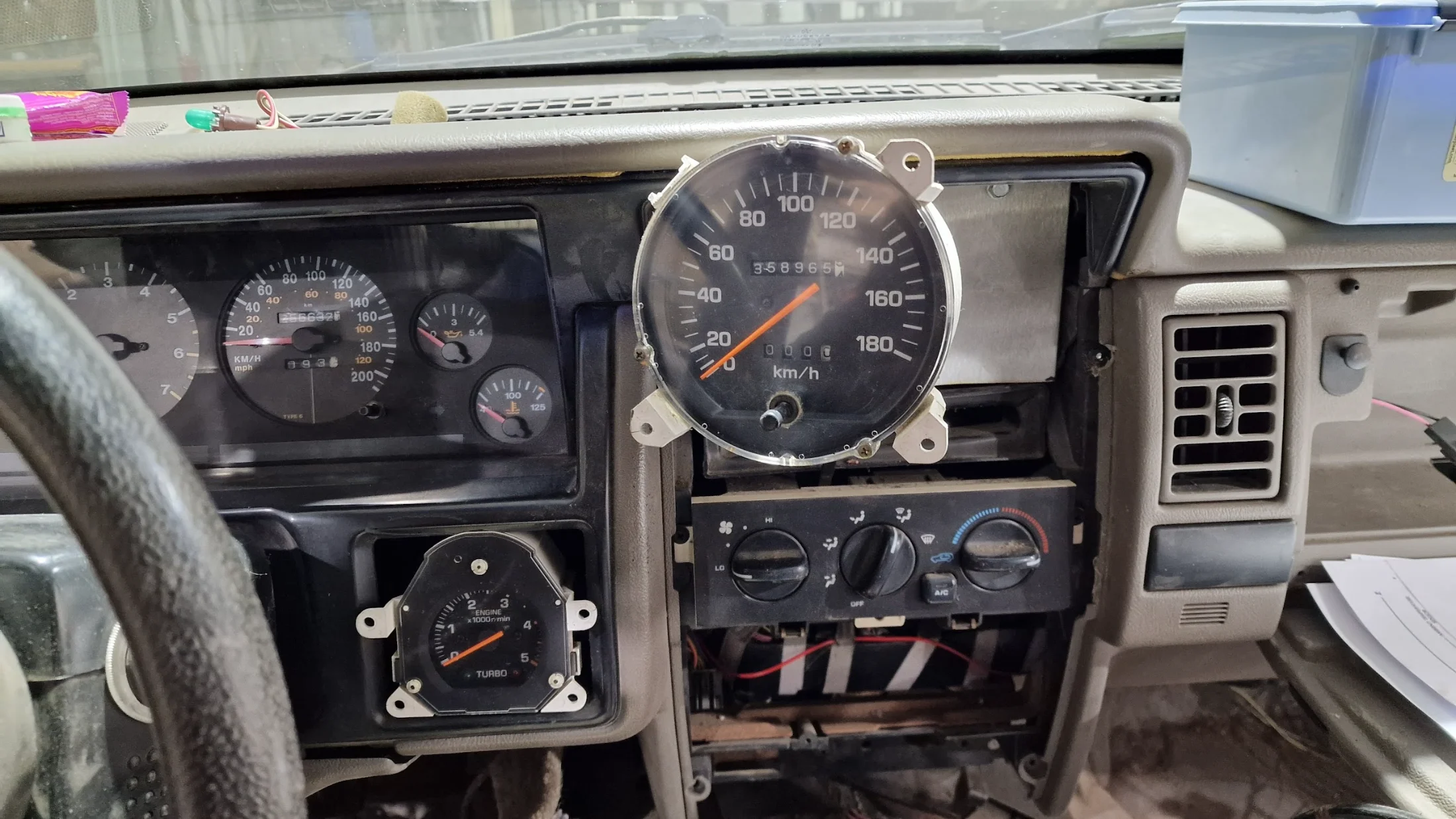

One more pic then I'll stop with the heep stuff :p
