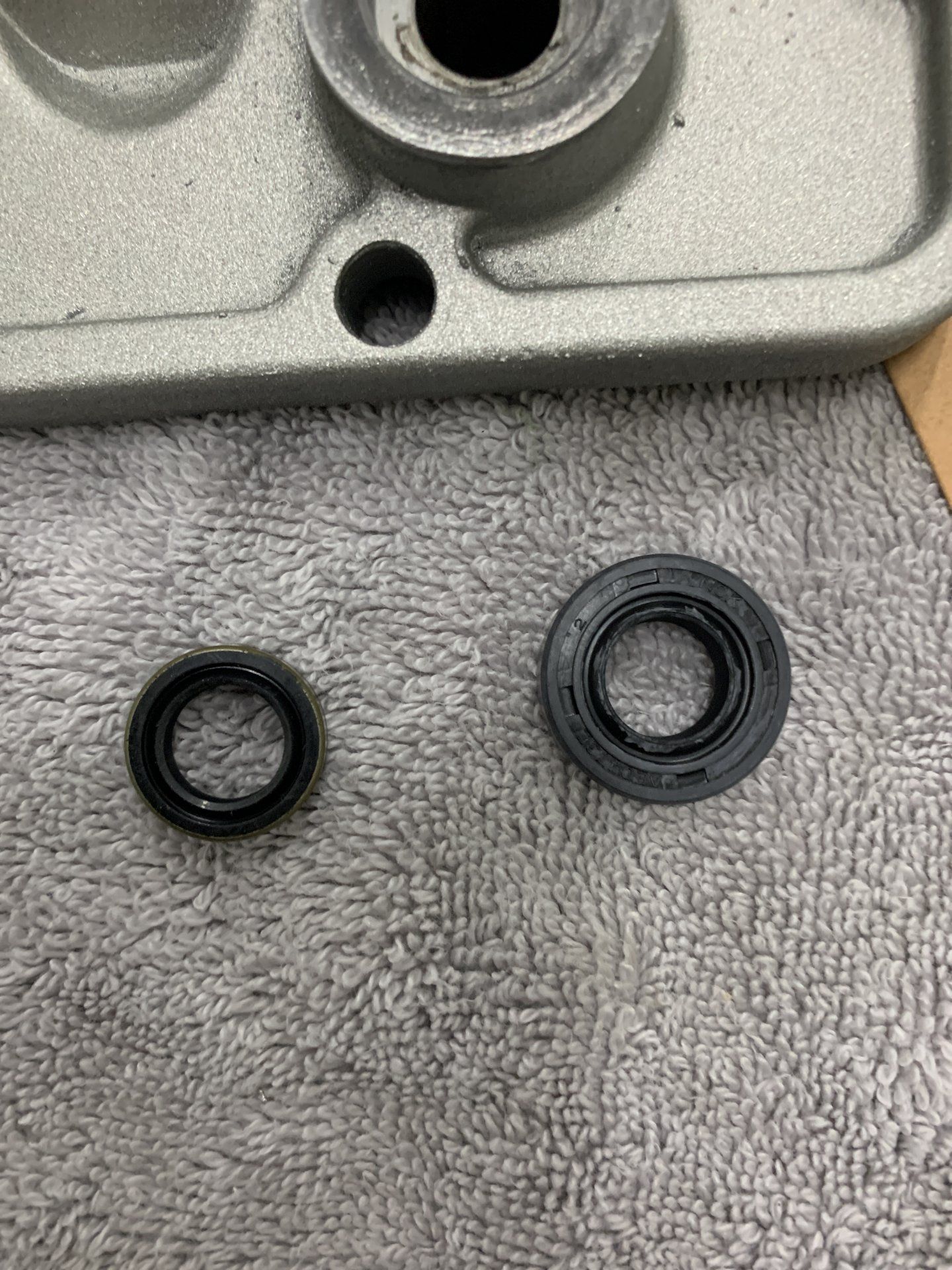

Hi all. I have two small seals for the tcase. I know the one on the left is for the hi/low lever. I cannot figure out where the other one goes. I don’t have it that I can see in any of my pictures. Anyone know? Thanks again for answering my questions.
I think you have a hi-lo shifter seal for two different versions of the transfer case. It's probably best to check with the vendor.
Thanks Todd. If that’s the case, I think I’m good, because the other one wouldn’t fit...they are different sizes.

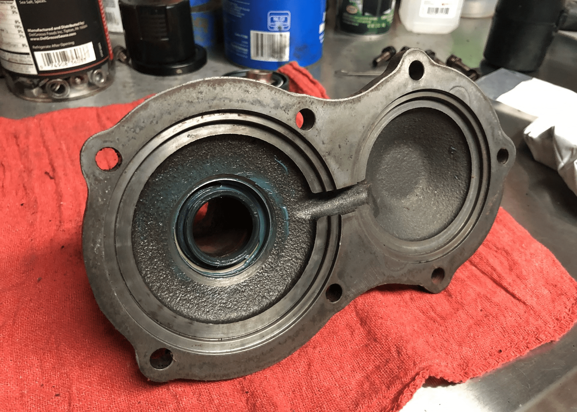

His is why the external HAS to go on the front. (stole your pic Curtice, thanks)
I'm replacing my front seal also. Did you apply grease to the outer edge or install it dry? Also what tool did you use to set it in?
Thanks much! Looks good.
