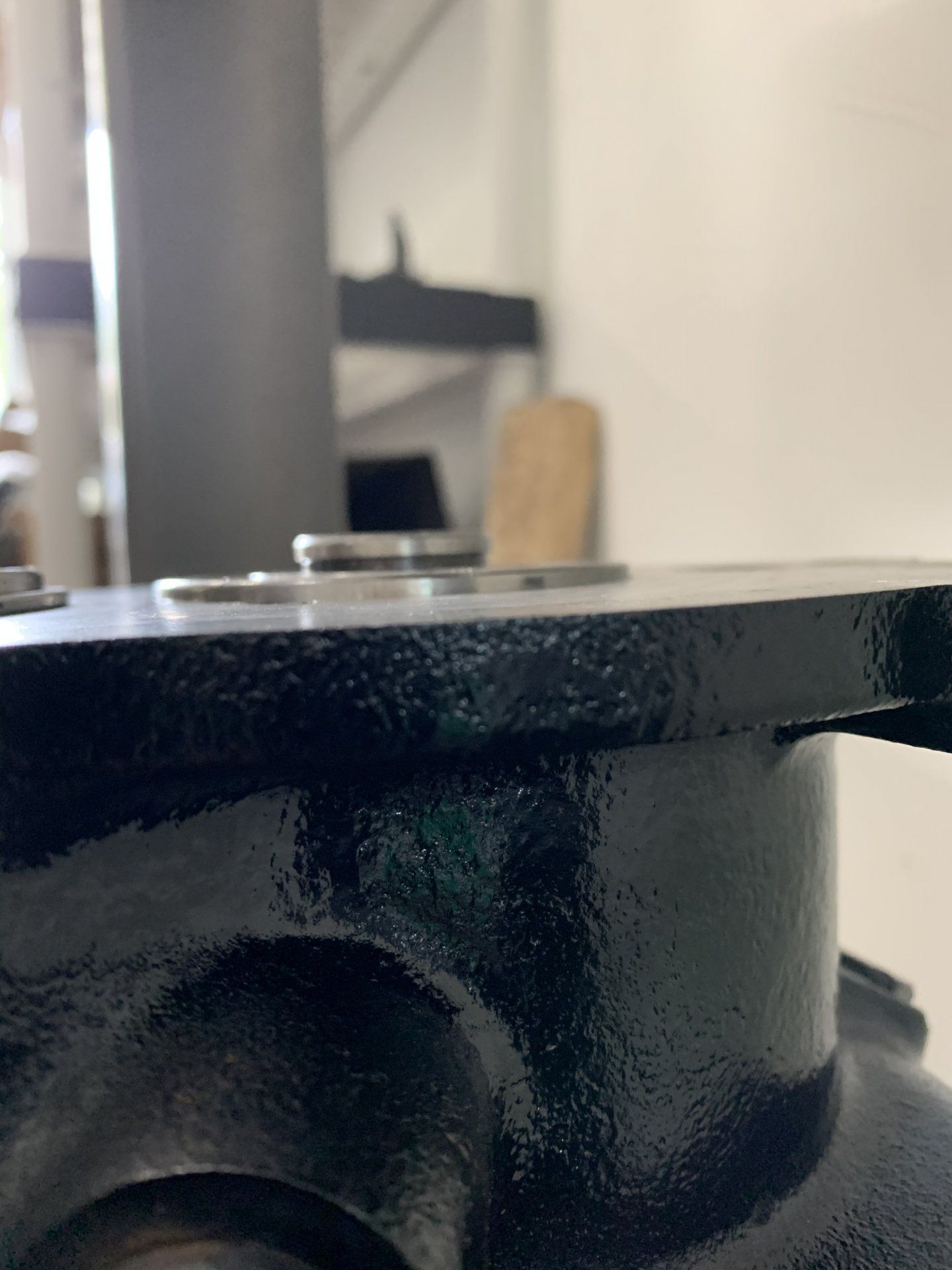

Ok, finally got to work pressing the bearings in. I think it’s all done. I got worried that my rear counter shaft bearings is not perfectly flush. But I looked at my pre disassembly video and it was like that before. Likewise seems other photos on the inter webs show it that way. Can someone confirm though?
both sides are pressed on as far as it will go and the snap rings go on.
You’re good. The front bearing retainer and the outer snap ring on the forward bearing locate the counter gear.

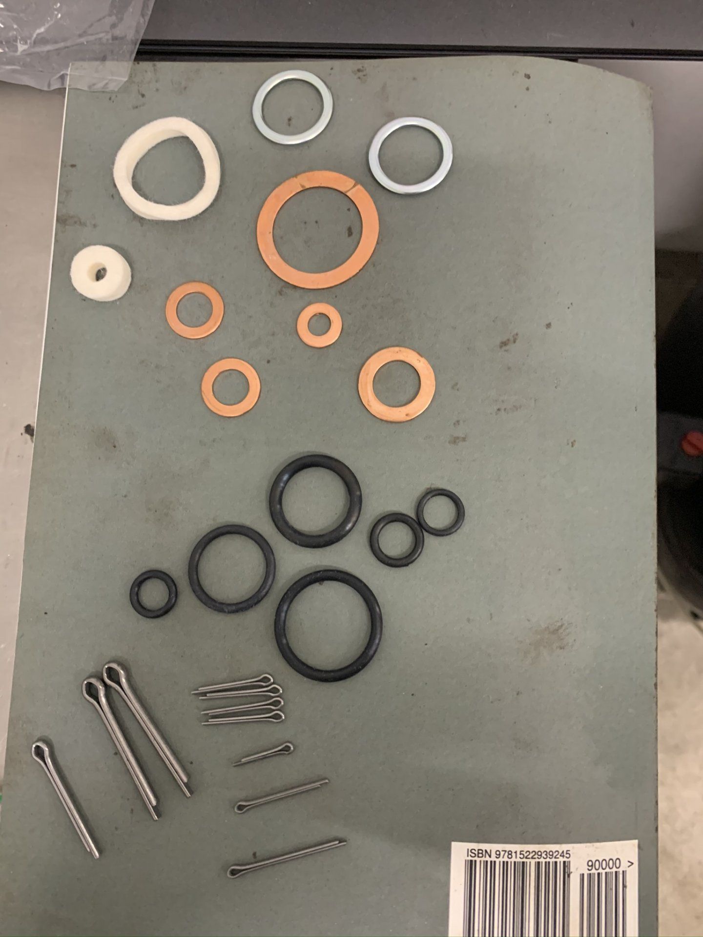

Hey all - another question. Working on assembling the transfer case. The gasket kit came with two felt pieces. I believe one goes on the speedo housing. What is the other for? Pic:
Thanks
Thanks. Just to confirm....here?
awesome thanks.
