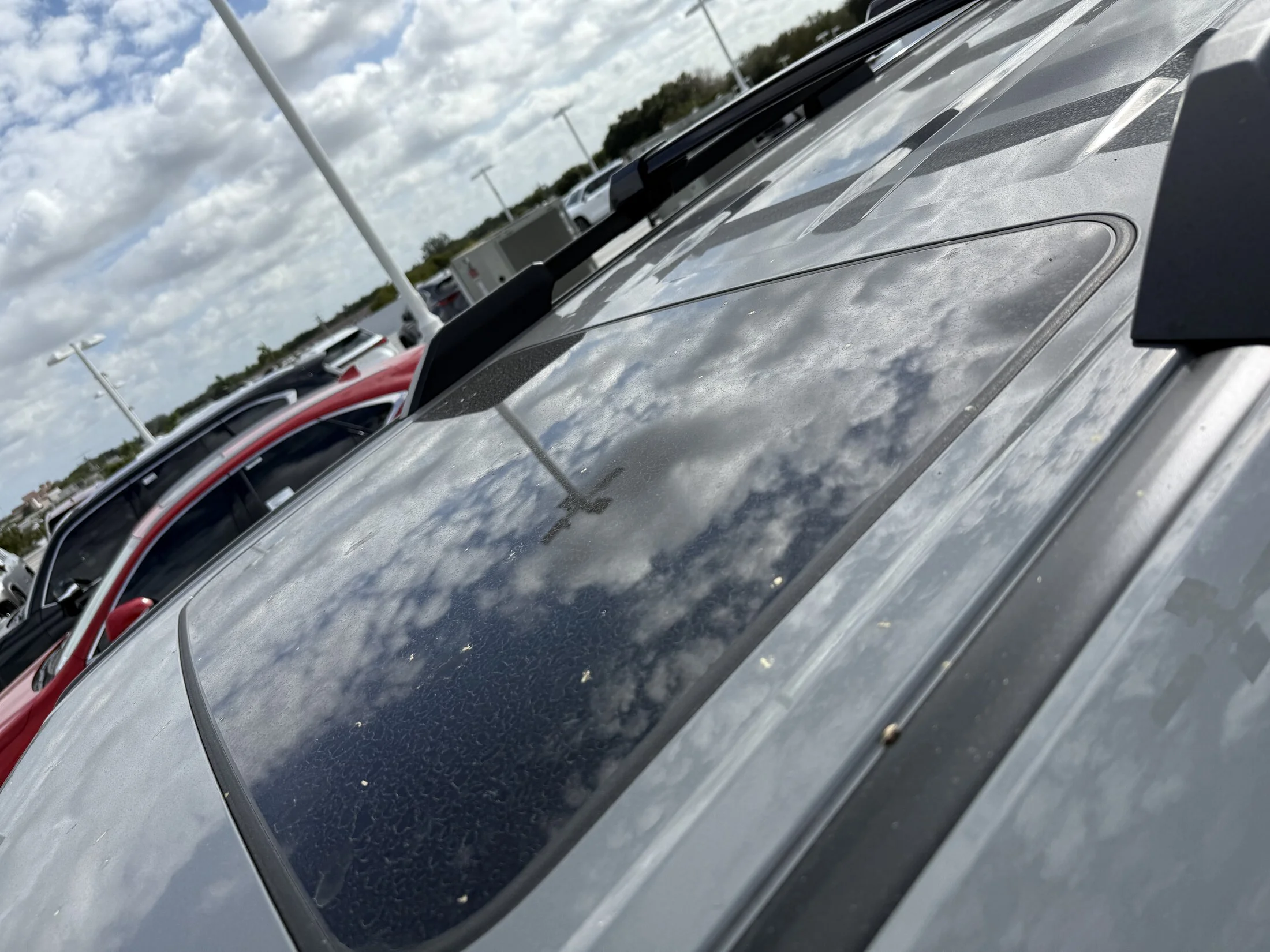

so far the cars that I’m seeing, they’re coming with it, the OT but it’s an option that you can take it out the moonroof from manufacture.
Thanks for checking current inventory. We are aware that it's an option but as you know, Toyota chooses the options, not the customers.
There were whispers from @cruiseroutfit during the summer that maybe we'd see some Moonroof Delete in the fall but that hasn't happened to my knowledge.
I'm curious if you see any Overtrail with moonroof delete out there.

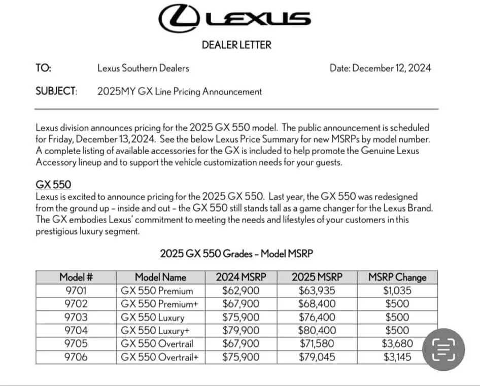

Official presser for the 2025’s is supposed to drop today. A $3k+ bump on the Overtrail trims?!? Hope they make some additions and improvements to the package for that much of an increase. This just seems to make something like a Premium Plus or a 250 LC in “Land Cruiser” trim (what a dumb trim name btw) the sweet spot for value.
Onboard air is a nice addition. Sounds like everything else remains the same. No hybrid option for ‘25. I’m curious what they mean by saying a 1” lift is now standard? Wasn’t that already the case on the OT? Seems like Premium Plus may be the sweet spot on what you get for the money.

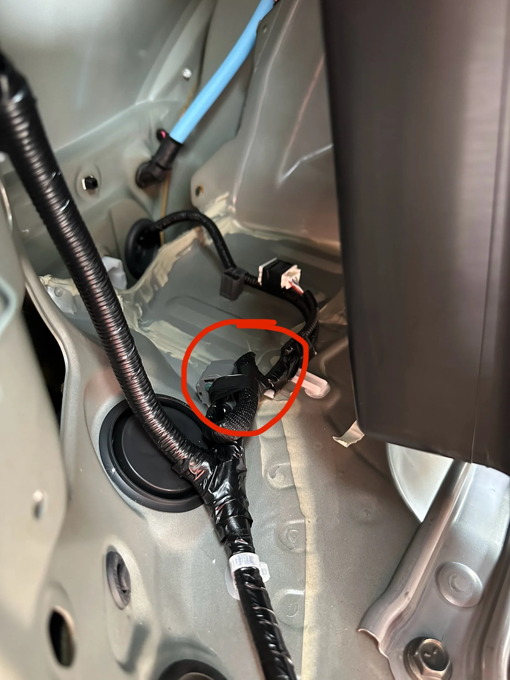

Any idea if we will be able to retrofit our 24’s with these options?
With some effort, sure. I doubt the wiring harness provisions exist on the 2024 models but I’ve not confirmed. I may add the compressor to our 24OT+ so I’ll find out. Worst case I add a harness to the battery, definitely not a deal breaker or tough task.

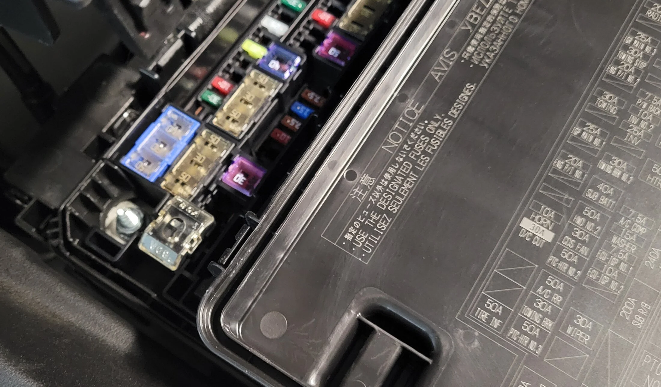

I thought there was a 50amp fuse in the fuse box for a compressor, so the wiring might be there. I'll check mine tomorrow.
@Oakleyguy wired in an arb compressor to the factory wiring.
Cool, it may be there then. Mine 30 feet away or I’d check :D
Curiosity the better of me. Ours is a very early build fwiw. Sure enough, it's there.
Odd fuse arrangement vs the diagram imo

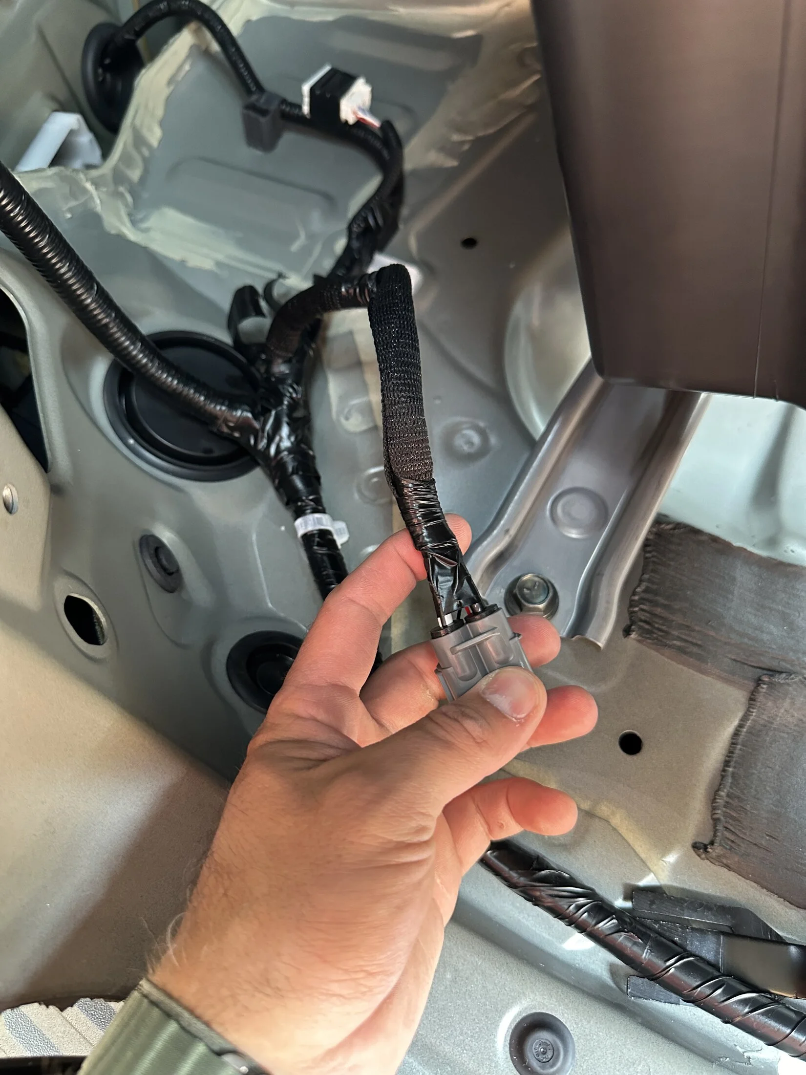

Agreed, I think the blanks on the triple fuse are utilized on the LC250 from when I was digging into this. I just pulled my drawers and compressor out of my GX in prep for the LX7; I should have of photos of the wiring harness in question. I'll post up when I have a bit more time later today.
-Nate
Heres the tire inflator harness. The heavy gauge wires are constant 12V. The small gauge wiring sees 12V with IGNITION ON.
