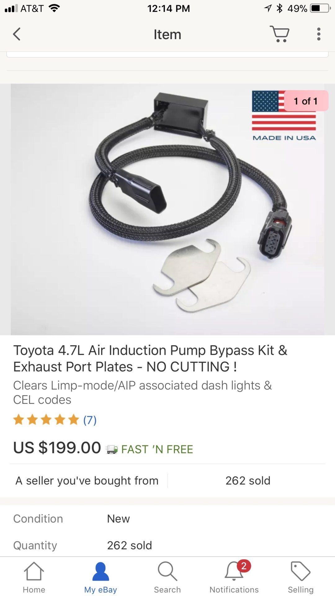

@little_joe - that’s not the one I bought. The one you linked has a couple of additional wires it seems. Hate the link didn’t work. I sent it to my wife and she could see it but eBay links tend to be flaky. I’ve attached a screen cap of it here.
It was linked from another post and has good reviews. Can you let me know your thoughts on it vs the Hewitt-Tech?
-Derek
That one looks the same as Hewitt, minus the starter relay wire. Found it on ebay and the seller doesn't make much info known. Please report back, this seems like a valid, good option.
